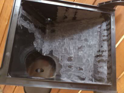

Post by Rick_RS4 » Sun Oct 09, 2011 5:10 pm
not really done much this weekend, ive been researching exhausts, and i think ive decided on what size and boxes im fitting.
i also smoothed the inside of the airbox,
this is part of the way through

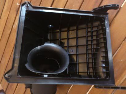

ive removed the trumpet too, not sure if its the best idea but removed it will be the best for flow. I have also blocked off the top inlet to the airbox that goes into the wing, to make it more forced (now 2 x forced feeds into the airbox.
ill do some logs soon to see if i get anymore g/s tonight.

The reason you have a trumpet is down to the way air flows over surfaces.
The design you now have can only ingest air relative to it's cross section - ie only what's in front of it.
However a rounded trumpet mounted away from the edge actually draws air from in front and behind it - ie it can get more.
The thing with na engines is that it's really really hard to screw up air intake before the airbox.
As long as the air box is of a sufficient size to slow the air down then it'll work as well as any other.
Remember that after the air box it's going to go into the intake manifold - on the rs4 this acts like a air box too with individual trumpets for each cylinder.
Air doesn't compress as easily as you'd think - if the air box starts getting pressurised then all that'll happen is the air won't go in but just spill out around the tubes.
