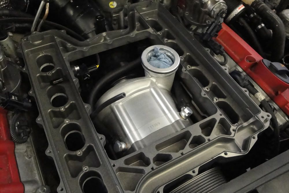

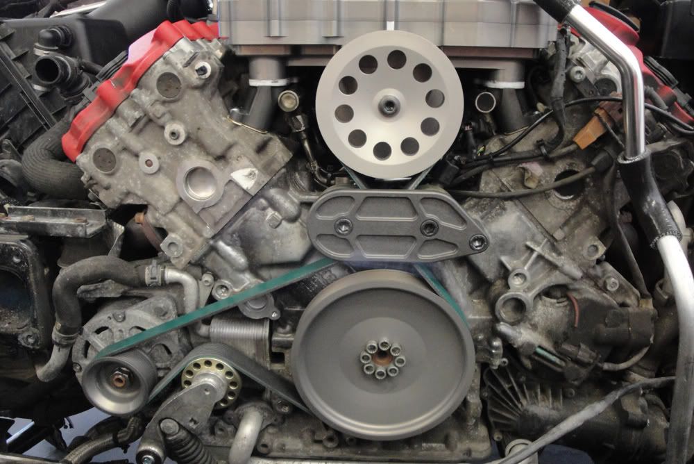

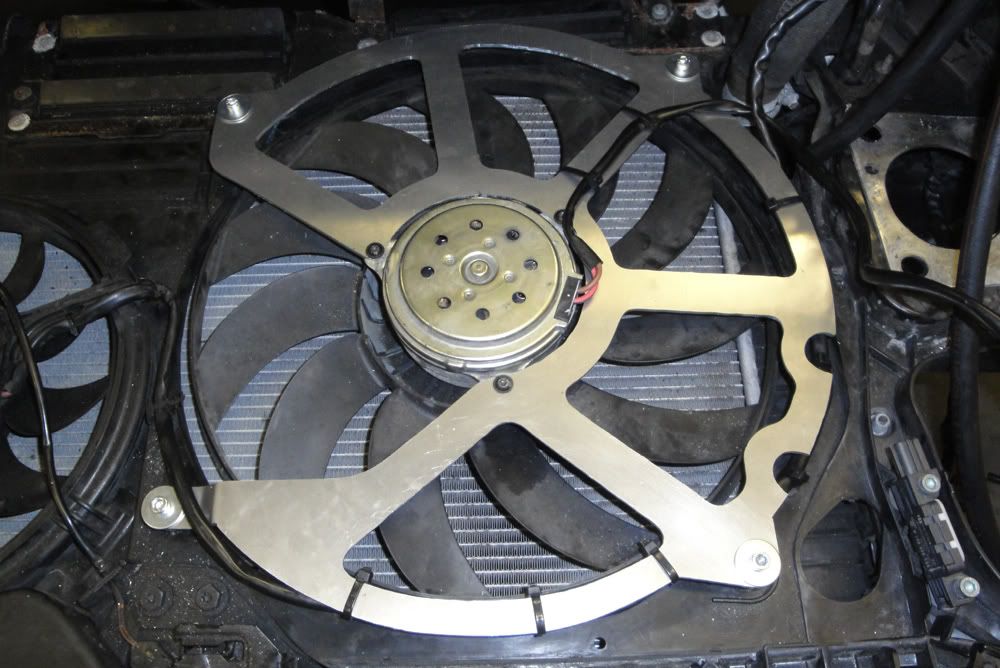

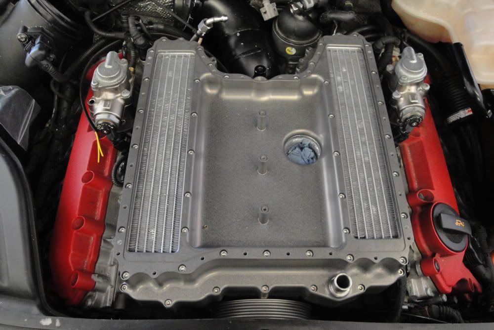

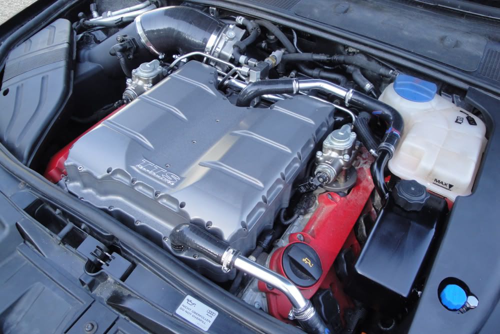

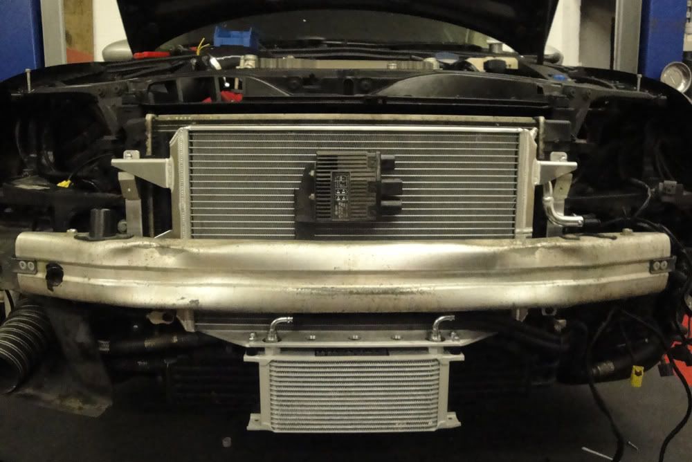

Just to give a quick update. Doug at mrc had his rs4 back last night with the prototype rs4 supercharger kit fitted. Will hopefully have some numbers in the coming days.
Just thought I would share a couple of build pics with you. (Please bear in mind that being the prototype there are some small items that are not up to production spec yet, namely the water hoses coming out of the charge cooler as these will be made in one piece for production)

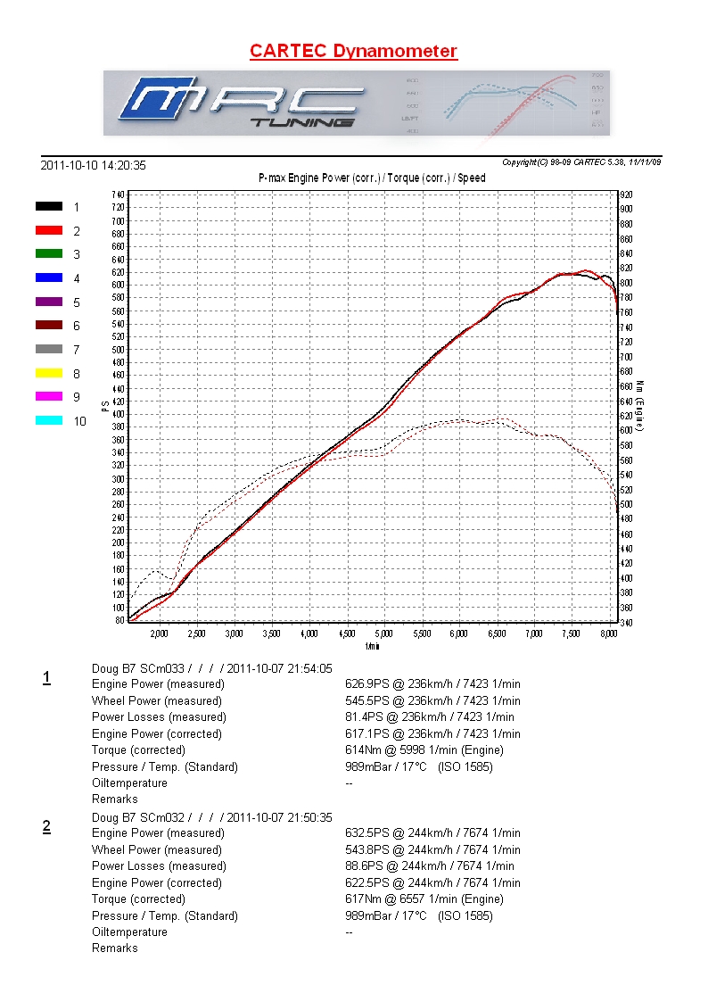

And a plot of a couple of the best runs - it does a consistant 610 run after run:

Excellent results Doug. What do you believe to be the reasons on why it doesn't produce as much Torque as the S5 you have developed, 617 vs 651? Is that just down to mapping and you are still tweaking to get more torque out of the RS4?
