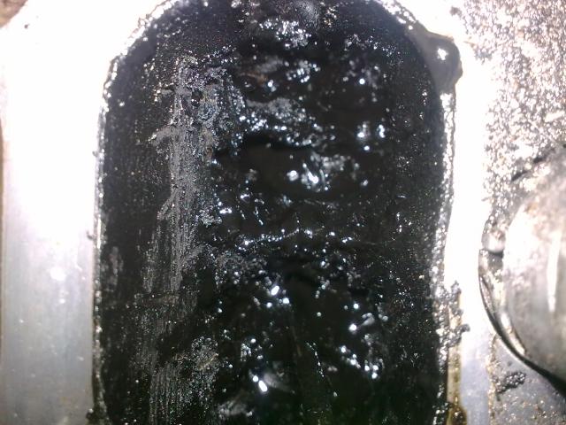

Pictures of my inlet ports....

I would have to agree about your view on the airflow restriction of the carbon deposits not being likely to cause a noticeable decrease in power up to a certain point. But it would depend on how bad the carbon buildup gets.
I would be more interested / concerned with the effects of carbon deposits causing poor seating of the inlet valves, and possibly contributing to or causing a detonation problem, with the result of timing pull. Which could, without doubt, cause a noticeable power loss.
It would be worthwhile taking a VAGCOM log of the timing correction factors and comparing pre / post clean-up of the inlets....

Well that's where the power is lost. not by physical inlet restriction.SR71 wrote:Cleaning is worth 10 degrees of timing.
Observed many times.
I will be logging the timing of my RS4 (when i get one), and making a decision on pulling the inlet based on what i see, over a range of driving conditions.
how can it affect timing?SR71 wrote:Cleaning is worth 10 degrees of timing.
it doesn't cause detonation?
it doesn't produce too much torque/traction loss?
doesn't impact throttle position or piston accel speed? ie, torque demand
timing advance only helps under certain conditions...
Carbon deposits can cause pre-ignition. If the pre-ignition is enough to cause knocking then it will pull the timing back.
Detonation / pre-ignition / knocking, what ever you want to call it, can be caused by a lot of factors, but anything that can cause a hot spot in or near the combustion chamber can be a real problem. Even running a cooler grade spark plug on turbo engines is enough to allow the timing to be advanced more.
I would image that the pre-ignition is a mixture of carbon deposits entering the bore, and the flame front meeting a poorly seated valve with carbon buildup.

Hey guys,
I thought I'd chime in here.
Short story for those they don't know, I took my car to Audi for what felt like low power. The car began to ping, then starting pinging bad after a few months (all the while Audi trying to find the problem). A log file was sent to Germany who said the Air Volume was lower than expected (yes I had the fuel additive too). Timing was also around 9-13 degrees. Anyway, the intake was removed and valves cleaned (short story again was they were worse than this):
They were then cleaned and the car was powerful (for a while anyway, then MAF Fault, then Intake Runner, and pinging coming back).
The manifold was then replaced. What we found when it was removed was this (notice the chuck of carbon that has fallen off, this was shiney when I first saw it, but it's dull in this picture as it was taken two days later)
The pinging I experianced (probably due to carbon, and confirmed by Audi Australia as the likely cause) made my piston look like this (you'll see in the video that the first piston is from an RS4 that has carbon but doesn't yet ping, you'll then see mine). I was going crazy at Audi to fix it, all the while saying it wouldn't cause damage - yet to be confirmed)
