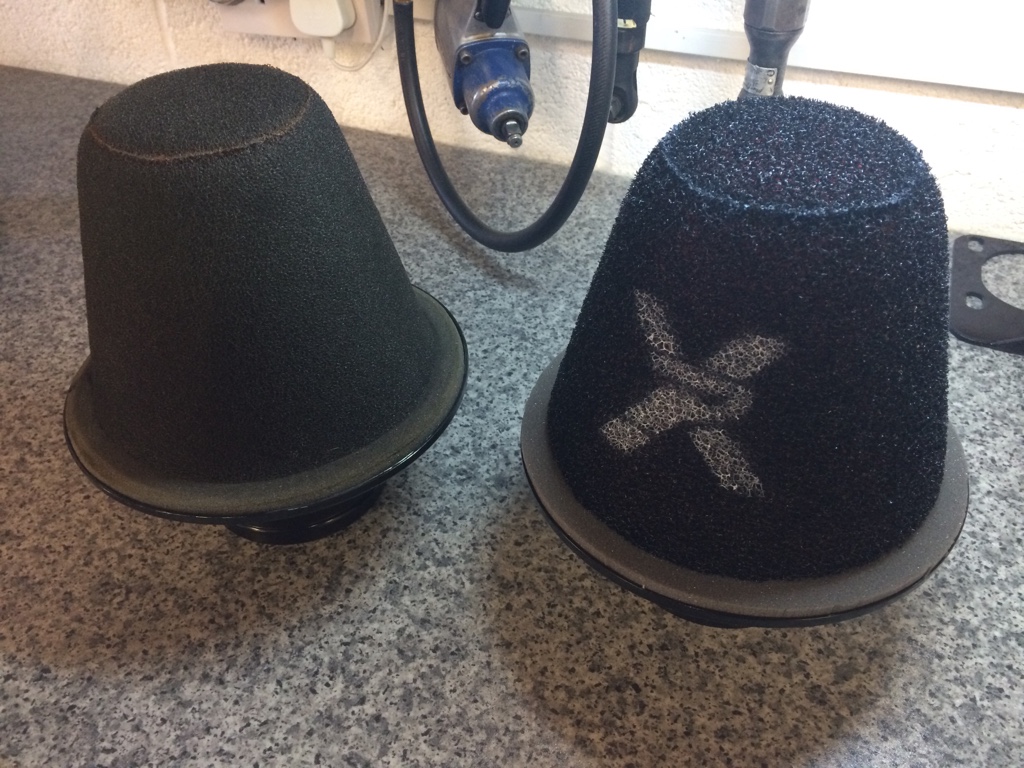

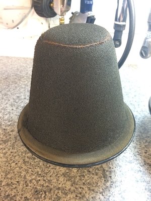

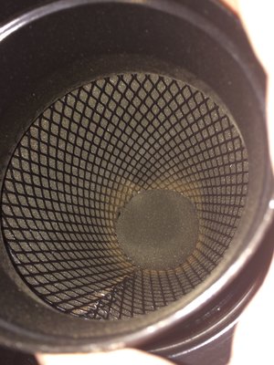

Okay. Old style filter:
The inner foam still bothers me a lot - looks really fine and when rubbed flakes away.

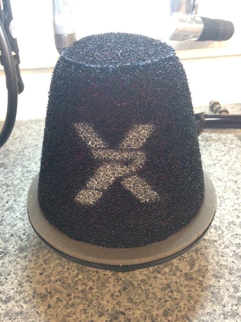

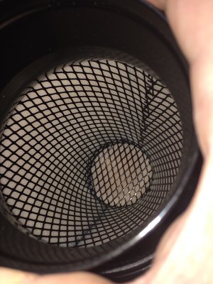

New filter:
Interior foam is smooth. Also appears to be three layers/types of foam instead of the older filter which looks to have just to layers.
Interior in my intake was dusty as I feared. Cleaned up as best I can and new filter fitted. :)
Edit: tapatalk appears to have muddled up the photo order - I'll fix it when at my laptop next. Easy enough to figure out which is new/old :)
