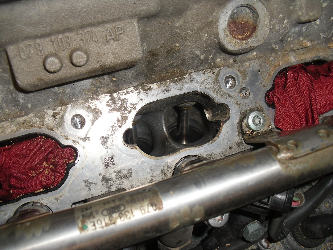

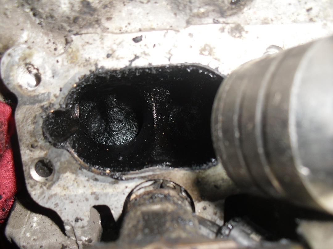

Before
After

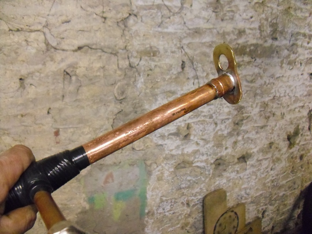

Vacuum attachment made from copper tube.
