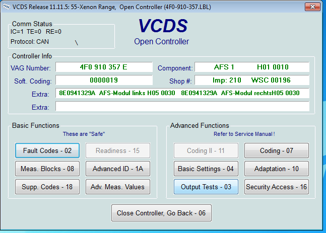

What I also said in a PM to scaghead...'R'e'S'pect_4 wrote:the control unit part No.s would need to be checked.
On VCDS the control units show up with "AFS" in the description, so I reckon they would need changing too.

Scaghead......
Ballast/control module under headlight unit
VCDS reading of Xenons

I have a receipt for my car stating ballasts were replaced (06 car, 09 dated ballast) 8E0 941 329 A which ETKA says superseded and replaced by 8P0 907 391 for adaptive, non-adaptive is listed as 8E0 907 391 B
4F0 910 357 E - refers to range control module (one behind dash/in boot ? ) ADAPTIVE (now listed as 4L0 907 357), 8P0 907 357 H for non adpative.
At a guess both need replacing ??

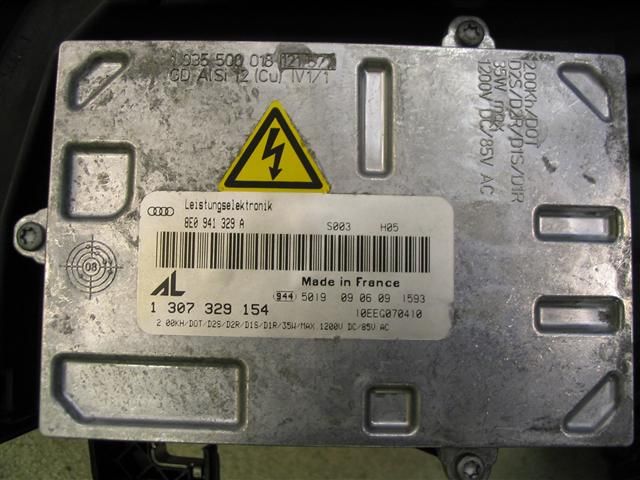

Ok, so I managed to get the new OEM headlights fitted on Saturday. I can confirm that all the bulb holders are present in the lamp housing so it's simply a case of swapping over the xenon ballast unit and xenon bulb from the old unit (2 minute job). I also transferred my bulbs as I have PIAA DRLs.

Close-ups of the ballast unit (non-AFS) with part numbers etc:

interesting, your ballasts dont seem to have an Audi part No. ??
Can't find anything on Elsaweb about it.
Yeh, it looks like the ballasts are OEM, maybe the originals were replaced at some point.
