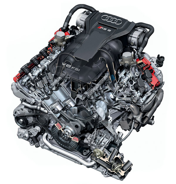

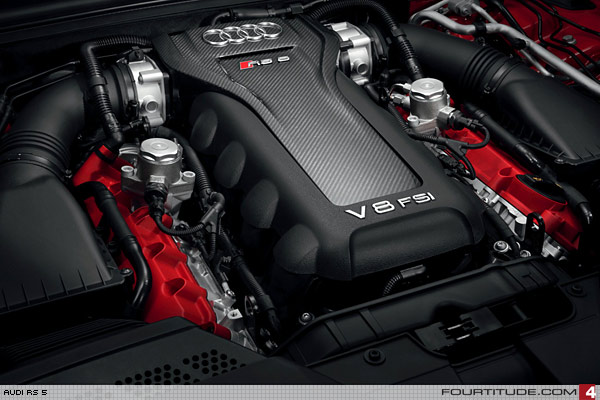

I also find it interesting that the discussion around the RS5 is more air allows it the make more power up top. I bet carboned (excessive) buildup takes the power away at the top too.
As some claim, if air flow restriction isn't going to impact power, why bother with dual throttle bodies. I suspect the RS4 engine needs all the air it can get above 6000rpm to make the 420hp!
The design of the RS5 allows it to and two 70mm bodies is better than one 90mm body? The RS5 engine bay and layout is far less compact than that of the RS4 and perhaps it was the amount of air available to the RS4 engine that determined they only needed a 90mm throttle body. Now the RS5 has more capacity for airflow into the engine two throttle bodies are needed. Who nows...except Audi engineers of course.
And are you talking about air flow restriction in terms of actual air available to pass through the engine or restriction in terms of carbon build up More air flow through an engine surely would always be a good idea and perhaps all carbonisation may do is build up pressure in the airflow that would mean the same amount of air flows into the cylinders compared to that of a clean manifold?

carbon...a couple of % decrease, MAYBE, if any...2manytoys wrote:I also find it interesting that the discussion around the RS5 is more air allows it the make more power up top. I bet carboned (excessive) buildup takes the power away at the top too.
2 TB's a 100% increase
see the difference? and why one would impact and the other wouldn't?
order of magnitude of difference 50 times
as I said before, the TB's are the limiting factor, NOT the valave inlet area...so occlusion there will have little, if any, impact, IMO
they do this to rev the engine high, 'pump' more air, the engine rev'ing higher makes the power, not more air per se, but you need the air when you rev higher...chicken and egg thing...
At a given rpm, for a given engine, whether or not you can increase power will depend on what you can do volumetric efficiency.
If you can raise it 7%, you'll get 7% more power.
Likewise, if you can supply more air to make it sensible to rev to 7% higher, you'll get 7% more power.
The problem with the RS4 is that beyond 7800rpm, the mass flow rate through the engine starts to reduce with the commensurate effects on power. No point except, like Arthur says, for top speed.
The RS5 solution is dual 70mm TB's which are not restrictive at >7800rpm.
Having established that at 7800rpm the RS4 inlet is "maxed out", it seems self-evident to me that if you place further restrictions in the inlet....
Likewise, though, it seems quite plausible to me, that fitting dual 70mm TB's to a RS4 would make absolute sense if you wanted to rev your motor to 8300+rpm because it would quite happily breath the requisite amount of air to make additional power....all other things being equal.
I'd be first in line for a dual 70mm TB retrofit if it ever became an option.
Like you say though, its hard to see how it could ever fit in.

Think about the cross sectional are of 2 70mm diameter bodies versus one 90mm...P_G wrote:The design of the RS5 allows it to and two 70mm bodies is better than one 90mm body?
2 x 70mm diameter = 30,787 sq mm
1 x 90mm diameter = 25,447 sq mm
So the RS5 throttle bodies have 20% more area than the RS4 throttle body, which means more air can get into the engine.
so the velocity is 20% less (Q = V x A)
and so if the velocity in the 70's is 80% (0.80 times as much) as that in the single 90
the pressure drop will by only ~64% as much (DP ~ (V70/V90)^2 ~ 0.8^2)
a lot less...which will reduce pumping losses a bit, increase vol eff, and gain a few ponies...primarily the difference between:
8300/7800 x 420 ~ 447 HP and the 450 rating, ~ 3 HP
