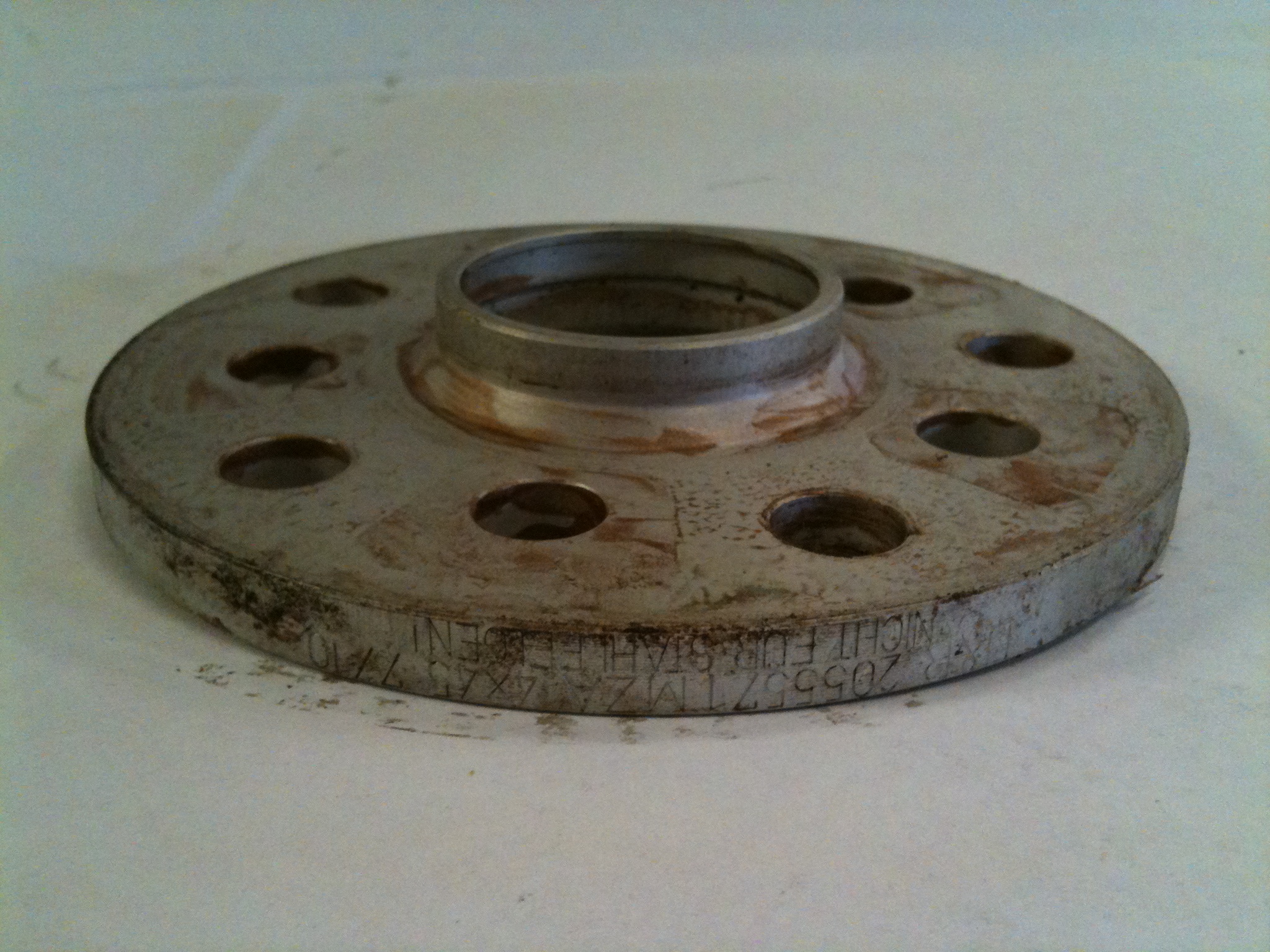

can anybody who has any H&R spacers (especially 10mm) on their car look at and post the full part number?
thnx
nij
Posts: 541
Joined: Tue Sep 14, 2010 3:44 pm
Location: Newcastle
Re: HELP with spacers pls
Post by nij » Tue May 08, 2012 1:32 pm
ArthurPE wrote:can anybody who has any H&R spacers (especially 10mm) on their car look at and post the full part number?
thnx
I had these 10mm H&R spacers on my car and I never had any problems with them (150mm face hubcentrics).
The marking on the side:- H&R 2055571 MZA 4x45 7/10. I can see sonny's is 202555712 MZA ??? What's the difference?

Post by ArthurPE » Tue May 08, 2012 4:54 pm
it's confusing as heck
I have an emal into HR germany
I measured my oem wheels and the bevel is 7 x 7 (base x height) which is 7 x 45 deg
I'll check again and may pull a wheel to measure the hub bevel and the spacer inside and outside bevels

Scottie, Thats the same part number mine have on them, (rears) I take it yours fitted with no problems, It was only about 1mm from fitting flush against the hub and you had to look hard to see they did not quite go fully home,

I've just picked up the following and been assured they are correct. I'm at MRC for healthcheck/inspection tomorrow and plan to get these fitted so will let you know if all OK.
Rear 10mm - on the box 2055571A (on the spacer H&R 2055571 MZA 6,5x45 01/12 D)
Front 8mm - on the box 1655572 (on the spacer H&R 1655572 MZA 7x45 11/11 D)
MB2
Posts: 1575
Post by MB2 » Tue May 08, 2012 8:07 pm
Well lets see if I can add to the confusion...
Rear (10mm)
Box - 2055571B
Spacer - 2055571 MZA 4x45 3/10
Front (8mm)
Box - 1655572
Spacer - 1655572 MZA 7x45 10/10
Both boxes also have the following writing on them - "Nur fur felgen mit Innenfase mind 4x45" or "Nur fur felgen mit Innenfase mind 7x45" which seems to be relating to the bevel angle.
So unless we have different pitches front & rear at least one of my sets is wrong, although I have fitted and removed them several times and fit seemed perfect, although come to think of it there should also be a problem with the fit to the wheels as presumably both bevels are made at the same angle ?
Would be interesting to hear what HR have to say about the bevel angles and our cars.

Well have just had a look at a spare wheel, and the depth where the bevel locates is 5mm so I would say a 5mm bevel is the correct fit. Of course a longer bevel would just protrude through the wheel so wouldn't be a problem there, however the hub fit would be off. My guess is the 4mm bevels I have on the rear are not quite seated correctly although guess would have to measure the hub to be certain and work out the consequences.
I was measuring with a steel rule so it is hard to be certain but looking at the fit as well as the ruler I am pretty sure 5mm is spot on. Arthur did you measure the wheel itself as you measured 7mm, but I have only got 5 mm so maybe I am wrong ?
Edit - just realised I was measuring the height of the alignment ring not the bevel itself - I make the bevel inside the wheel 11mm.
