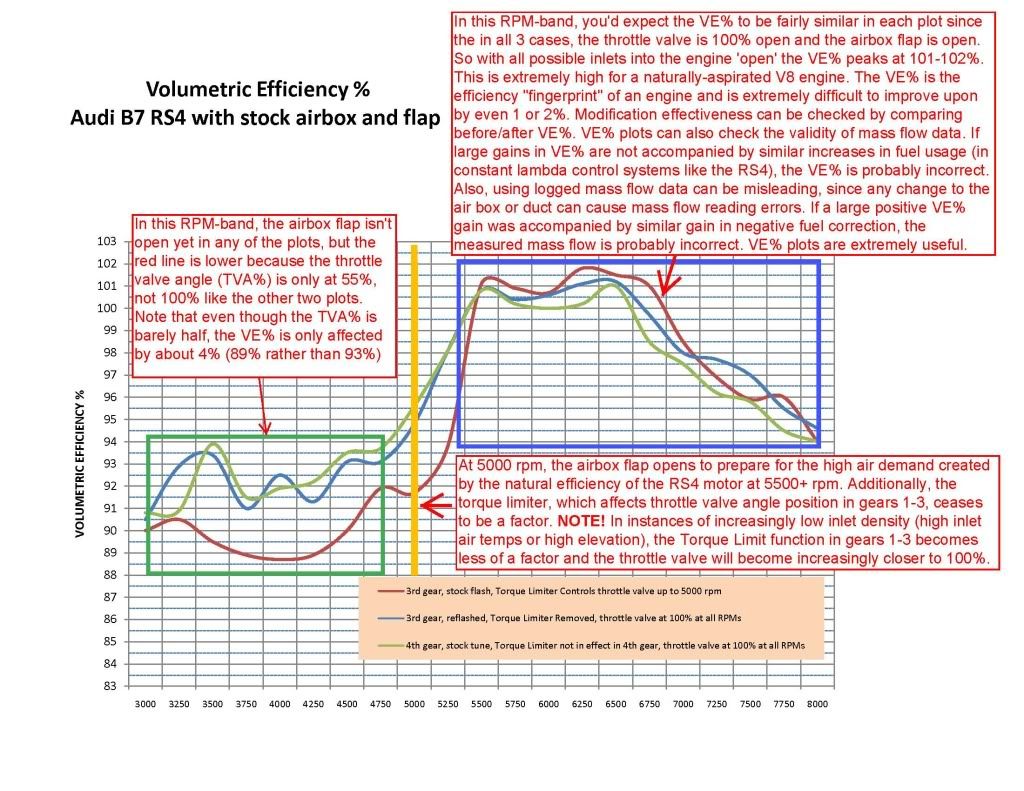

to add to the debate I think the 317 lb ft is the max torque this engine can produce, I don't think it is limited
using Vagcom maf mass numbers vs theoretical swept volume the vol eff is 1.02 or so, very good for a na engine
T = (Cr x vol eff) x displacement / 4Pi = (12.5 x 14.7 lb/in^2 x 1.02) x 256 in^3 / 4Pi ~ 3818 lb in = 318 lb ft
I do not think the engine is capable of making more than this, and it does make this below 5000 rpm, ie, at 50% throttle, so 100% would not yield more
the only way to get more: higher Cr or improved vol eff (difficult to do on a highly developed engine) or by super/turbo charging

ArthurPE wrote:to add to the debate I think the 317 lb ft is the max torque this engine can produce, I don't think it is limited
using vagcom maf mass numbers vs theoretical swept volume the vol eff is 1.02 or so, very good for a na engine
how realistic is 1.02 for a stock engine though? Having spent some time looking at stock exhaust (this car, other cars) I can promise there's some inefficiency there, much of which is to satisfy noise and emissions levels.

Here's something interesting he posted up
This was also interesting...check the 'actual torque' which we can log on vagcom. Difference between 'actual torque' logged on the dyno (GREEN) during a pull vs.actual torque logged on the highway (BLUE) excellent IAT in fourth gear is huge.

Post by ArthurPE » Tue Mar 27, 2012 3:59 pm
how was the vol eff calculated?
can you set up an excel spreadsheet
col 1 rpm
col 2 calculated mass air flow from rpm, displacement and an air density using temp, humid, atm P ~ the same as the following Vagcom run
col 3 actual Vagcom measure mass air flow
col 4 = col 3 / col 4 in %
I have this at home, want to compare
edit: just did it using saki's data from this post, now to figure out how to post it
