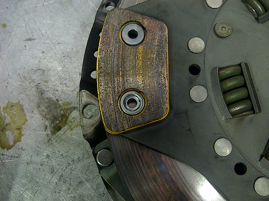

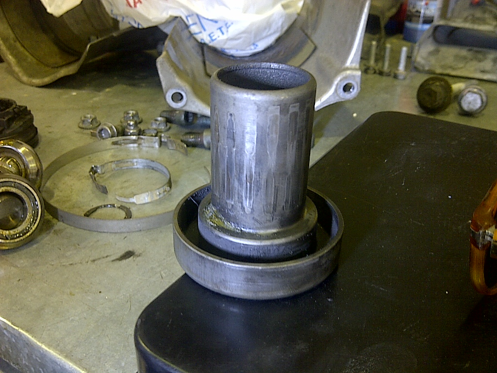

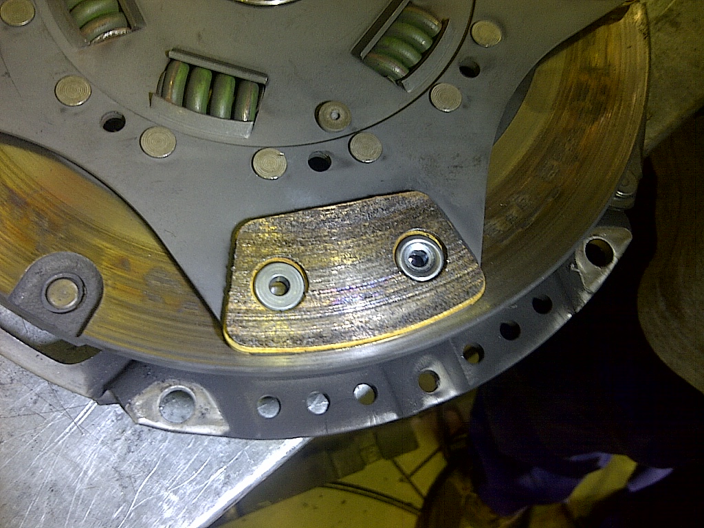

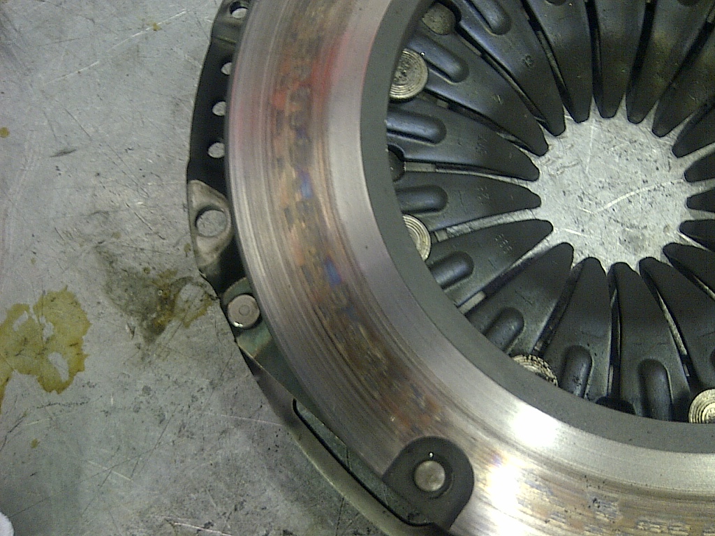

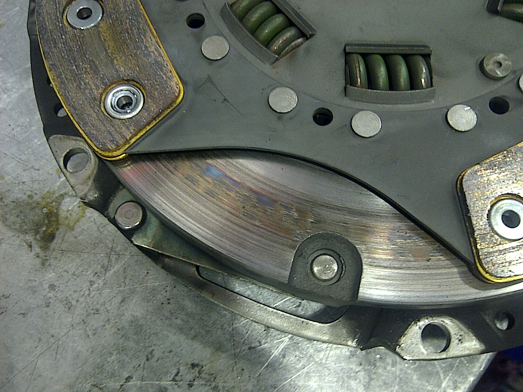

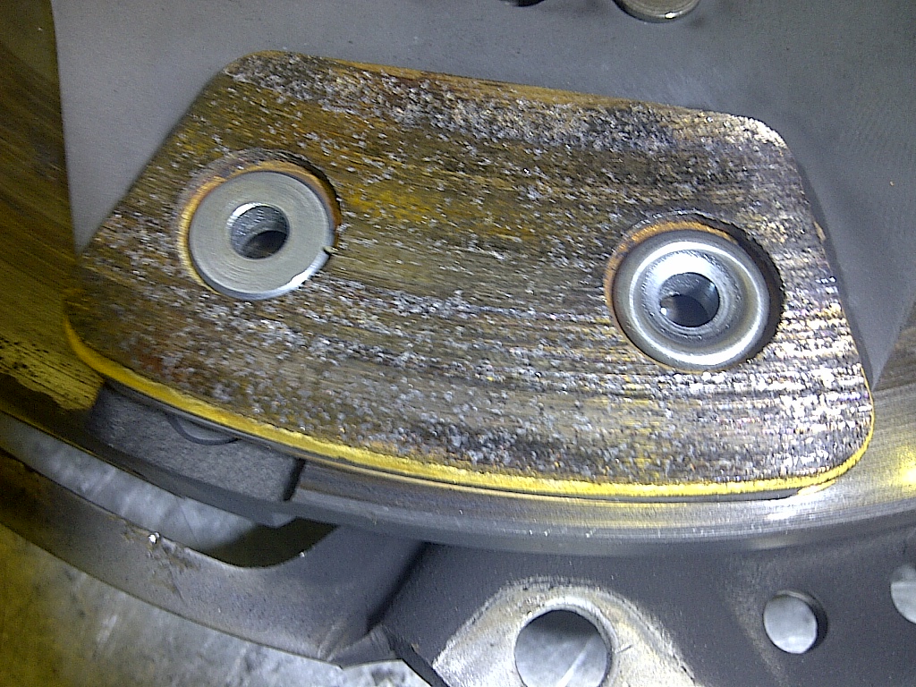

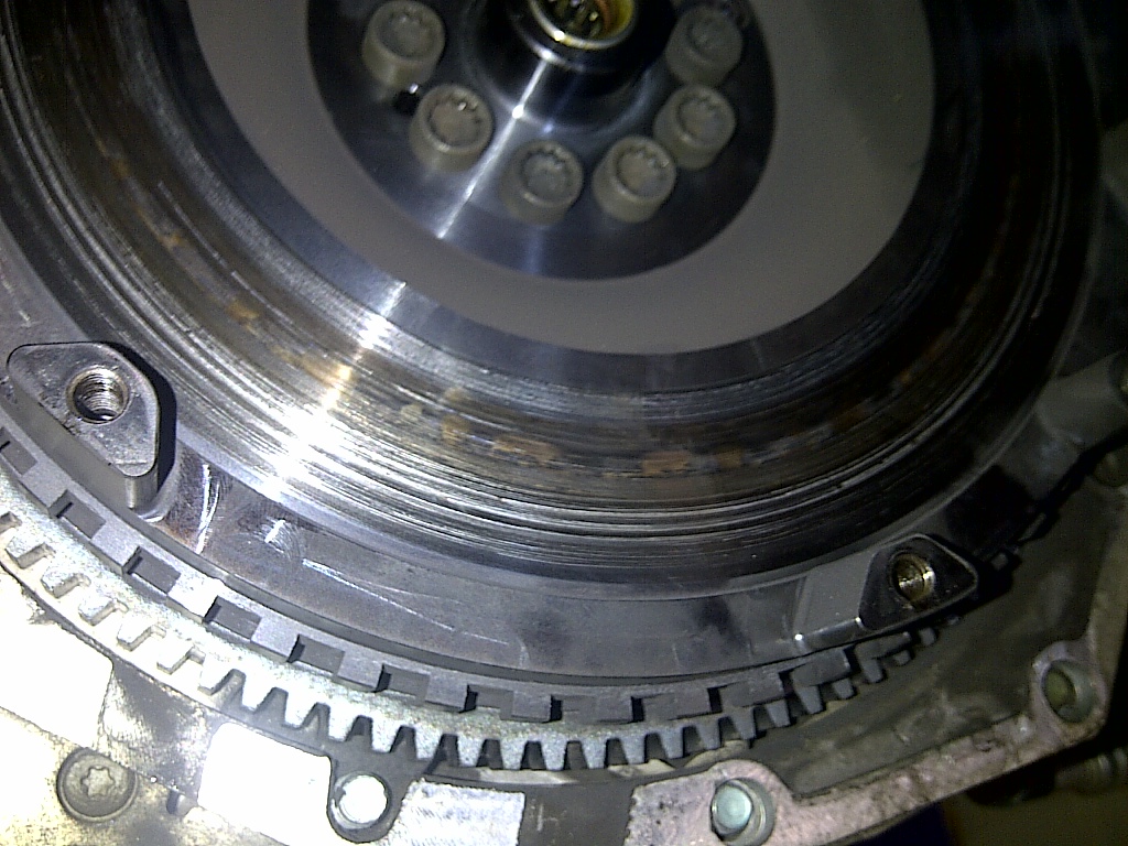

Ok guys, I just visited the workshop this morning that has taken apart the clutch. Below you can see pics of the clutch, flywheel and pressure plates.
The LOBA Sachs stage 2 has been installed and driven for about 2.5km roughly. As you can see aside from burn marks on the clutch and pressure plate, there are grooves on the clutch!
Correct me please if I am wrong but this is not normal for a 2.5k driven distance, with no launching!
Anyways as regards the vacuum system there were no apparent leaks, but just to be safe everything will be replaced by Audi OEM parts again. The guide sleeve too is going to be replaced, although it seems ok.
In any case, the technician at the workshop was surprised by the looks of the clutch and the pressure plate.
Truth be told, I have just also contacted LOBA in Germany and waiting fro their feedback.
Any thoughts are much appreciated.

Re: Quest for the Wholy Grail (Answers to "Sticky" Clutch is
that looks to me very much like a slipping clutch.
Problem is why...
Could it be that when the pedal is stuck it causes the clutch to slip?
Problem is why...

Changing everything out again is just going to end up with the same result surely?irishmike wrote:Is the clutch level with the brake pedal?
Mine wasn't by a slight bit and one of the Audi Techs said my pedal itself was broken up somewhere in the pedal box.
The explained the first part of "Free" travel before I felt resistance.
It might not be the same as mine, but worth getting it checked. Audi said that because of this free travel the clutch wasn't engaging/disengaging fully, which lead to sticky clutch and ultimately fubared the clutch.
And you said yourself you had a light feeling at the start of the pedal stroke? And that your clutch pedal is not at the same height as the brake?
Regardless of what the mechanic has said, surely it needs to be changed out if only to rule it out?
Personally I would replace the clutch pedal assembly like Irishmike did in the above post keeping everything else as it is.
The clutch and flywheel is not pretty but plenty of material left and it will certainly last long enough for fault finding purposes.
If you find the new clutch pedal fixes the problem you can either run the second clutch until it dies or replace with a new one.

Thanks guys for the advice. Since everything is being replaced, I will replace the pedal assembly too.
As regards the scratches and grooves in the LOBA clutch and pressure plate, I got to say that they guys in Germany were very helpful to answer my questions. The thickness of my clutch disc is 8-8.1mm at the puks and the mint new is 8.3mm. The difference after 2.5k km is most likely my fault as i did not leave it to bed in for about 1000km as per the LOBA technician's guidelines earlier. IN any case , there does not seem to be a problem in this to put it back in.
