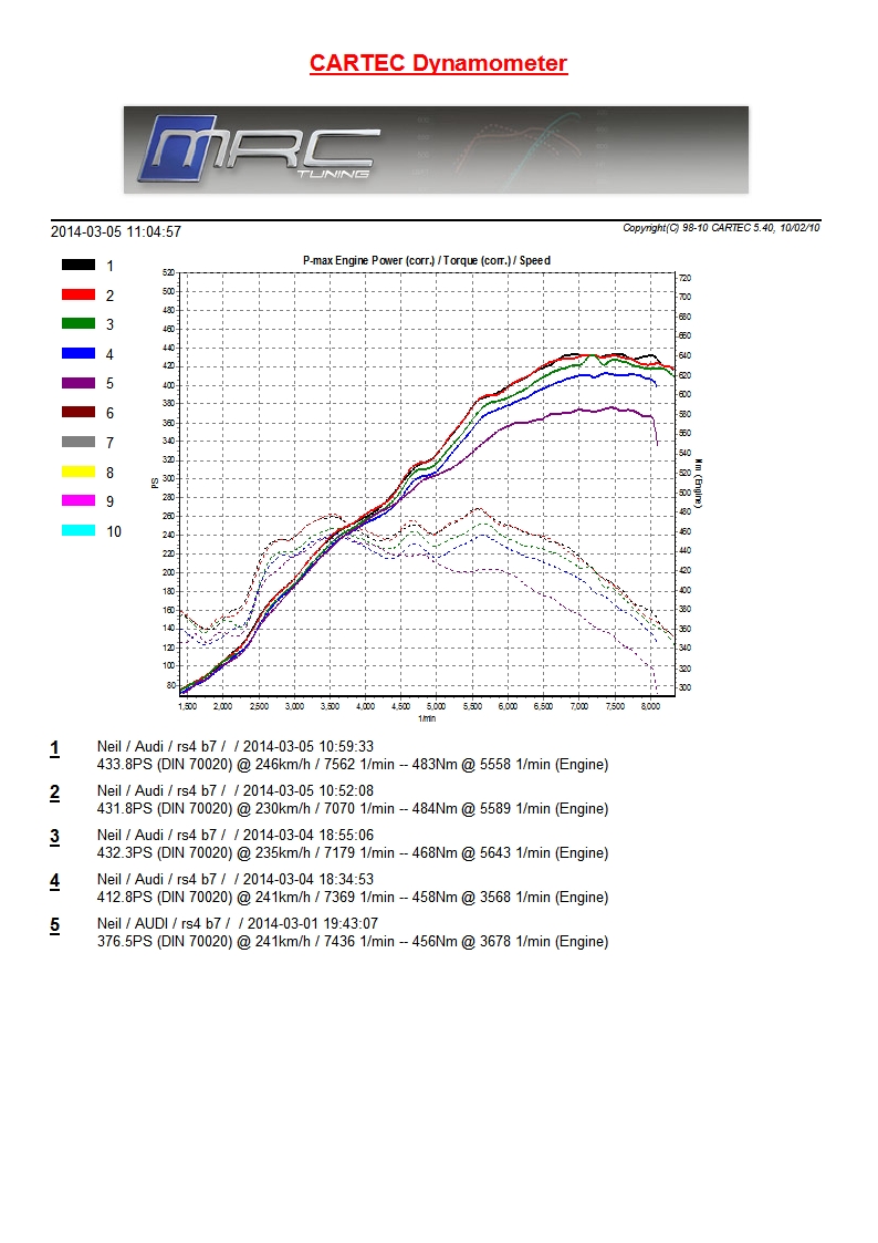

Ok, the figures are now in and Doug has made a few fuel experiments between Shell V Power Nitro + and Tesco99. Dyno'd on Shell then rinsed and Tesco99 after tweaking and final adjustment. The difference is purely down to 98 vs 99 RON
Shell V Power Nitro +: 432.3 and 468NM
Tesco99: 433.8 and 483NM

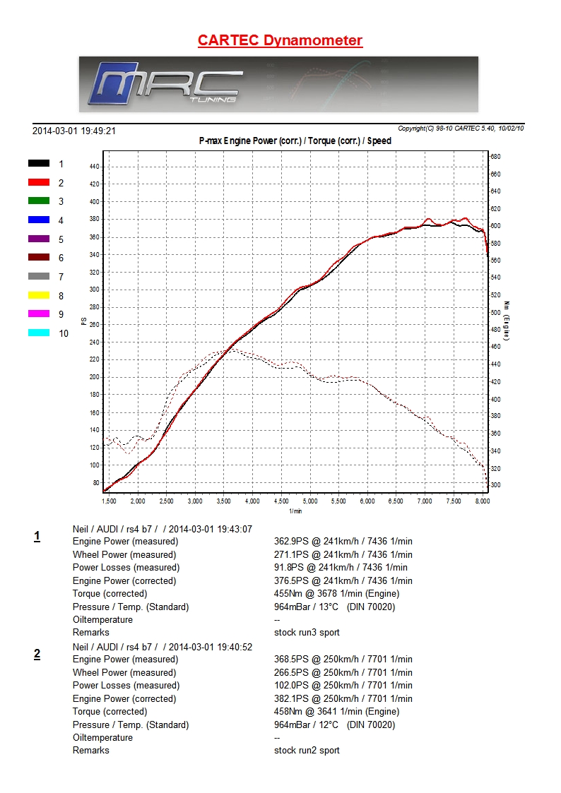

Do you have the before and after dyno plots.. That'll give a good idea as to how the engine acts with the 'limiter' and without..

Jaheenormous wrote:Do you have the before and after dyno plots.. That'll give a good idea as to how the engine acts with the 'limiter' and without..

Rick - figures and power - yes, I'm very happy with those. Considering the work and the exhaust I think the hike is a good one. I think, considering the figures, it's going in Saturday for the rear door/deer slam repair and some elected front bumper and bonnet paint and a final detail, this bills have stacked up nicely! Oh, and the RNSE upgrade :/. I think beyond this and trying to achieve 450 is a long shot possibly, but at 433 is not far off for the minute, I'd just going to get it back and enjoy for a while... :biggrin3:
