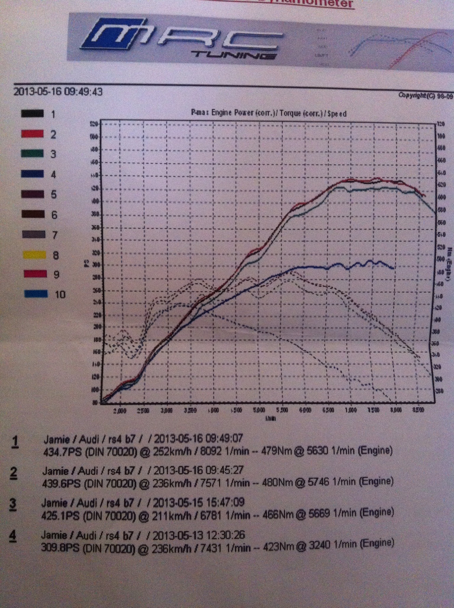

I brought the car with
Standerd exhaust with decats
Panel filter
And a old remap from mrc in 2009
I added a milltek to the car and took it to mrc for a decoke stage 1 manifold map tweek and new oil seprator
Now I asked for the pre work figures and said 309ps car has vac issues and in need of decoke at the end of the next day I see my car in pics on site with a print out so I would say this is after the decoke and vac issue

You can see that the dyno graph you showed us is for Jobbys car. It also doesn't match your starting figure of 309PS so it looks like MRC have posted the wrong graph by mistake. Contact Doug and ask him for the actual figures.

Post by Jamiestanton » Fri May 17, 2013 7:25 pm
Here's the correct one car back from mrc and running perfect :biggrin3:
2006 black audi rs4 b7 mrc stage 2 stage 2 manifold de cats miltek coil overs light weight flywheel black optics 445bhp 470nm
Re: Health check at mrc 309bhp vac issues and decoke
Post by MikeFish » Fri May 17, 2013 7:42 pm
That's better, just a touch under 440PS. That's some big difference.

It was ok before but when I drove it I came out of a 344bhp golf gti and was disappointed but now its like a different car now amazing just unreal just come down the m5 180mph <beep> scary I love the car now also not smoking now
