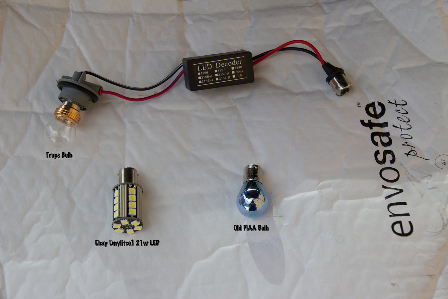

The colour looks ok so as long as it's error free, it will do. Is this the PIAA bulb?

Fogs are Halogen Ice whites so will be error free.

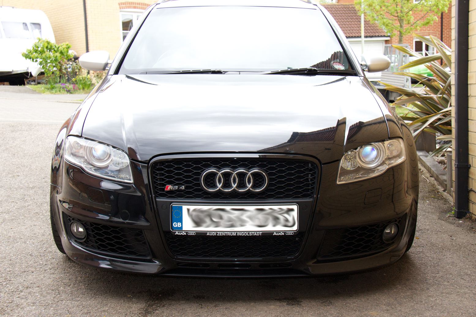

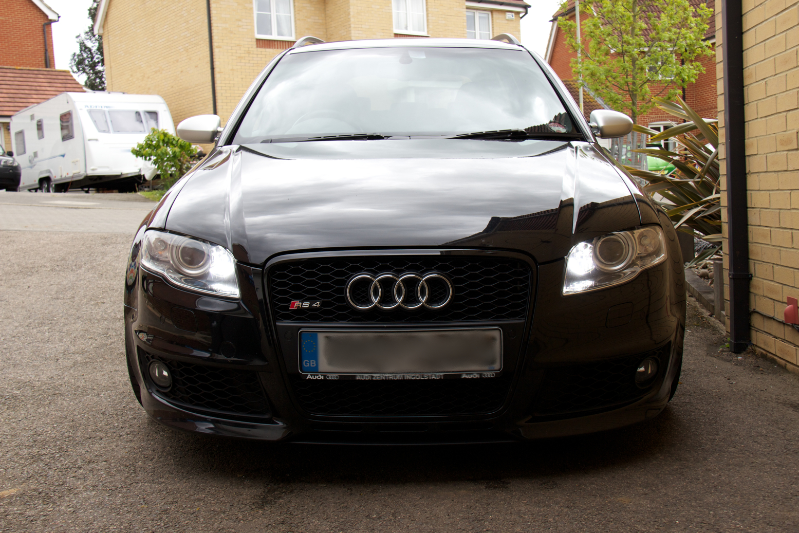

So - spent some time today fitting Trup's kit for my DRL's here are the results. I didn't use Trup's bulb in mine as I wanted a brighter set up.
They look SO much better - word of warning - make sure the replacement LED bulb you use is properly fitted into the grey adapter or you run the risk of dropping the bulb into the headlight like I did today
Thankfully my neighbour has a tool for everything and had a handy bendy long spring like tool with a retractable grab on the end! [thank god - I almost took the headlight off]

Looks so much better, you used the same bulbs that I have, had them over a year, still fine
