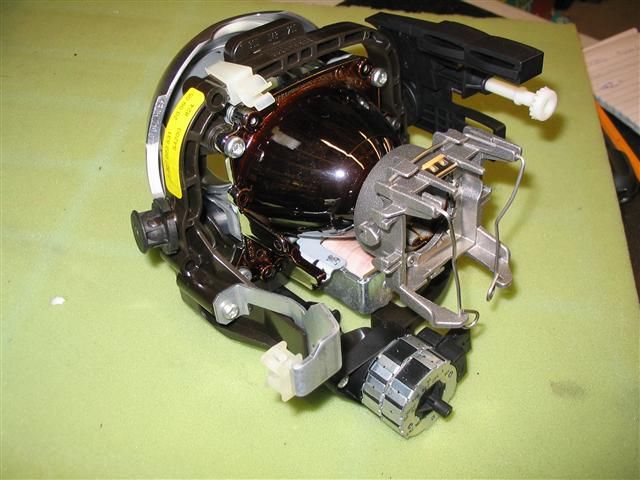

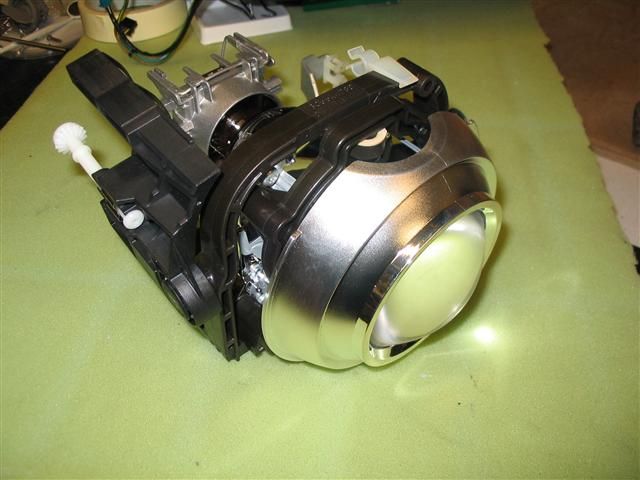

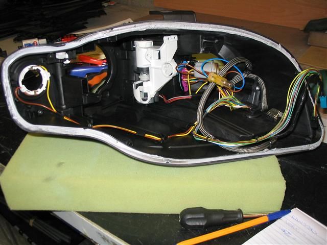

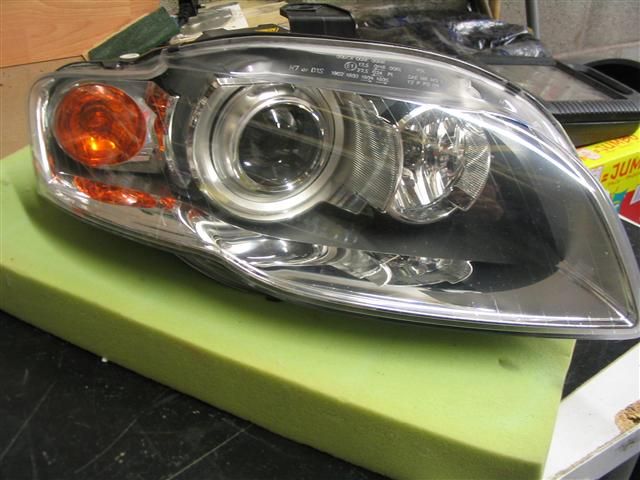

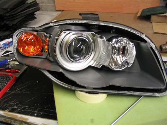

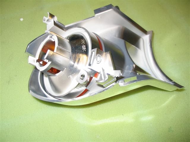

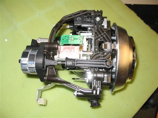

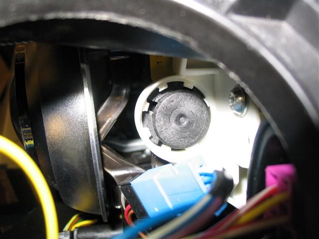

RIGHT HERE WE GO! light in bits photos ADAPTIVE UNIT O/S
LENSE OFF ! VERY EASY, USED A HEAT GUN AROUND THE PERIMETER FOR ABOUT 5 MIN WAS MORE THAN ENOUGH.
DRL/TRIM OFF
VERTICAL WHITE ITEM AT BACK IS LEVELLING MECH/MOTOR
LOOKING THRU DRL BULB APPERTURE, THESE LITTLE TABS BROKE OFF :(
XENON 'HEAD' SHOWING ADAPTIVE MOTOR AND LINKAGE (LOOKING FROM UNDERNEATH)

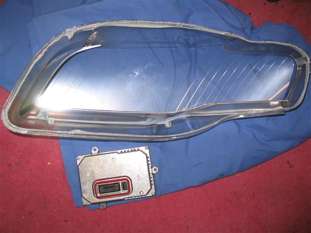

Post by 'R'e'S'pect_4 » Fri Jan 11, 2013 10:25 pm
GUTTED !! STILL CANNOT GET LEVELLING MOTOR OUT !!!
LENSE AND ATTACHED PIECE OF TRIM
DE-TANGO ANYONE ?

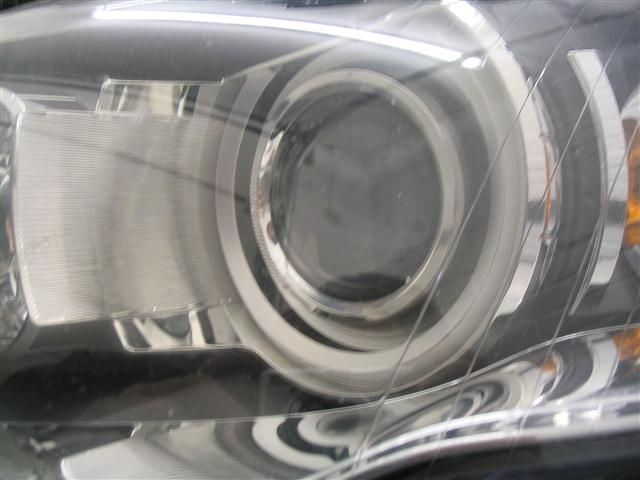

CLOSEUP OF N/S LAMP - NOTE GAP AROUND XENON 'HEAD'
O/S ONE - SMALLER GAP ?! (THIS IS THE ONE THAT WILL NOT LEVEL - BEEN LIKE THIS SINCE I BOUGHT IT AS CHECK SOME OLD PHOTOS)

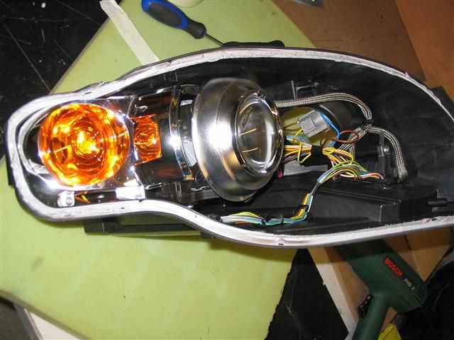

Post by 'R'e'S'pect_4 » Fri Jan 11, 2013 10:30 pm
BACK TOGETHER AGAIN - I'M PROBABLY THE ONLY PERSON TO HAVE DISMANTLED A HEADLIGHT AND NOT DE-TANGOED IT :roll:
DID NOT USE ANY NEW SEALANT AS I PROB LOST ABOUT A PEA-SIZED AMOUNT OF THE ORIGINAL.

Post by 'R'e'S'pect_4 » Fri Jan 11, 2013 10:35 pm
EXTRA LONG TORX DRIVERS PURCHASED FROM HERE...
http://www.ebay.co.uk/itm/251199785655? ... 1439.l2649
DID THE JOB WELL.

i couldn't get levelling to work so thought had nothing to lose.
you can hear motor whirring but no movement of light and no errors on DIS. adaptive was ok (separate motor)
reckon a linkage or motor has broken.
