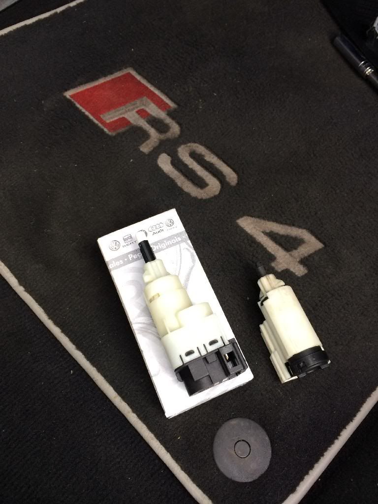

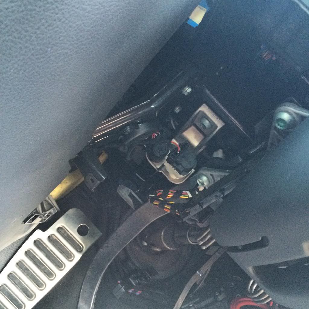

I went to use the cruise control the weekend before the service and it didnt work which pointed at the clutch switch to me and also after that journey the car would not start with a single press of the button and had to be held which confirmed the switch. I advised them of this when the car was dropped off and it was confirmed that it was open circuit via their plug in. I also had a slight nock when gently wagging the steering side to side that had came about a week or so prior which i asked them to check out. That came back with steering rack bolts which again is another obvious one as i knew both ball joints were in good order. When collecting the car i ordered the clutch switch and 3 new steering rack bolts to replace the old ones. The tech at Audi tightened up the rack bolts which have cured the knock but after reading they are stretch bolts i wandered how long it will last so i have decided to replace them...
Took less than 5 minutes to fit for what Audi quoted £100 labour for
I have looked at the rear anti roll bar and a set of powerflex bushes will sort the problem so i will be ordering a set for the whole car well im at it to stiffen things up a bit.
The engine mount i will get on order also but at the moment the issue is just electrical.

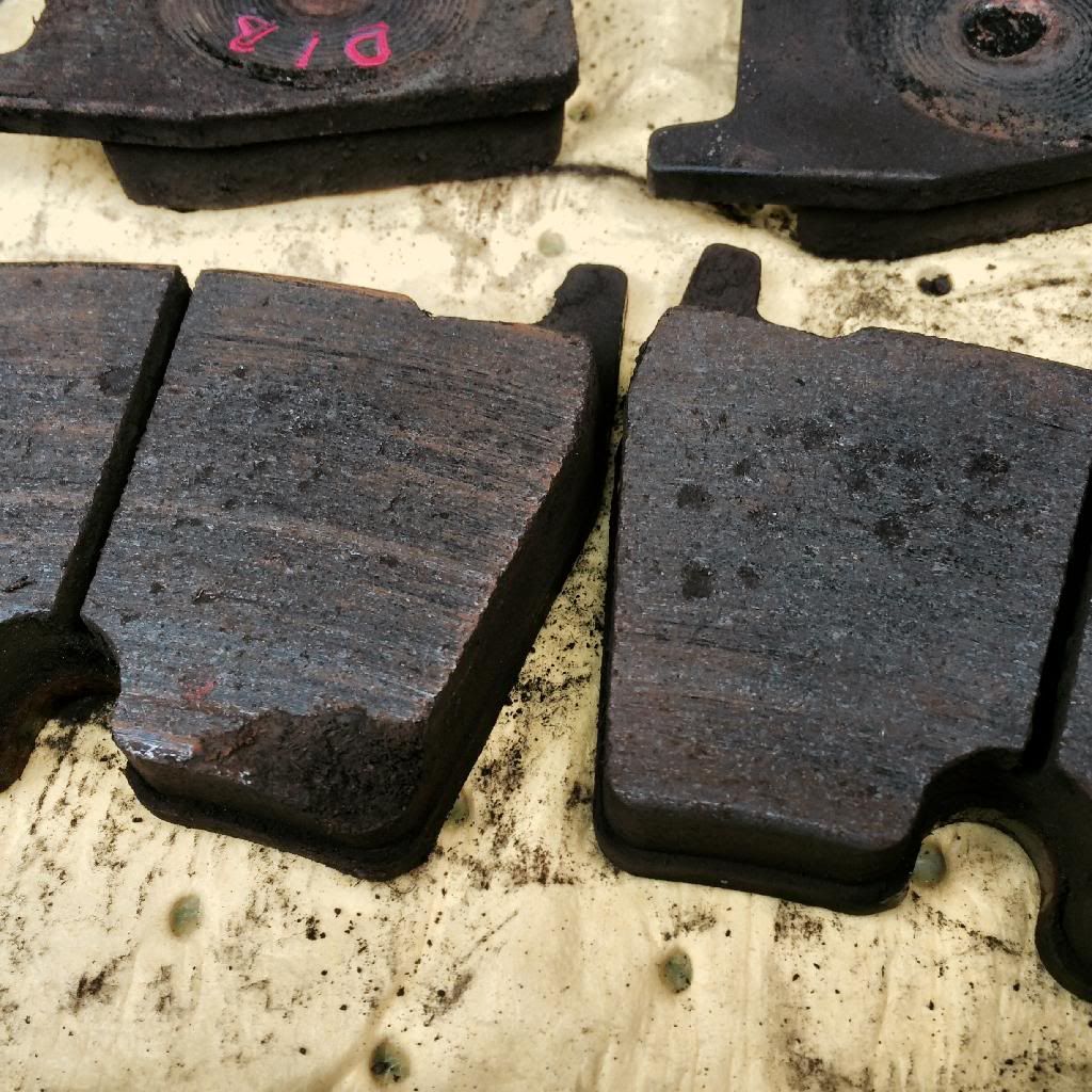

Another thing that bugged me when i removed the front calipers was the state of my £300 Ferodo pads
going to get onto them about this as im not happy with the state of them considering they have been road only and have done less than 3000 mile.

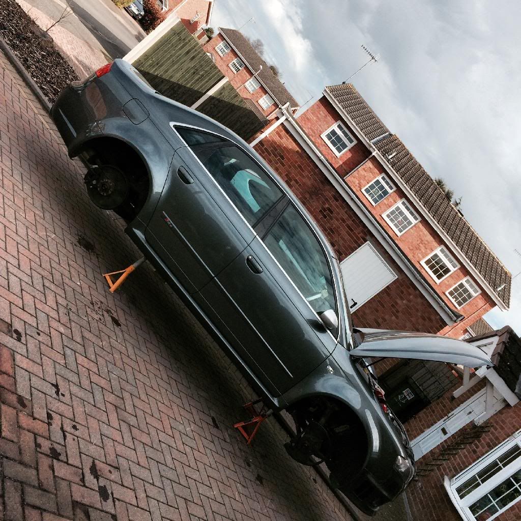

So today i set about removing all the bits for this weeks work....
and how the car is going to sit for a week looking sorry for itself

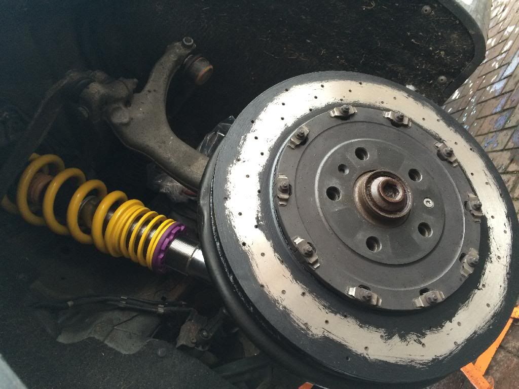

Week has gone fairly well as far as last minute mods go! Suspension came Thursday and brakes were ground and calipers resprayed this week too.
Firstly the suspension...
So got them all fitted up with their top mounts and mounted...

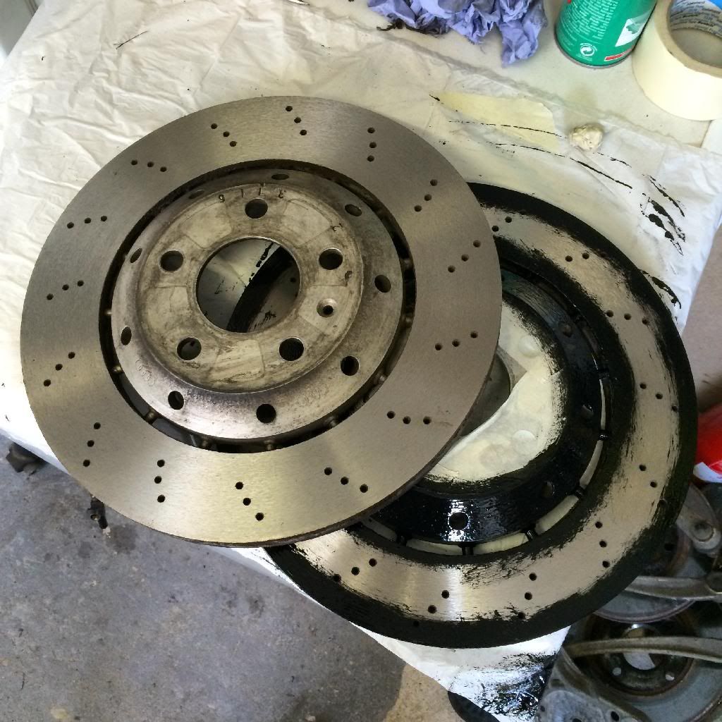

Brakes got advised to be replaced on next pad change by Audi so checked the sizing and they were all well within tolerance
Decided to grind them at work so they are nice and fresh again and there are no lips any more. Also painted the veins and bells on the rear so there is no more rust present and when they wear the non contact surface area of the pads wont rust...
Sat next to the 15" wheels on my track car! They are some beasts these front rotors!

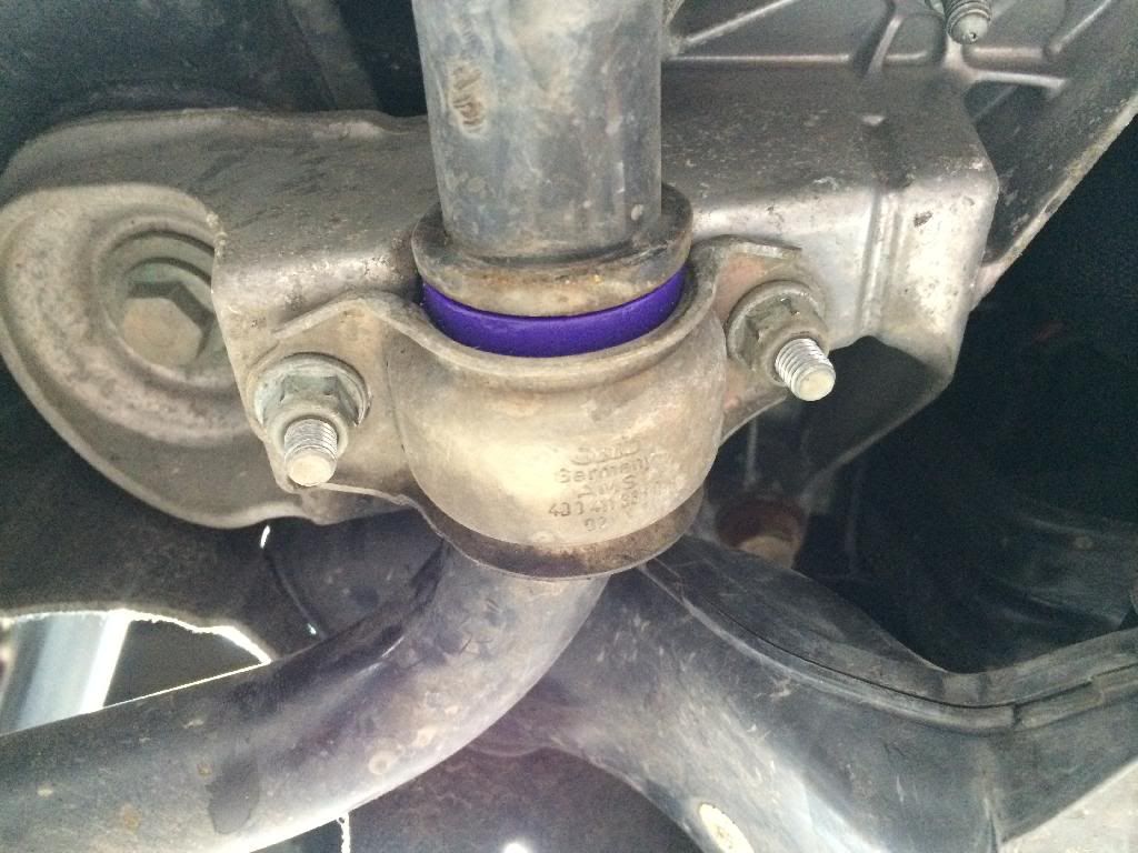

Re: The story so far...
Few more pictures to update. Been working a lot of hours and juggling with daylight and parts suppliers. Was hoping to have it back on the road last week but a broken hub carrier put a stop to that! New one being delivered today....

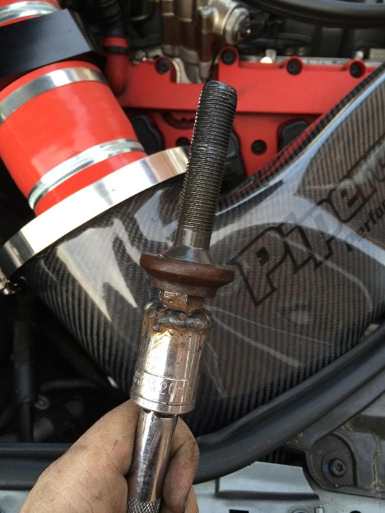

Had a fight with the hub bolt and not having a 17mm hex bit. Halfords only had a sump plug tool with 17mm fitting but was on 3/8's fitting which is no good when your trying to undo something around 300nm. So had a think and sacrificed a old socket and cracked out the welder which did the trick.

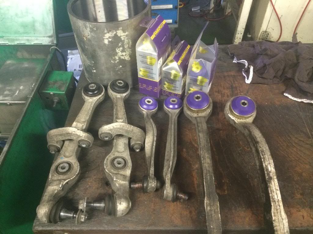

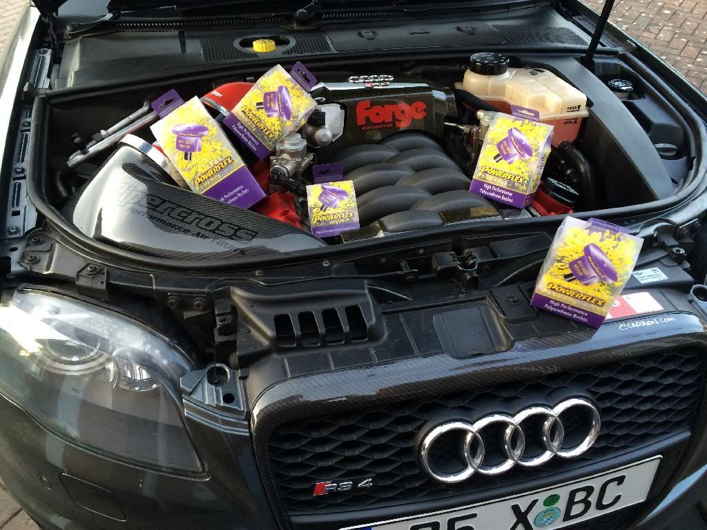

But i have got all my Powerflex bushes fitted...
and finally got the red bit of the RS logo all fitted up to finish off the calipers...
More as it comes
More as it comes
- NJMAudiRS4
- Posts: 554
- Joined: Sun Dec 22, 2013 7:38 pm
Looking very good, have you considered opening your own garage just for RS4's.
I like the sacrificial socket, proper engineering. lol
Are the bushes easy to do or would you recommend a garage to do it ?
