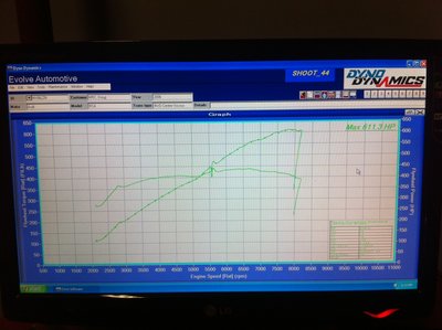

Post by Doug_S2 » Mon Jan 23, 2012 10:05 am
Tracked the b7 at the weekend and went to dyno it at Evolve in Luton.
It was on track tires and vpower so not what it usually runs:

Post by Doug_S2 » Mon Jan 23, 2012 10:12 am
It runs 3 degrees less on vpower, and intake temps were higher as they don't have as good cooling or extraction as we do. Evovle say they can see as much as 30bhp drop on track tyres, as the dyno dynamics only measures wheel power and adds the factor on.

Post by mutantfatcat » Mon Jan 23, 2012 4:47 pm
Nice results Doug and nice video too!

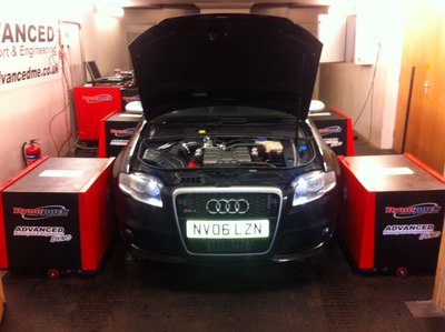

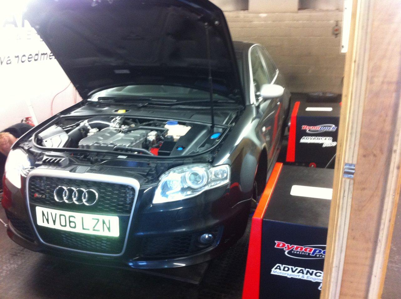

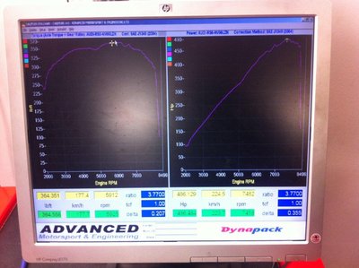

Post by Doug_S2 » Tue Jan 24, 2012 8:00 pm
Another different Dyno test.
It is hard to qualify this as very few cars are dynoed at the hubs in this country.
A standard S5 does 212 hp at the hubs and the TTS supercharged S5 does 470 hp at the hubs. The MRC/TTS supercharged RS4 does 486 hp at the hubs. The operator said this is consistant with 600+bhp at the flywheel cars.
I have a plot of a US RS4 B7 with a competitors supercharger kit on it doing 386hp at the hubs!

Post by Mr V10 » Tue Jan 24, 2012 8:12 pm
Nice work guys, you've probably built the ultimate modern day Audi. Handling/looks/power/noise. The fact that you are taking them to independent dynos also reflects the confidence you have in your product. :thumbs:
