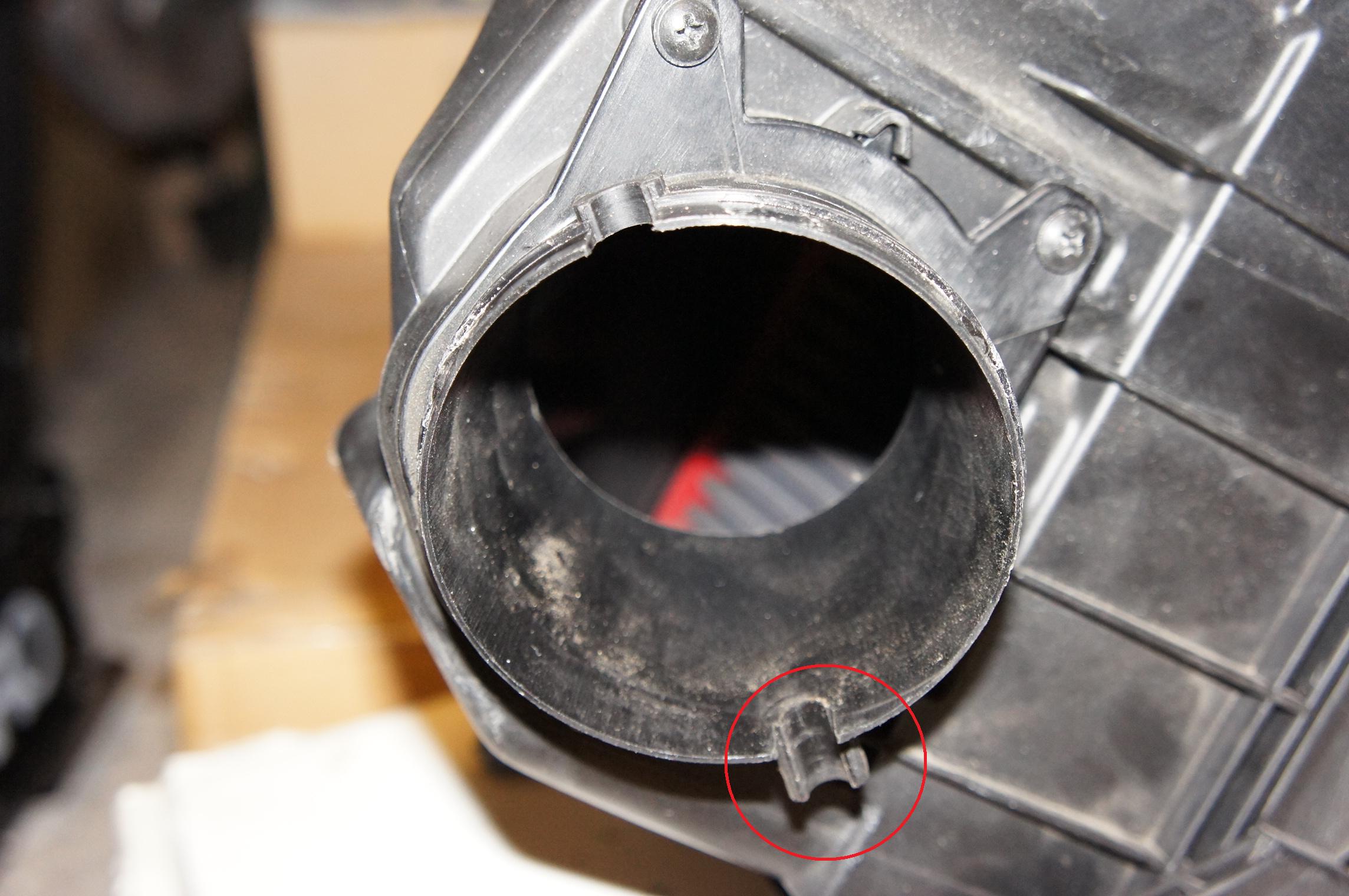

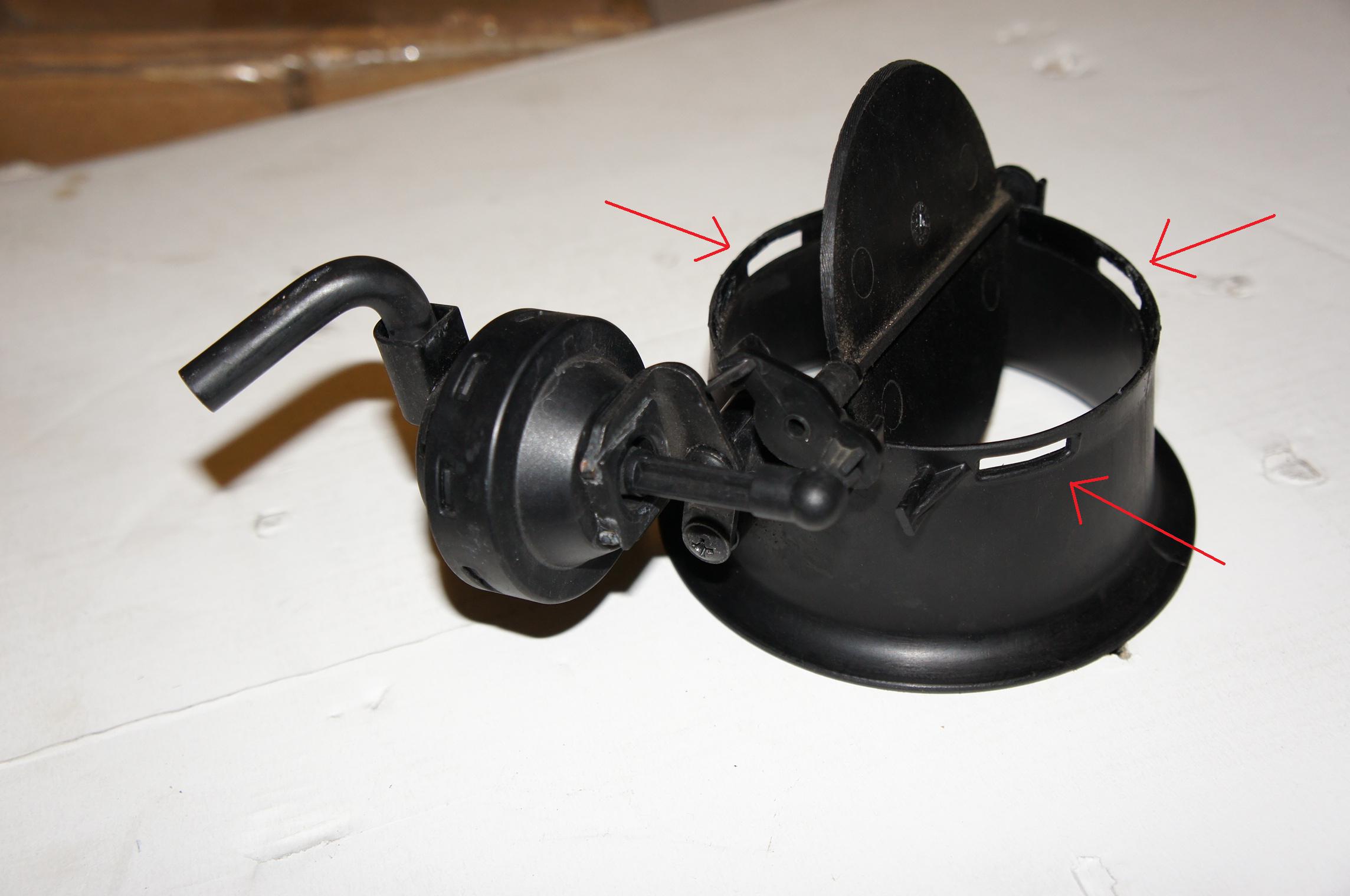

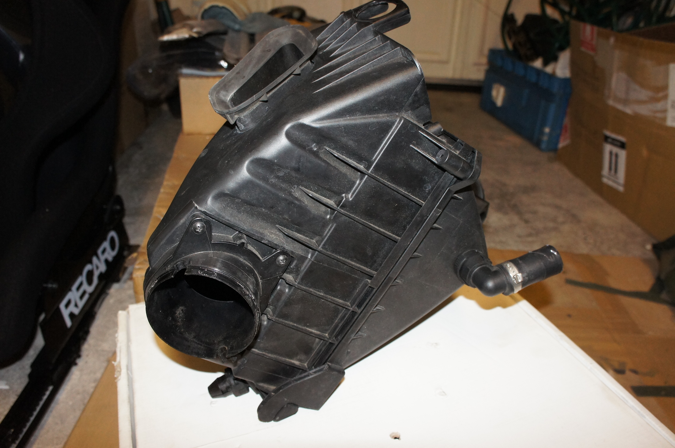

j1sgo wrote:Nice, does that then fit into the airbox hole where you removed the flap, how did you secure it as if i remember there is a trumpet on the airbox isnt there?
Yep there is. The airbox snorkel comes off, this houses the flap and vacuum actuator.
I split mine, and fixed the the bottom half back on. So at a later stage I could put it back together if I want.
Only modification I made was to a large plastic tab that stuck out (in red circle), I simply cut 4mm off the end, so the 89mm tubing slides over and fastened with a jubilee clip, this also acts as a lip to keep the ducting in place.
If you are still running with the IM flaps or IM vacuum system then you will need to trick the car in thinking the air box flap is still there. MRC fitted a resister/bypass switch (cant remember what it was, will get back to you as soon as I remember/find out).
Dont have any pics of the ducting connected to the air box, but there's a few pics kicking around on this site.
Tabs removed here to split snorkel
Plastic tab, shaved 4mm off.
Airbox, you can see the side wing vent.
