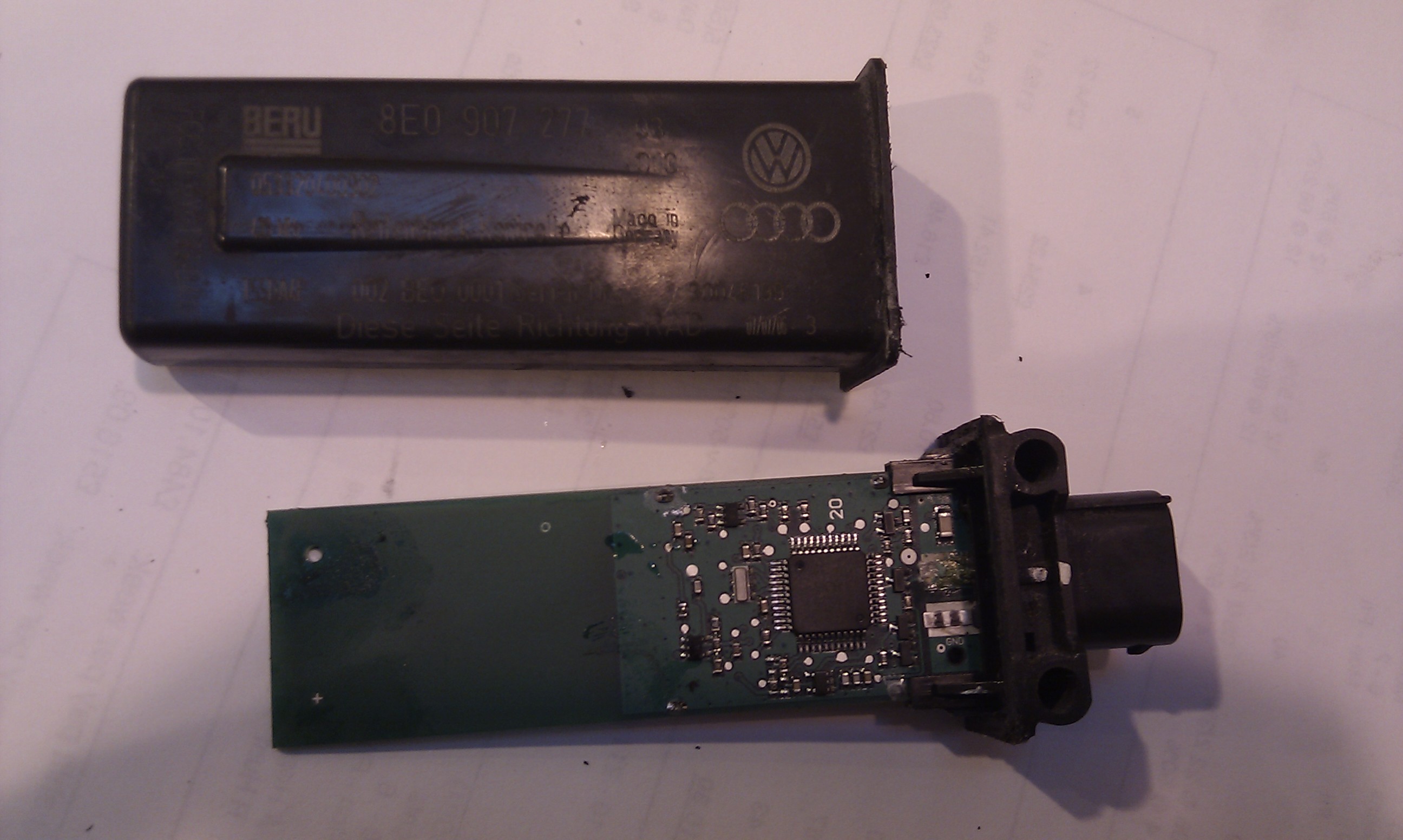

Thought I would have a look inside the antena to actually see what had broken!

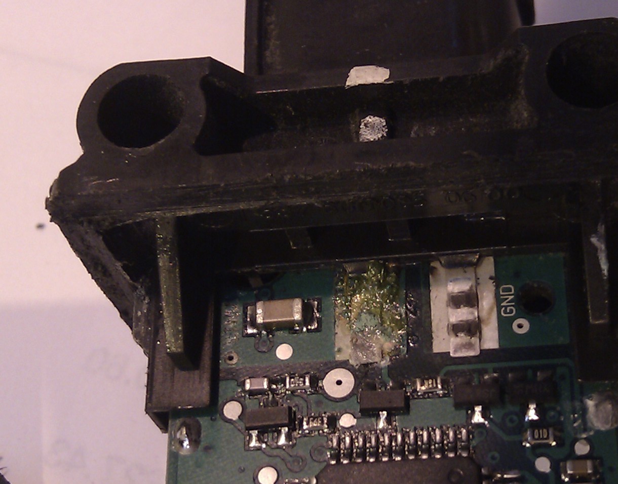

Post by weenie » Sat Feb 19, 2011 8:04 pm
Looks like water had got inside through what looks like is ment to be a drain hole. Circuit board is corroded/burnt up. Quality german engineering again!

8E0 907 277 according to Weenie's pic :)

oh yeah, didn't think of opening up the pic and looking :oops:
