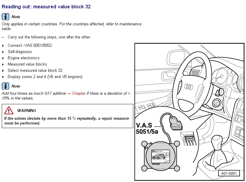

your looking for deviation in values 2 and 4 in measured block 32, you should then do a round of G17, (or if it is really bad G17 at 400% of normal concentration) and re measure block 32, if that does not work additional work is required (but I have not looked into that yet).

Ice_Coffee wrote:your looking for deviation in values 2 and 4 in measured block 32, you should then do a round of G17, (or if it is really bad G17 at 400% of normal concentration) and re measure block 32, if that does not work additional work is required (but I have not looked into that yet).
what is Rep gr.24? please :D
error in the instructions
1/4 normal 15 mil
if deviation 4 times as much 4 x 15 ~ 60 ml, but the example says 100 ml?

I noticed that too arthur, but I still think it means 4X not 6X, additional info coming up

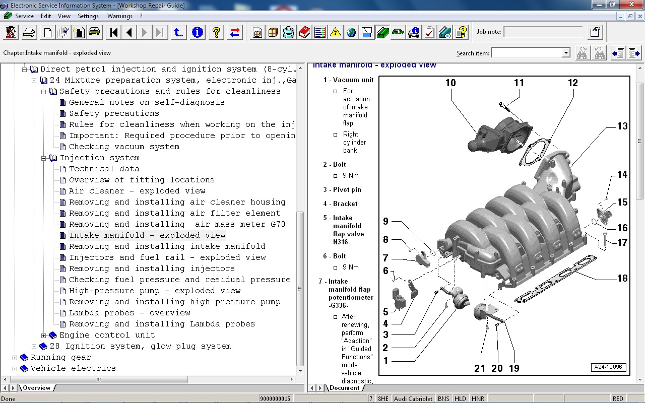

Rep Gr 24, is repair group 24, it is detailed instructions on how to disassemble the whole intake area of the engine, I assume to diagnose a fault, if there is any specific section you are looking for let me know.

what are the descriptions for values 2 and 4 in measured block 32?
what parameter/variable, ie, timing? air flow? ???
what units and acceptable/in-range values?

Post by Ice_Coffee » Sun Jan 30, 2011 10:21 pm
This is all it has about block 32

Post by ArthurPE » Sun Jan 30, 2011 10:39 pm
thanks, that is helpful
block 32
zone 4 (V8, 2 is for the V6)
the value (whatever it is) must have a deviation <15%
if >15% use 4 times as much
maybe it's the injector pulse width/on time?
if some are on longer (>15% more) than others they are occluded/plugged up???
hmmmmm
