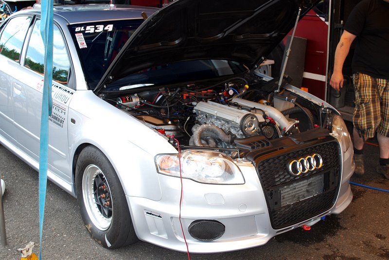

Konrad
Posts: 5
Joined: Sat Jun 05, 2010 7:54 am
Location: Estonia
Post by Konrad » Fri Nov 19, 2010 7:27 am
Dannyrs4 wrote:The fastest rs4 in the world uses the old i5 engine I think pushing out a 1000bhp.would be good to have details of that build
Not much left of an RS4 in there, but since you asked (as of summer 2009). Ran 8.3 1/4 mile at that time.
Originally Posted by repo:
-my2006 rs4, built to meet national Street B class regulations in Finland
-original supporting structure retained
-SFI 25.5 rollcage
-Carbon hood and bootlid
-Original doors with original glass windows
-Original headlights, tail lights, side blinkers
-Stroud parachute
-M/T ET street DOT approved tyres, 10.5/26.5/15 front and 11.5/26.5/25 rear
-weight 1250kg with pilot
-2.2l 20v audi motor
-PO metal H-beam conrods
-Wiseco custom pistons
-Schrick / Catcams valvetrain
-head ported and modfied by 4wd dragrace and Nordic Porting Service (Marko Pirkonen)
-CompTurbo CT4813b turbo
-manifolds designed and built by Pro-Mo Racing Service Jyrki Repo
-tatech T32 pro, 32bit engine management and engine datalog
-Racing Technology DL1 chassis and suspension datalog with 6G accelerometer and 20hz GPS
-980 non-corrected horsepowers at all four wheels @ 2,6bar boost. +950hp from 7300 to 9300rpm
-1120 DIN corrected horsepowers, 960Nm @ 2,6bar boost
-VP ms109 fuel, nitrous is banned, so no nitrous.
-Liberty Equalizer transmission with modified shifter linkage
-partly homebrewed 4wd system and power ratio adjustment
-Strange rear diff, driveshafts and brakes
-CrMo 4-link system
-custom CrMo diff housing
-original steering arms and column
-original front suspension
-Nismo 2-way front diff
Dynosheet:
http://promo.pp.fi/temp/1086hv.JPG
Incar vid:
http://www.youtube.com/watch?v=VDZwAURY3uw
