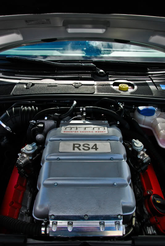

There's many more questions as I have looked into this myself, however it is expensive. do you have any pics of your engine?

Post by larshs » Sat Feb 20, 2010 5:25 pm
You can have the MTM with oval pipes like OEM (they don't show it on their website).
Fitted in june 2009 ( 20.000 km by now).
No engine problems (only upgraded the software a couple of times, MTM continously update it)
Service interval is the same.
Additional cooler fitted.
No extra tank.
There is also a lot of small adjustments:
-different oilfilter and arrangement
-no oildip/pin anymore (using the hole for returning oil from the SC)
-new airbox lid (same filter and housing)
-new pully arrangement
-different fuel pipes
Did not clean the valves and have no plans.
I have the installation manual on paper. If you are interested it might be possible to scan it and send it to you.

Post by larshs » Sat Feb 20, 2010 5:45 pm
pic

Post by Dom81 » Sat Feb 20, 2010 6:10 pm
Stunning...
