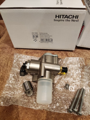

ok - so the HPFP parts have arrived:

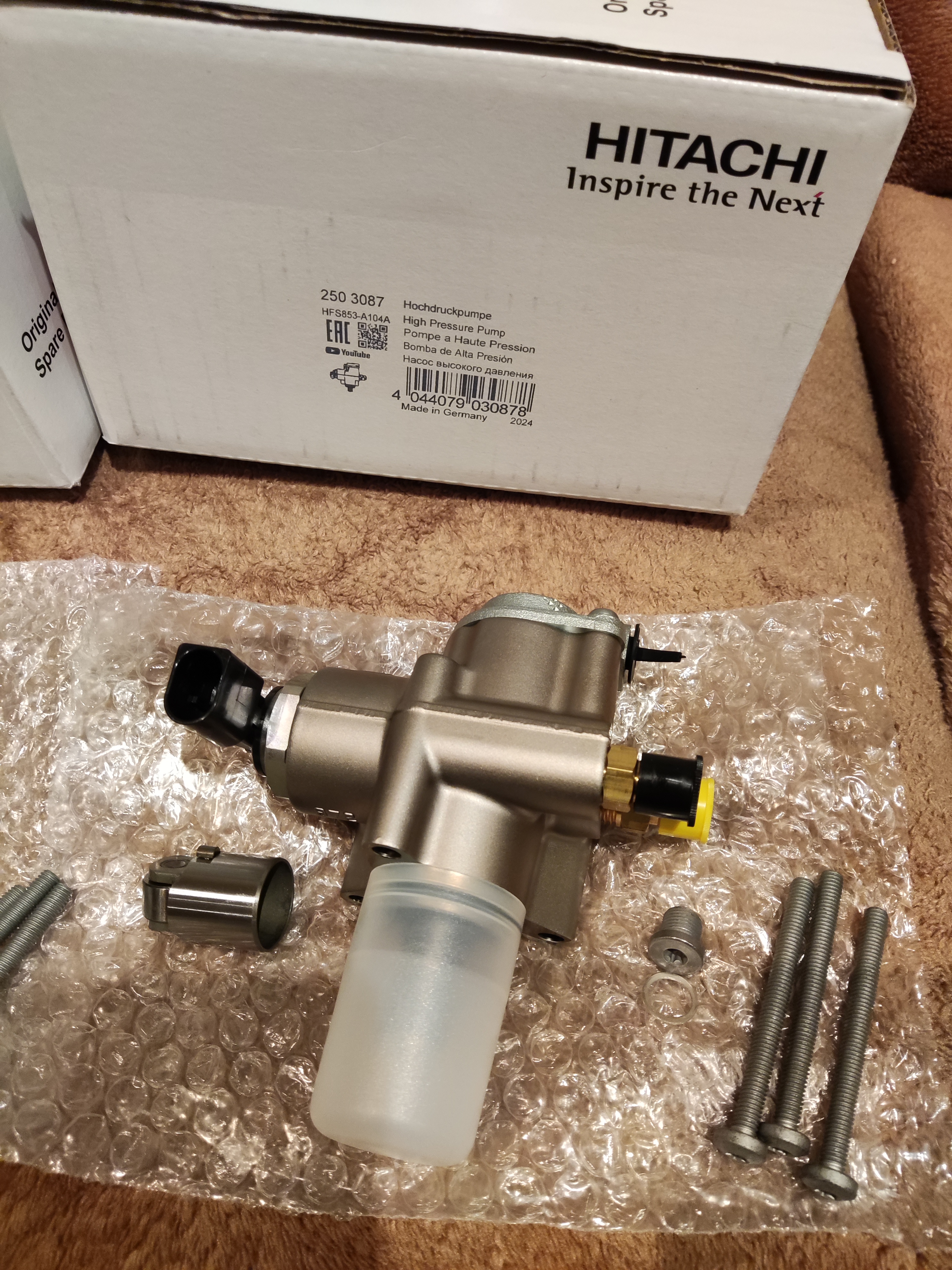

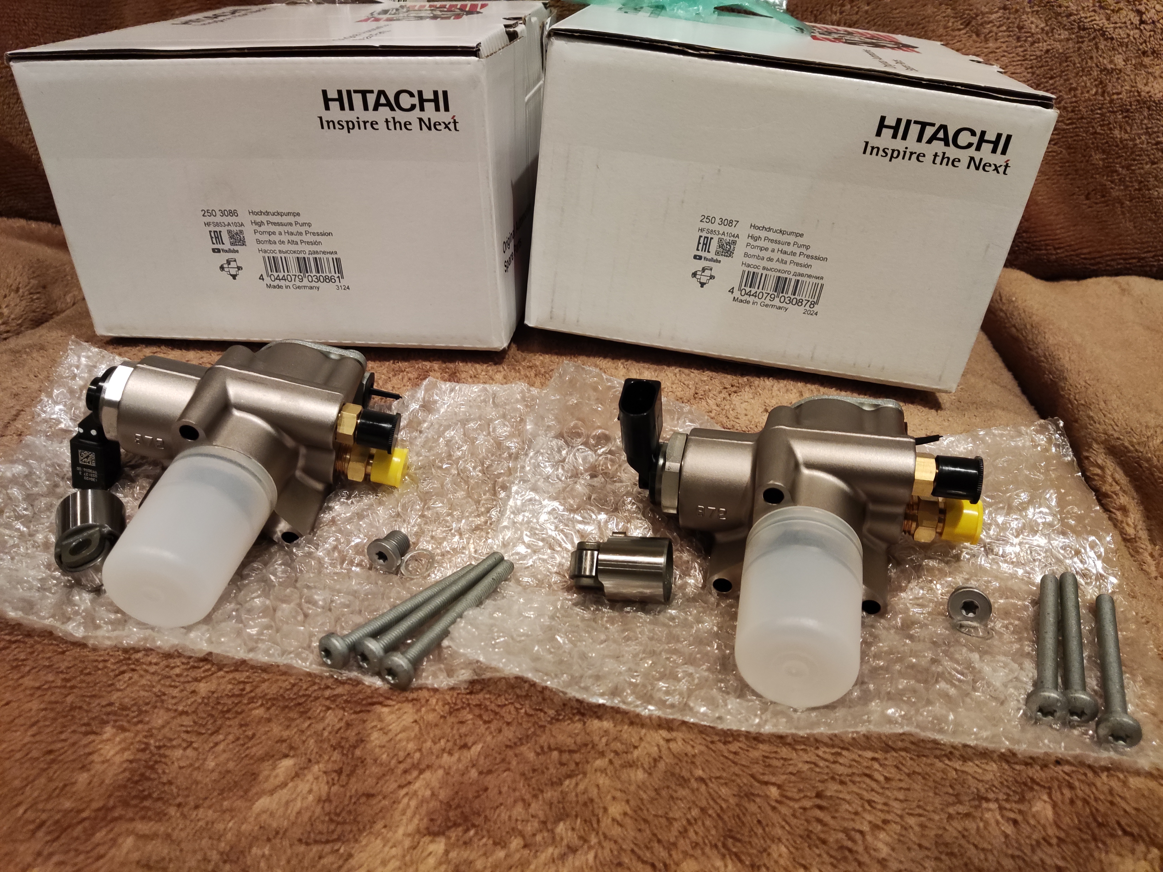

Parts Ordered:
2x OE Hitachi HPFPs
2x OE Cam Follower / Tappets
6x Hex Bolts
2x Seal plugs / bolts
2x Washer rings

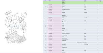

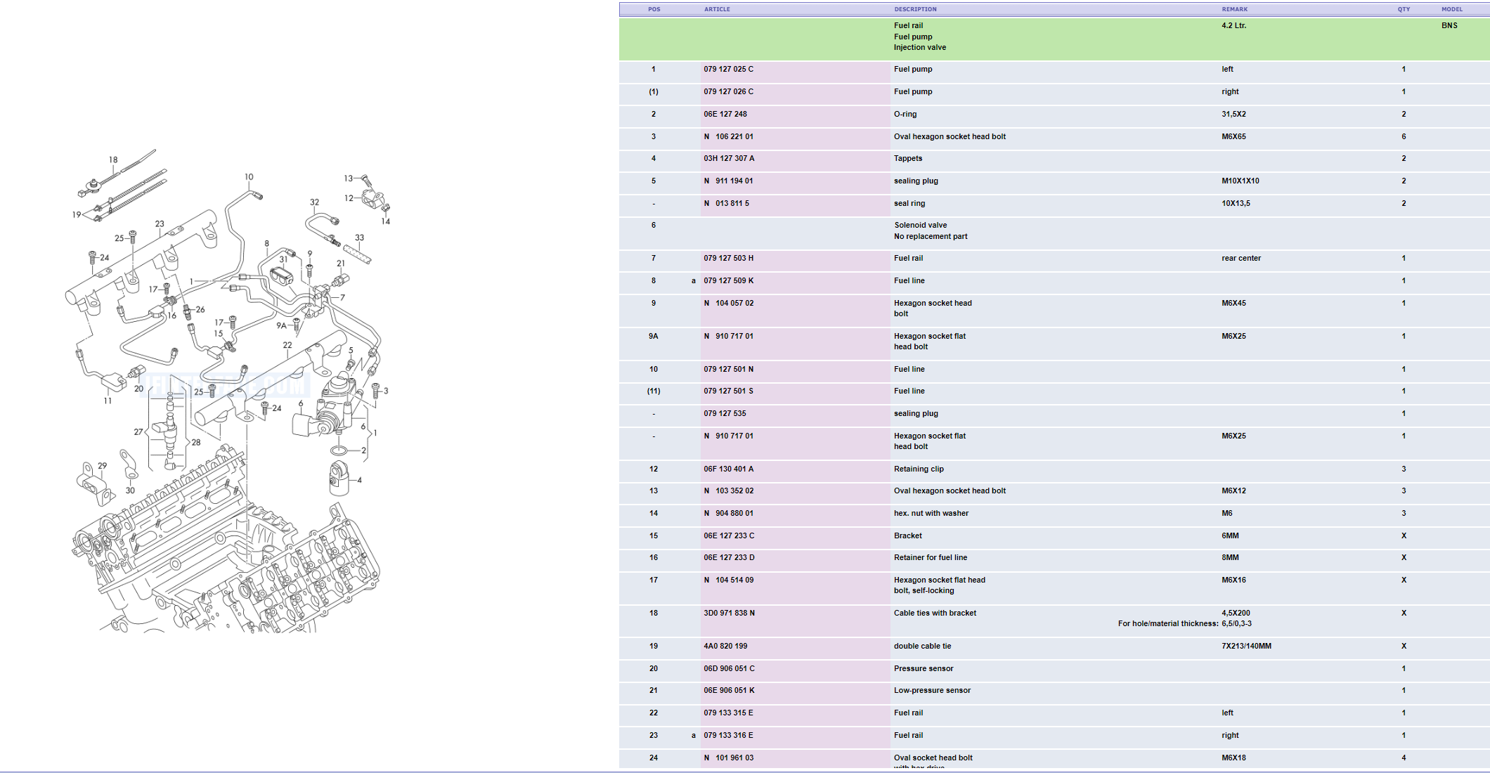

The part numbers are listed in the diagram below, for your benefit:
