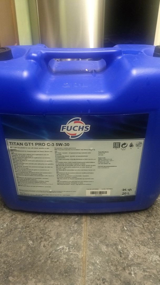

docurley wrote:
Thu Oct 19, 2017 7:34 pm
Got my 20liters of a mate who runs an oil company all for under £80
I’m using this oil on the next change, since the service Iv already topped the car up with 1 litre! How on earth do these cars burn so much oil?!
Crazy as I supplied 10 litres and I had no oil returned and Iv already had to top up.
It’s definitely burning as there’s no oil leaks on my garage floor :/
