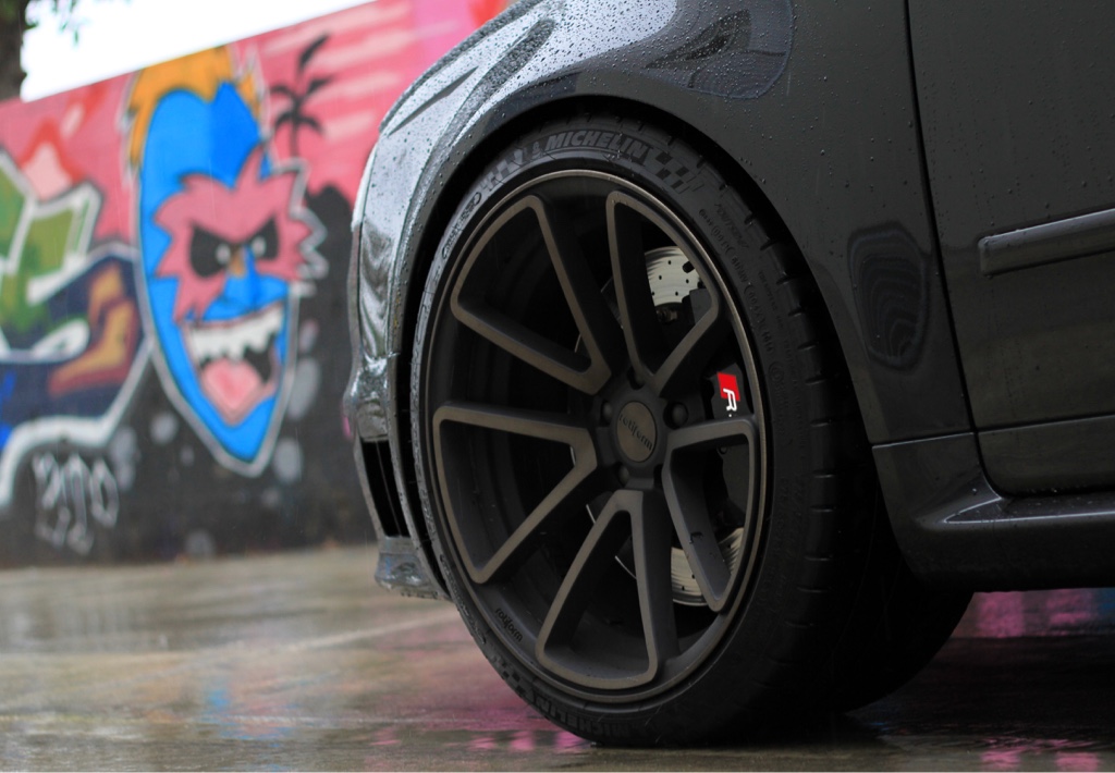

RS4eddie wrote:
R1RS4 wrote:Nice piece of kit - simples
What did you do with the rear inner arches?
rears were fine..not needed. are you running in the back too??
Yes mine is rubbing at the back both sides, standard 19's, recently removed the 10mm spacers but still rubs, so putting it up on ramp tomorrow see if I can find the reason
Just interested on how the arch rolling was done, as I would like to move to 20"s and go as wide as poss, could probably make that kit myself if I couldn't hire it

Strange your rubbing in the rears.. I had 12mm spacers with stock wheels/tires and did not rub.
what size tires?

R1RS4 wrote:Yes thx Mike for the link
Dave, Love the set up
How did they finish the arches edges off? Did they fold the lip back inside?
Do love that RS6 grill, what have you done about the number plate? Rich
Thanks. The inner lip that goes in on the front arch was completely removed and then finished properly as if it was never there in the first place. Definitely not folded back up inside. Very crude way that in my opinion.
I cut two diamond shapes to mount behind the plate in the screws. They then slot through the grill and get turned 90 degrees to lock in place. There's foam padding on the back of the number plate so it doesn't rub.
Cheers for the reply
Pro job then,
Which model RS6 grill is that then? I have seen some cars running without the front number plate, the guy from QST runs his RS5 without a plate does look good, but my luck I would be stopped every day
