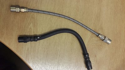

Rob, as requested, I picked up the latest revision of the return hose/pipe assembly, see photos below (not sure if you can tell much from a picture). I would say that for a flexi-hose, it is very rigid so perhaps they have changed the spec of the flexi to reduce any potential for collapse under vacuum. When I eventually get the clutch done, I will make sure all the old bits are kept and might be able to compare old with new.

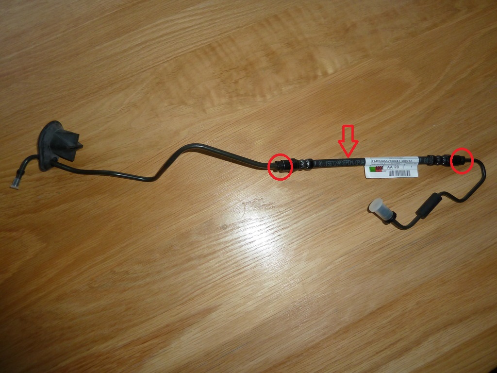

The pipe doesn't look any different to the original one, this later one from Audi is marked 'EPDM' it may be uprated but I doubt it, where I have circled the pipe is where the unions undo this removes the metal pipes from either end we then replace the removed rubber section and fit an 'uprated' teflon lined stainless overbraid pipe re-using the metal pipe end sections as these cause no problem, this pipe is far more resistant to heat damage
We have first hand experience of these (admitedly the original fit pipe) failing internally restricting the oil flow and most importantly then not allowing the fluid to return holding pressure on the clutch and hence then allowing it to slip.
