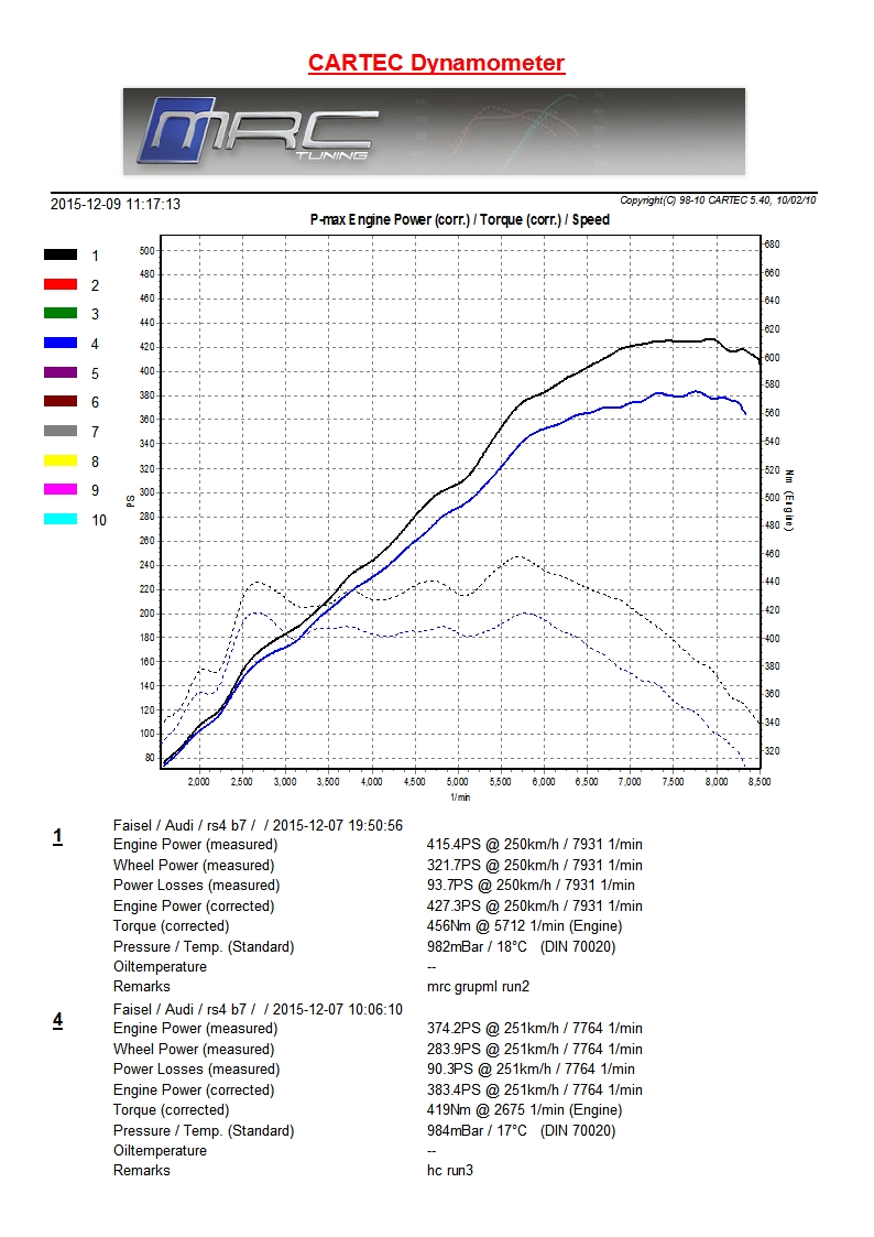

Mine was down 44 PS. 383 PS pre clean to 427 PS postJCviggen wrote:On a stock exhaust or Milltek maybe not, but not all cars are equal.Covkiller wrote: With a remap you will not get over 400BPH
What is certain is that a "normally" coked up B7 isn't losing 40-50hp to the carbon. 25 maybe but half of those will disappear again very quickly in between cleans. So we're talking fairly huge expenses to maintain a 10-15hp advantage. Given the total amount of horsepower out of this engine you're not actually going to feel 10 more or less with your butt dyno. If the facts were laid out this way I think many would decide it's not worth cleaning a car that is running well.
Mine's never been cleaned to my knowledge and with the addition of the JHM exhaust and tune it is certainly well past 400 MRC PS at the moment, doing 3-8K in 3rd gear in only 7.2 seconds and completely matching a 250kg lighter 430 bhp 991 GTS for in-gear acceleration.

Then either your coking was severe or there was more going on than just the carbon.

It was cleaned a year ago by AMD (not all that well me thinks). There was a clogged breather pipe, but that was all.JCviggen wrote:Then either your coking was severe or there was more going on than just the carbon.
I got the impression from MRC that I had a fairly typical loss from carbon buildup.
