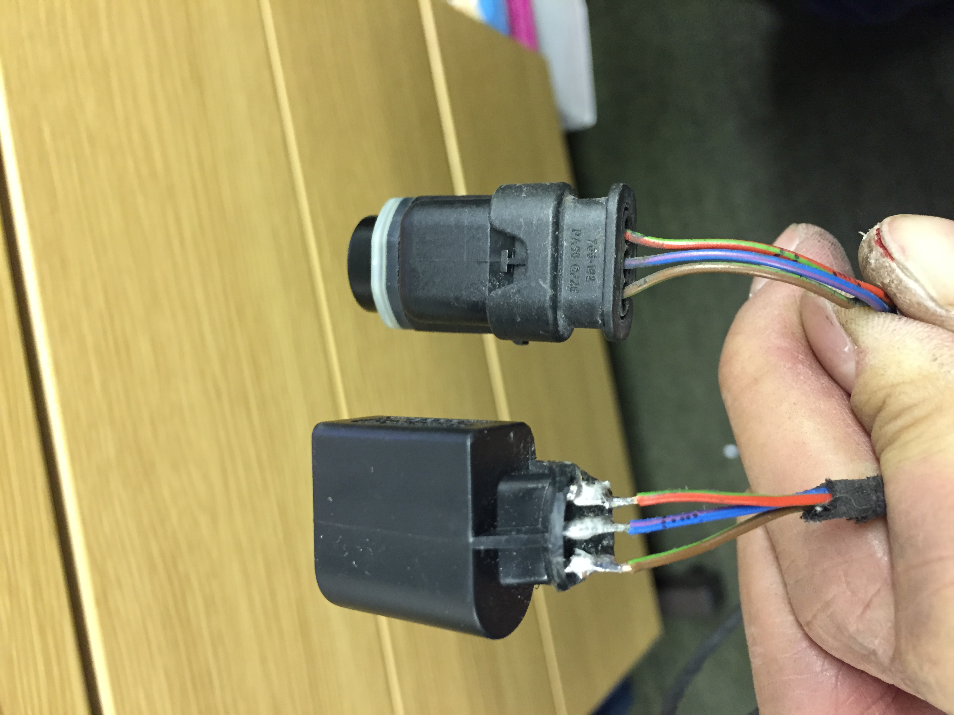

This is what I've done with mine. Made a harness that plug in between the new style sensors to the old harness, the only problem I've got is that the placement of the new sensors are too low and it's picking up the ground sometimes.

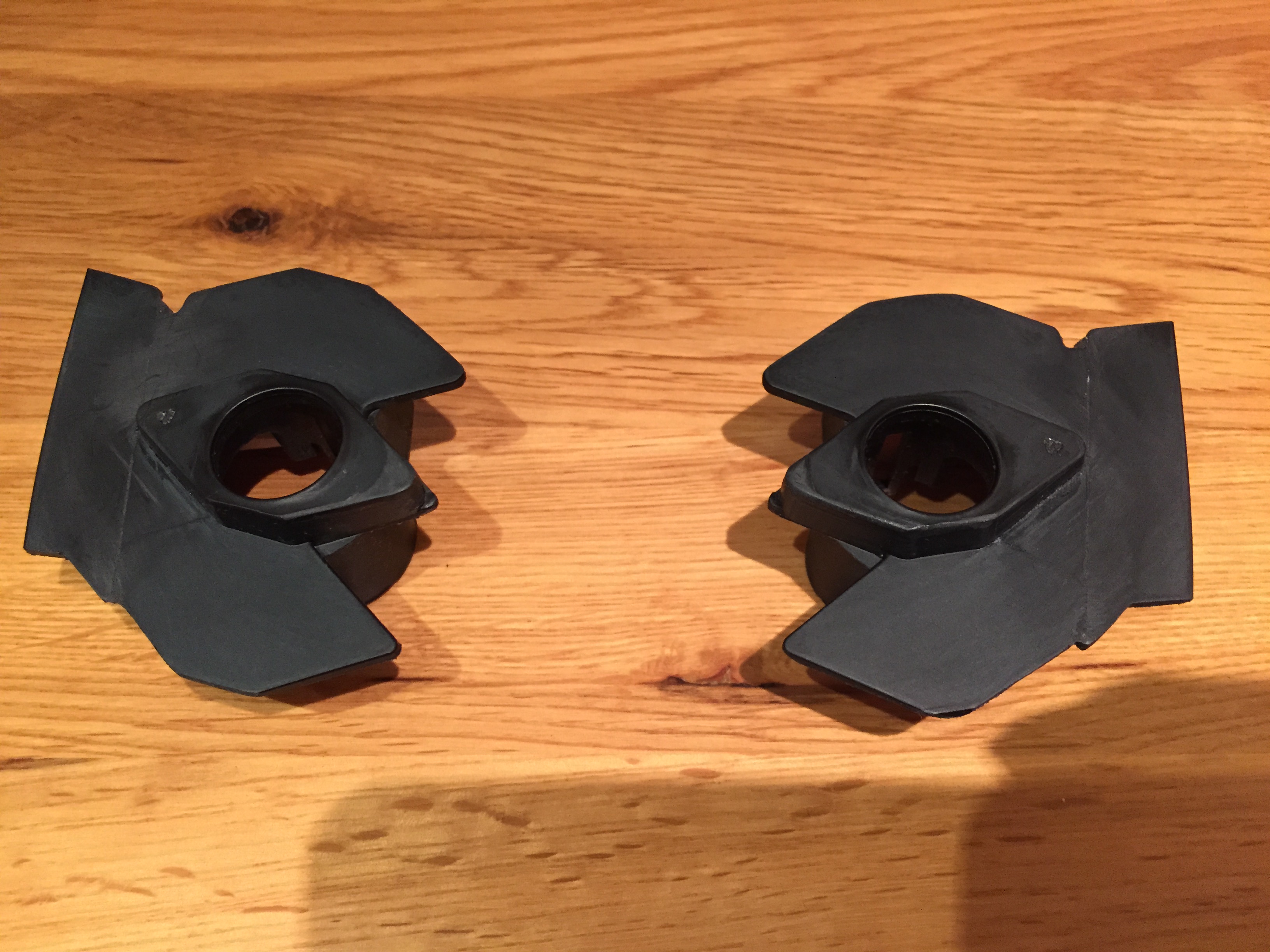

nij wrote:This is what I've done with mine. Made a harness that plug in between the new style sensors to the old harness, the only problem I've got is that the placement of the new sensors are too low and it's picking up the ground sometimes.
Very nice job bud. Are you still using the OEM sensors that originally came with the car?

The OEM sensors are too big for the grill, so I used the new style Audi sensors (the one I used are 1S0 919 275). I decided to make a adapter instead of cutting the original harness, so I bought two aftermarket old style sensors and a second hand A5 harness. By trial and error with the wiring, I got them working. I also made the sensor mounts to fit them from the pre face lift RS5. I hope this helps.

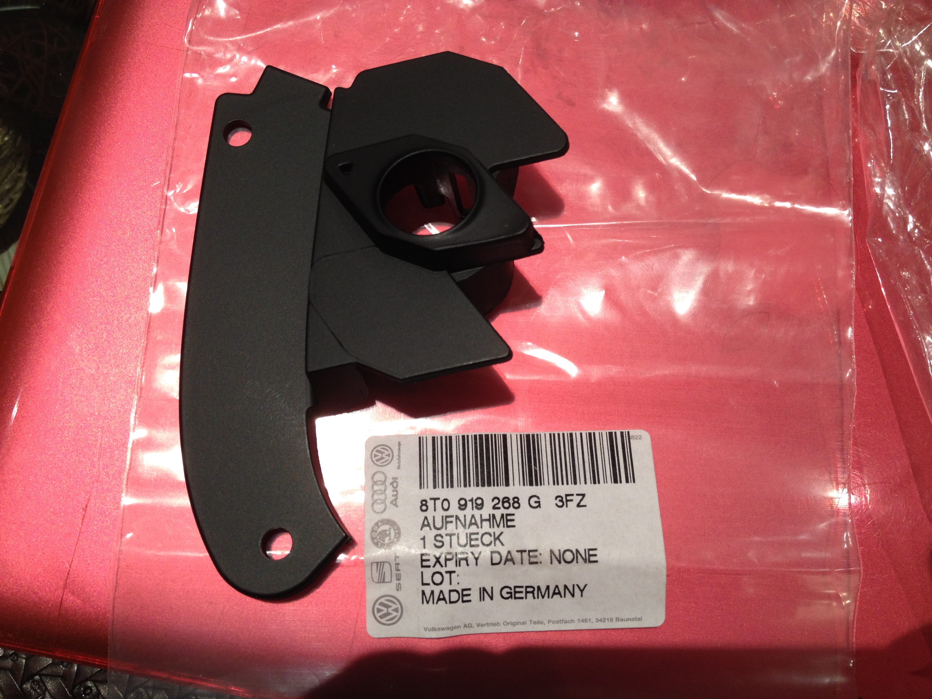

Very helpful nij, where did you get the mounts from? I.e. I assume you didn't buy a whole RS5 grille for the mounts...

I just bought the sensor mounts. They were quite expensive for a bit of plastic, but I was hoping it would fit without modifying them. You could get some cheaper alternatives from eBay and glue them in place.
There is one of the RS5 sensor mounts that I used.
