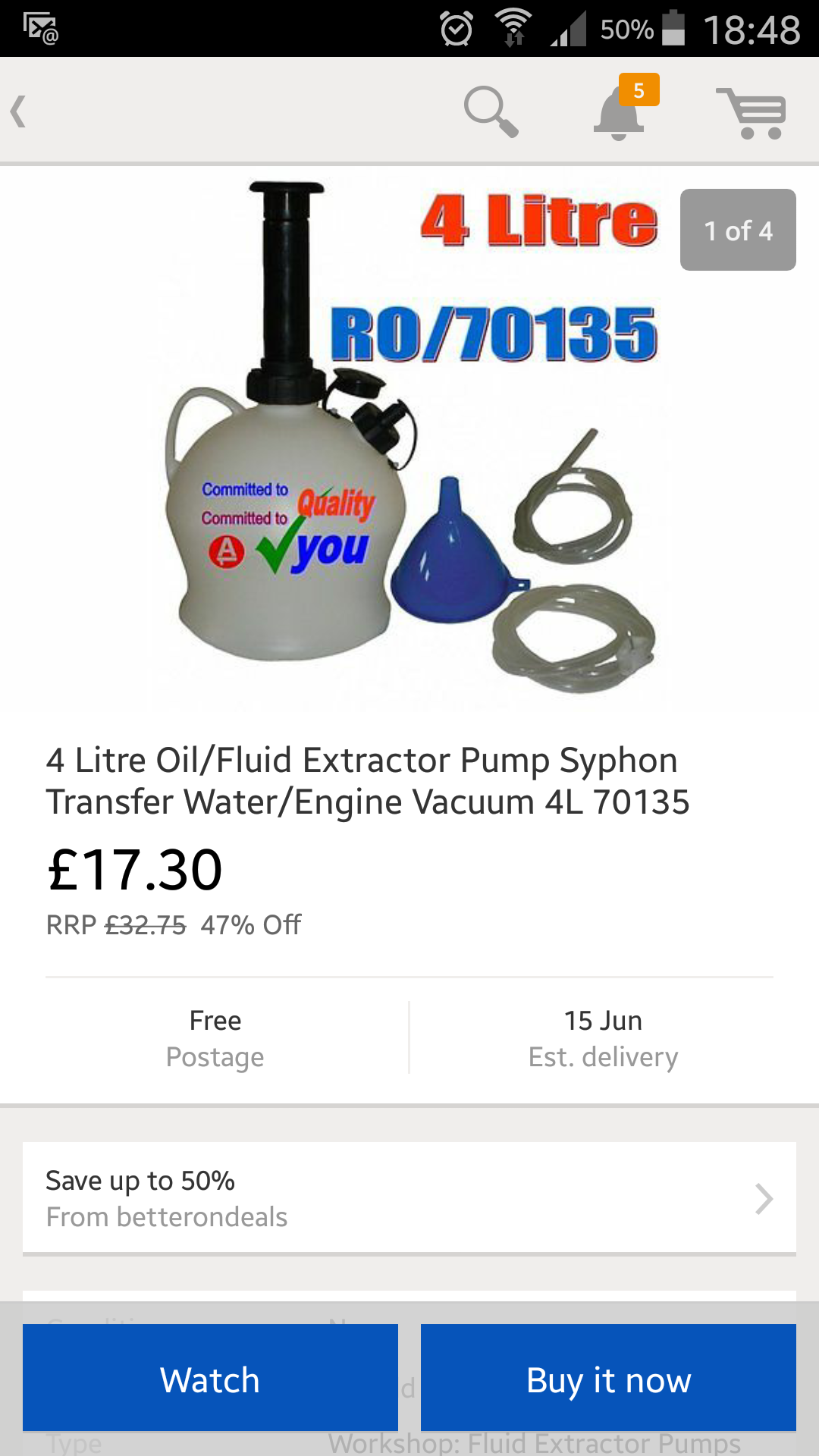

Done mine today, easy peasy. I did use one of these tho
Bought primarily for oil changes through the dipstick, thought I'd try it out on this. Winner!
works real well and shapped to fit between your thighs. No mess.
