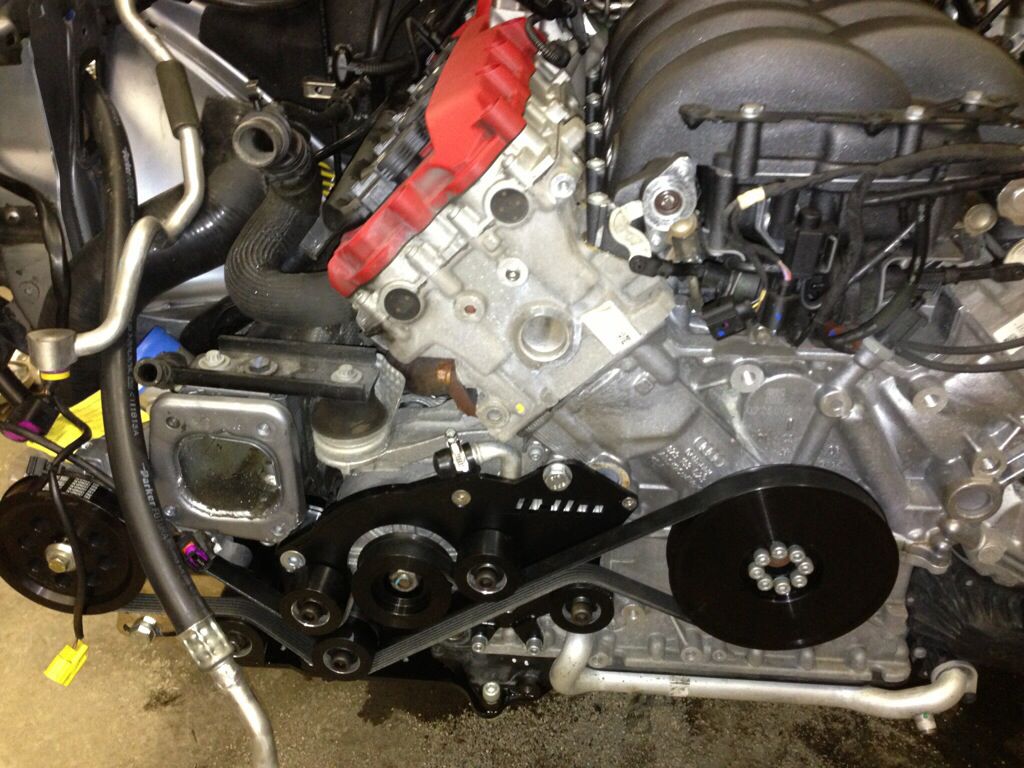

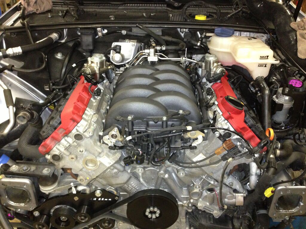

Sorry if this is a silly question, but where does this sit in the engine bay? All other chargers I've seen go on top of the engine

Rw@@dy wrote:Sorry if this is a silly question, but where does this sit in the engine bay? All other chargers I've seen go on top of the engine
the supercharger is bolted on to the bottom front drivers side of the engine where the auxiliary radiator and secondary air injection system lives, these are done away with in the jhm kit (my aux rad is already gone from when i fitted the cold air feed pipe and my secondary air injection is still there but mapped out from my mrc remap).
also the air conditioning dryer/filter thing lives in this hole, hence why you get the re worked air con pipes as this has to be relocated.

sar, it's awesome you doing this yourself
Stole these pics from AR, 930chris did his own build too
So guys can see the placement

Where does it fit into the intake system?

adsgreen wrote:Where does it fit into the intake system?
the blower feeds right into the throttle body. Feeds up from below. Stock airbox is removed, aux rad is removed.
Where other superchargers replace the intake manifold, which can be a costly piece of design and limits your supercharger size/cooling size, the JHM kit basically acts as a really effective airbox and feeds the OEM intake manifold via the throttle body. Their stage 2 setup uses a very large intercooler setup. Intake Air Temps were basically ambient and even below if you fire some ice in the A/W IC reservoir.
