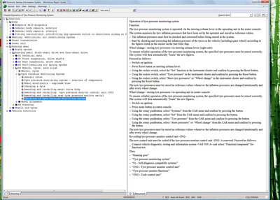

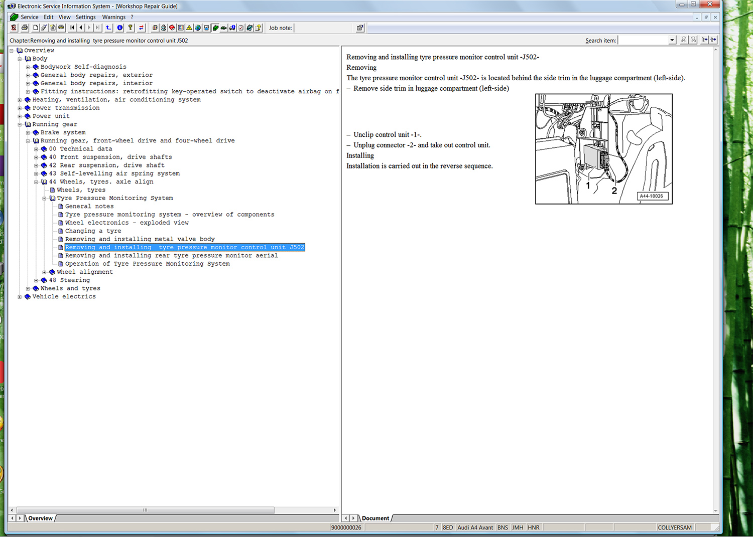

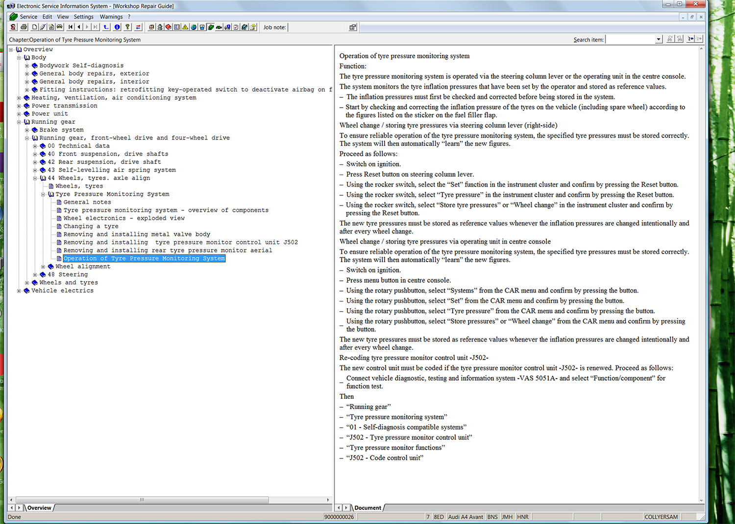

Beer is always a good place to start for a bribe. Just checked Elsawin for the TPMS controller location and have attached a couple of screen grabs (click to enlarge).
First shows the location as being on the left hand side?
The second at the bottom describes the coding procedure.
