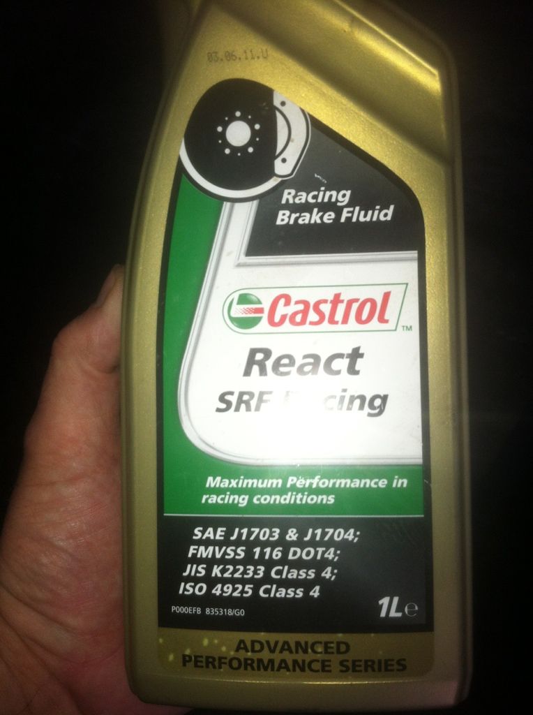

SoBeRS4 wrote: Sakimano, I drive the 08 model and I used to have the same issue. I solved it by swapping out the fluid with this stuff two years ago:

Id been having sticking clutch pedal issues, yet after a flush from std Audi spec fluid to RBF600 it seems to have disappeared. I've tried VERY hard to recreate the circumstances during which i'd had problems and to date it's been fine.
I wonder if anyone with aftermarket brake/clutch fluid has had clutch issues?

RS4pete wrote:Id been having sticking clutch pedal issues, yet after a flush from std Audi spec fluid to RBF600 it seems to have disappeared. I've tried VERY hard to recreate the circumstances during which i'd had problems and to date it's been fine.

Just gave that a try and it stuck down, worse than ever before. I wonder if bleeding the clutch with fresh fluid would help?

I don't think it's fluid
