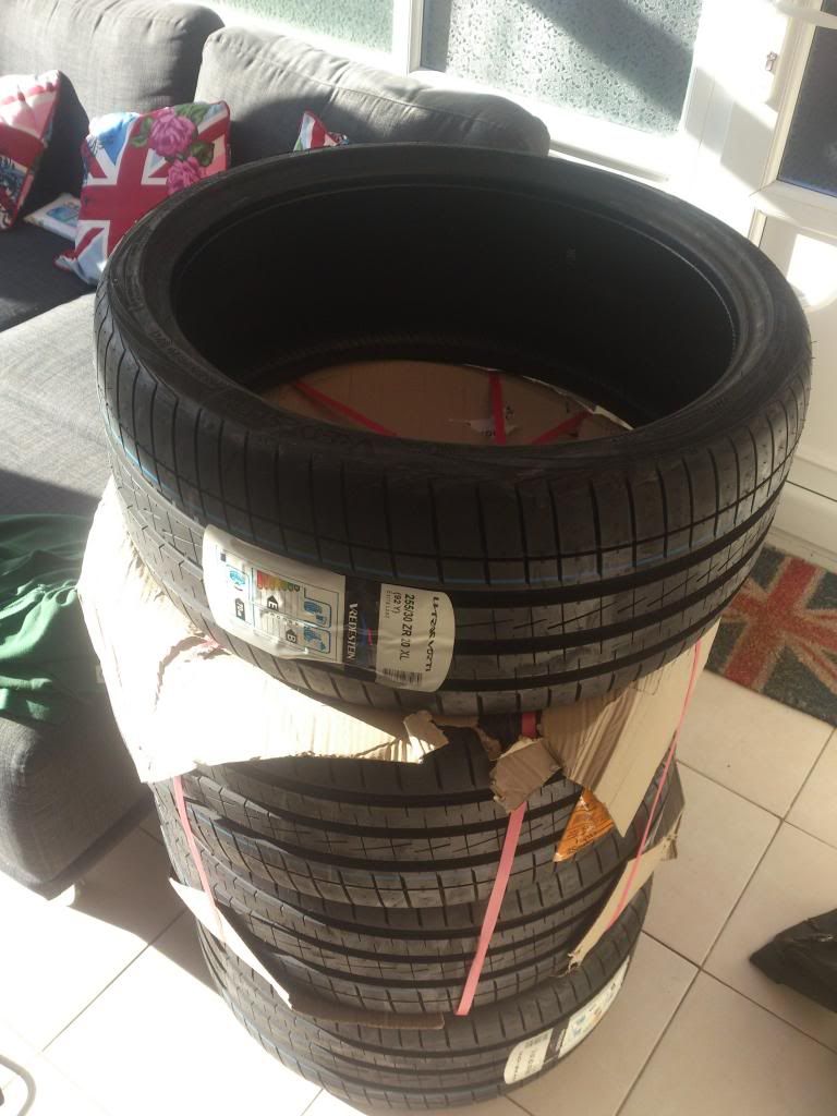

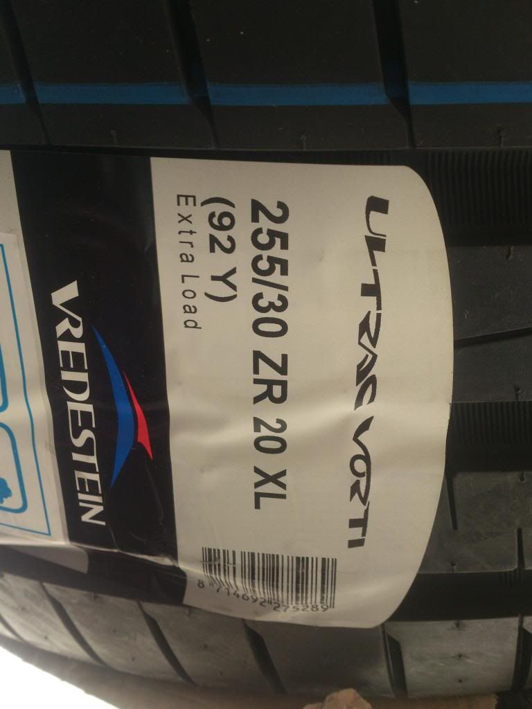

Post by Rick_RS4 » Thu Nov 07, 2013 3:12 pm
so today these turned up
ready to go onto the new wheels tomorrow,
dont get too excited they have been done before so nothing new in affraid.
Re: My Rs4 Project
Post by MikeFish » Thu Nov 07, 2013 3:23 pm
Can't wait to see them on rick. Will look a bit different as you have the right size tyres so will look lower profile.

great ill try them on tomorrow and see how it goes, 255 30 20 are the same rolling radius as the 25535 19s so should be ok hopefully, balls hope i can get some spigots local tomorrow do you know what centre bore i need.?

Yes 255/30/20 is identical to 255/35/19. 265/30/20s are a bit higher though.
The B7 has a centre bore of 57.1 and the RS5 / B8 has a centre bore of 66.6

Post by PetrolDave » Fri Nov 08, 2013 7:29 pm
Rick_RS4 wrote:255 30 20 are the same rolling radius as the 25535 19s
No they're not - the sidewall height of the tyre is the same (255*35/100) but as the wheel diameter is 1" (25.4mm greater) the rolling radius will be 12.7mm greater.
Try typing the numbers into any of the many online tyre size calculators such as http://www.etyres.co.uk/tyre-size-calculator

Dave I've done this calculation loads of times and it has always come up the same.
Re: My Rs4 Project
Post by MikeFish » Fri Nov 08, 2013 7:37 pm
Just done it again and still the same. Are you sure you changed the profile size and diameter when you did the calcs? In my experience if you keep the width the same and go up an inch in wheel size then a drop in profile (by one size) will give you an identical rolling radius so 255/35/19 must be the same as 255/30/20.
PetrolDave
Posts: 7599
Re: My Rs4 Project
Post by PetrolDave » Fri Nov 08, 2013 7:40 pm
MikeFish wrote:Just done it again and still the same. Are you sure you changed the profile size and diameter when you did the calcs?
My bad - I left the profile at 35 :bowdown:
