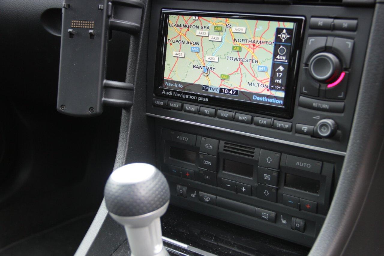

2010+ fitted to my rs4 - about 1 hours work to replace the surround - i left the screen surround as it has the piano black trim.

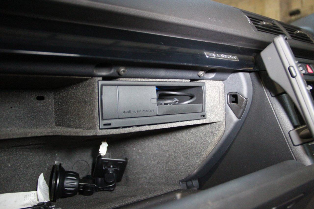

Now you've got a 2010 spec RNS-e, you can connect up the Audi iPod interface and fit the 'dock' and cable in the glove box in place of the CD changer (if fitted) - part number 8P0 057 785 (A3 part number).
Not cheap at about £300 but it'll do everything, with all track info etc that's so missing from the 'old' RNS-e iPod hookup.

Depends what you mean by a "How To"?Doug_S2 wrote:Is there any how to's on getting the full ipod/ami connected to the rs4s?
It really is as simple as I said above - the AMI is a mechanical direct fit in the CD changer slot in the glovebox, and only has 7 wires - 3 for the audio that go to the 32 pin AV connector in place of the Aux In (pins 6, 21 and 22), 2 for power that splice onto the power wires in the D connector (pins 12 & 15) and 2 for CAN Hi & Lo that splice onto the CAN wires on the D connector (pins 9 & 10).
BTW all the RNS-E pinouts are on a paper label on top of the RNS-E.
AMI Pinouts
1 Terminal 31 - to RNS-E pin D12
2 CAN Lo - to RNS-E pin D10
4 NF Right - to 32 pin connector pin 6
7 Terminal 30 - to RNS-E pin D15
8 CAN Hi - to RNS-E pin D9
9 NF Left - to 32 pin connector pin 22
10 NF Ground - to 32 pin connector pin 21

That's the part number for the AMI unit - 8P0 057 785 is what I've fitted.DALO wrote:Now you've got a 2010 spec RNS-e, you can connect up the Audi iPod interface and fit the 'dock' and cable in the glove box in place of the CD changer (if fitted) - part number 8P0 057 785 (A3 part number).
It's a whole lot more than just an iPod interface...

There's 3 parts you need:sakimano wrote:Could you estimate the total cost of going AMI with RNSe2010+ (AMI, other parts) and give the install a rating on a scale of 1 to 10, compared with say an RNSe to RNSe 2010 swap (which many of the guys in this thread have done, thus will be a good benchmark, difficulty wise).
- the AMI unit, 8P0 057 785
- the cable, as there isn't a B7 cable I got the B8 cable 8K0 051 592
- the 32-pin AV connector shell
Total cost was £373.60 in October 2009 (yes the parts have been sitting in my study for 2 1/2 years!).
If the RNS-E to 2010 RNS-E swap rates a 4, I'd rate this as a 3. There's nothing as complicated mechanically as swapping the front panel, and the only coding change is to the RNS-E, but there is some wiring to do. So if you're mechanically minded it will be harder, but if you're electrically minded it will be easier.

The drive needs to be formatted FAT32, which Windows can't do (due to a stupid unnecessary limit imposed by M$ of 32GB maximum on a FAT32 drive) so you either need to get a pre-formatted drive or download a proper FAT32 format program..DALO wrote:If my thinking is correct, by PetrolDave plugging the Audi HDD into his AMI, the AMI is simply seeing it as a big USB memory stick, so any standard HDD should work in the same way, provided it's been formatted correctly. If I'm correct, then you can pick them up for less than £50 - if I'm wrong (Dave may jump in here) then the Audi branded one that Dave can be had for about £65.
I got the 250GB drive from an Audi dealer off eBay for £60, and you can also get off eBay a 500GB from Audi dealers for around £80.
Plus you need an AMI to mini-USB cable - 4F0 051 510 H - which I also got from an Audi dealer off eBay for £25.

Having fitted the 2010+ RNS-E AMI I'm now selling the glovebox CD changer, and the pre-2010 RNS-E (it's the H version with SDS):PetrolDave wrote:Well I finally got round to doing 2 things today:
2) swapping the glovebox CD changer to the 8P0 057 785 AMI that I had bought over a year ago - which does work.
AMI unit in the glovebox, with hard drive in the drawer :
See http://forum.rs246.com/viewtopic.php?f=64&t=98310 for the CD changer and http://forum.rs246.com/viewtopic.php?f=64&t=98309 for the RNS-E.
