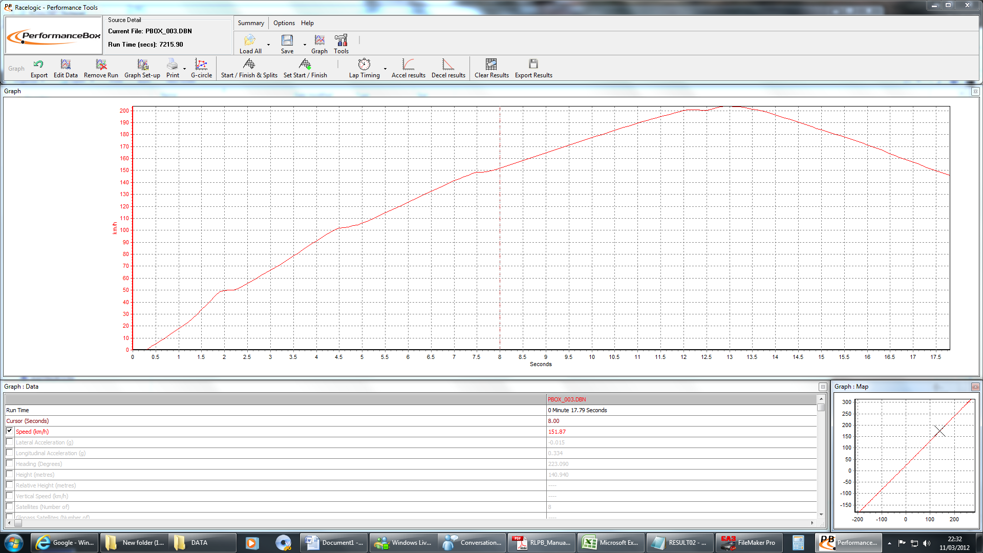

Post by Doug_S2 » Sun Mar 11, 2012 11:40 pm
I don't really care about the times at the pod as it is pretty obvious a skilled driver or the dsg cars would do a lot better time. But the trap speeds are what shows the power. We would not have got a faster speed as it was on the limiter in 4th. You can see from gear changes they are nothing special and I can't change gear faster than Stuart.
Like I have said all along - these cars have the power - and a thrash or high rev race they are silly fast. From low revs a turbo car or a big V8 with 700nm at 2k gets the jump
Perfomance box logs:
Time 16:34 Date 10/03/2012
Accel results
Speed(mph) Time(s)
0-60 03.6
0-100 08.1
Accel Distance results
Distance() Time(s) @Speed(mph)
0-60' 01.9 34.6
0-1320' 11.7 124.6
0-60' 01.9 34.6
0-1320' 11.7 124.6
Braking results
Speed(mph) Time(s) Distance(ft)
60-0 13.3 289.5
100-0 18.7 911.5
User range
Speed(mph) Time(s)
30-130 ----
62-124 07.6
0-100-0 34.9
Misc
Vmax 126.6mph
Vavg 11.6mph
AvgLatG 0.02G
PkLatG 0.40G
PkAccelG 1.14G
PkDecelG 0.66

Post by sakimano » Mon Mar 12, 2012 8:20 pm
Doug_S2 wrote: the trap speeds are what shows the power.
Accel results
Speed(mph) Time(s)
0-60 03.6
0-100 08.1
0-60' 01.9 34.6
0-1320' 11.7 124.6
0-60' 01.9 34.6
0-1320' 11.7 124.6
User range
Speed(mph) Time(s)
30-130 ----
62-124 07.6
0-100-0 34.9
Doug thanks for posting that up. Was that file from Saturday at Santa Pod? Great idea to get the data while running.
Do you have the file saved? Would be nice to review it and submit to the 6speedonline guy for inclusion in the 62-124 list. You have an extra shift in there than you maybe ought to for best 62-124 results (2-3) but still looks strong. Car looks like it's moving very well. Congrats to you guys.
p.s. does anyone have danny's full modlist?
exhaust?
downpipes? cats?
clutch/flywheel?
stock wheels?
I know he has ceramic brakes.
Here's some of the 6speedonline results for 62-124 (100-200kmh)
2.0 – Renault R25 F1 car (800+ HP / 1,300 lb curb weight)
3.5 – Hayabusa Turbo (316 HP)
4.8 – Veyron
5.3 – Koenigsegg CCX
6.1 - Mclaren F1
6.2 - Pagani Zonda F
6.4 - Carrera GT
6.5 – Pagani Zonda R
6.7 - Enzo
6.8 - GTB 599
7.2 - SLR
7.6 - TTS/MRC SC B7 RS4
7.8 - Murci LP640
7.9 - C6 Z06
8.0 - Ford GT
8.4 - 997TT
8.4 - F430
8.4 - 996 GT2
8.6 - M6
8.7 - SL65 AMG
8.8 - Gallardo Superleggera
8.8 - M5
8.9 - S65 AMG
9.1 - Gallardo SE
10.0 - E55 AMG
10.2 - 996 GT3
10.2- Viper SRT-10
10.5 - E63 AMG
10.8 - 993TT
11.2 - AM Vanquish S
11.2 - Audi RS-4 (2007)
11.3 - Audi RS-6
