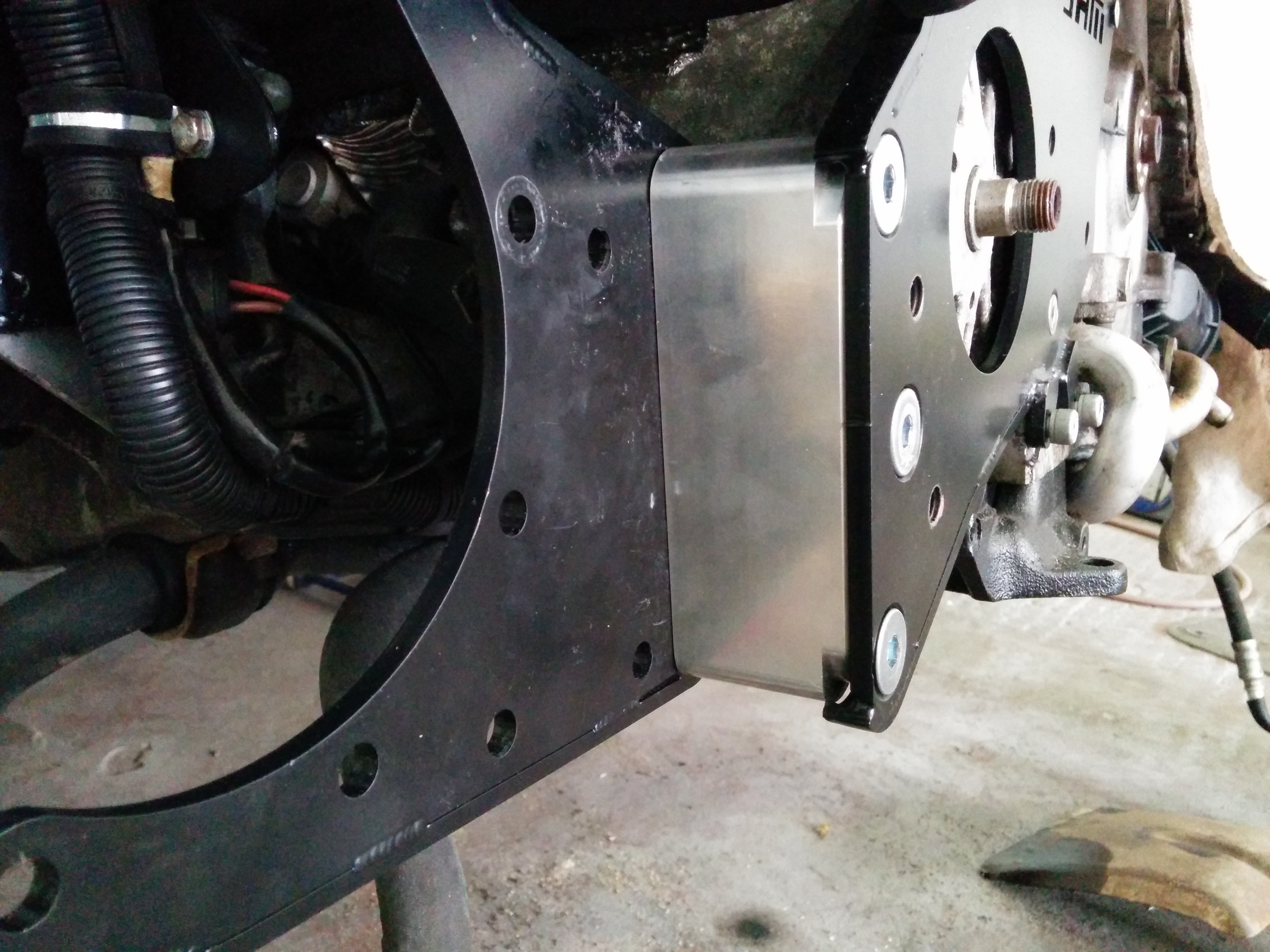

right back on it...

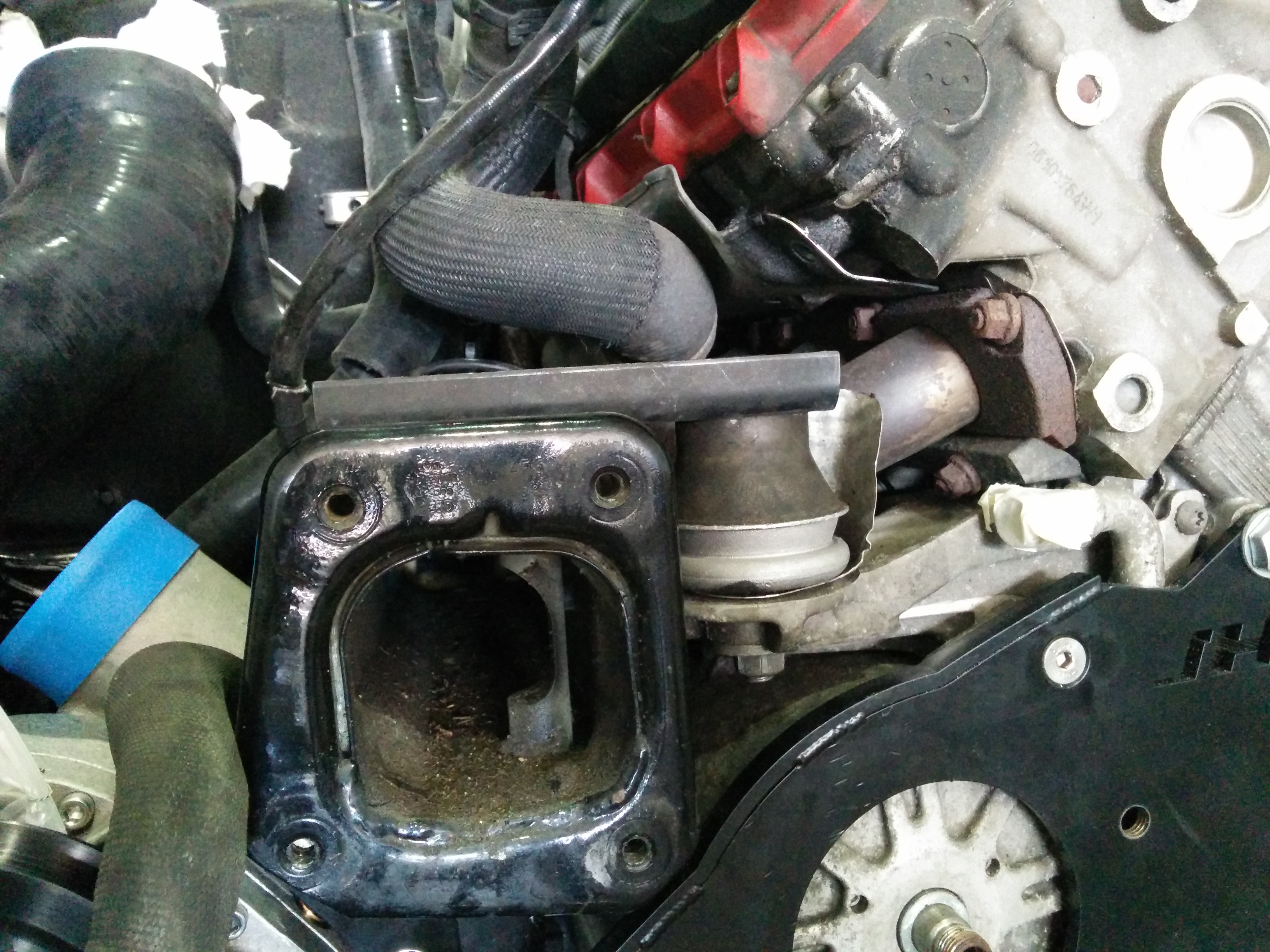

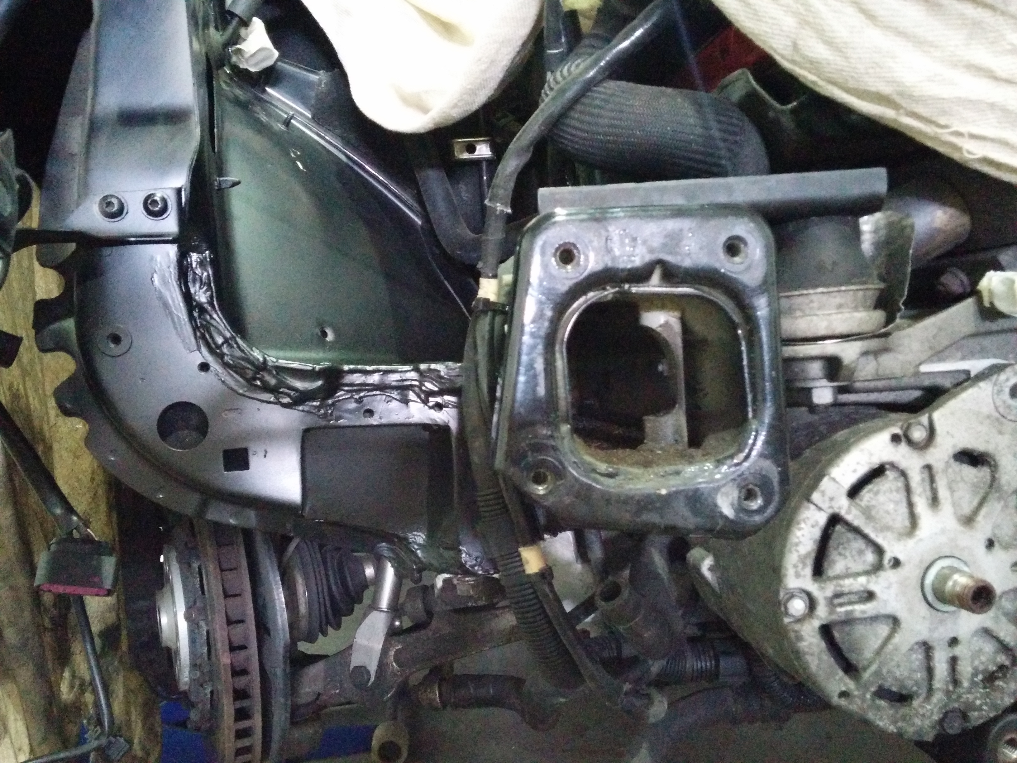

with the quick mock up done i could check for clearance issues between the charger and bodywork.

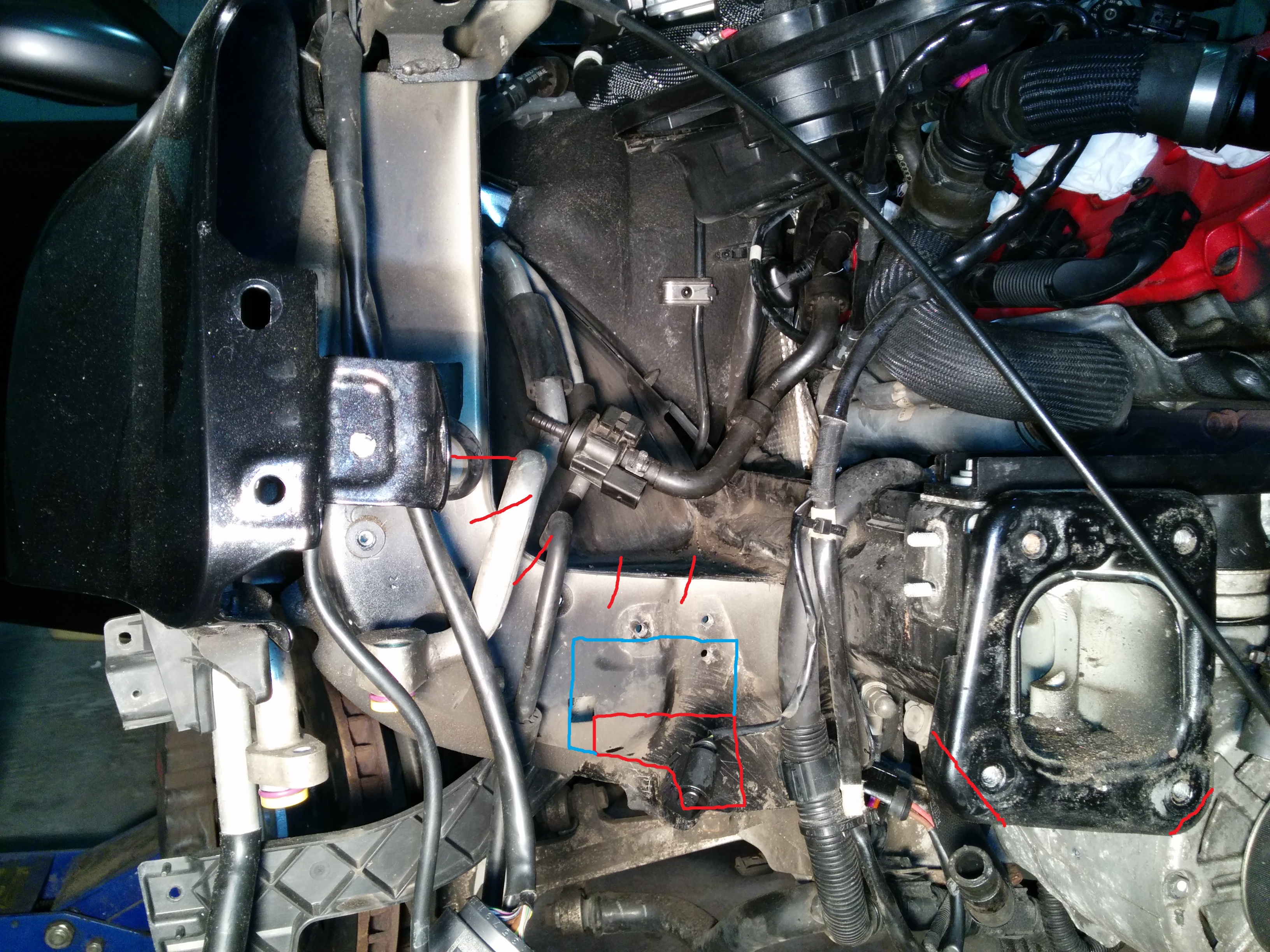

i was aware when i bought this kit that a few pieces of bodywork would need trimming due to the size of the charger and the limited room in the rs4's engine bay. jhm recommend trimming the bits in red in the picture below.
the red lines at the top of the picture are cuts in the lip that sticks out on the inner wing, these are then tapped flat with the panel below. if left as is these will saw through the intake and boost pipe in no time at all.
the cuts on the end of the bumper mounts are for clearance for the route the belt takes.
and the red square ish shape at the bottom of the pic is to provide clearance for the intake pipe where it attaches to the charger. jhm recommend trimming the metal, tapping back any sharp edges and sealing with paint.

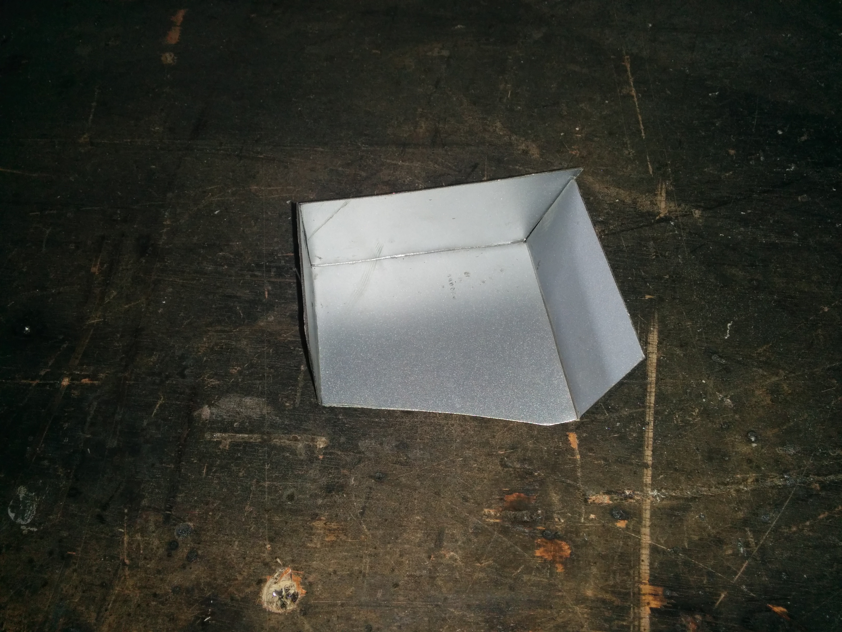

being a painter/bodyworker i decided rather than just chop out a bit and tap it back i would cut out a slightly larger area (the blue line on the pic) and let in a plate to finish it off. this is not necessary but i couldn't help myself.

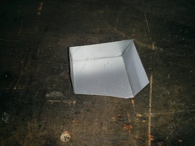

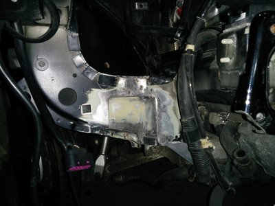

quick plate fabbed up. edge cut and tapped flat, plate welded in and ground up. sealed up, primed up and painted. with this done the only thing left to come in to contact with the charger is part of the engine wiring loom. this is fastened out the way using the now spare bolt hole from where the secondary air injection was removed.

WOW - sar, this is 'proper' job.
Nice work especially the fabbed up plate

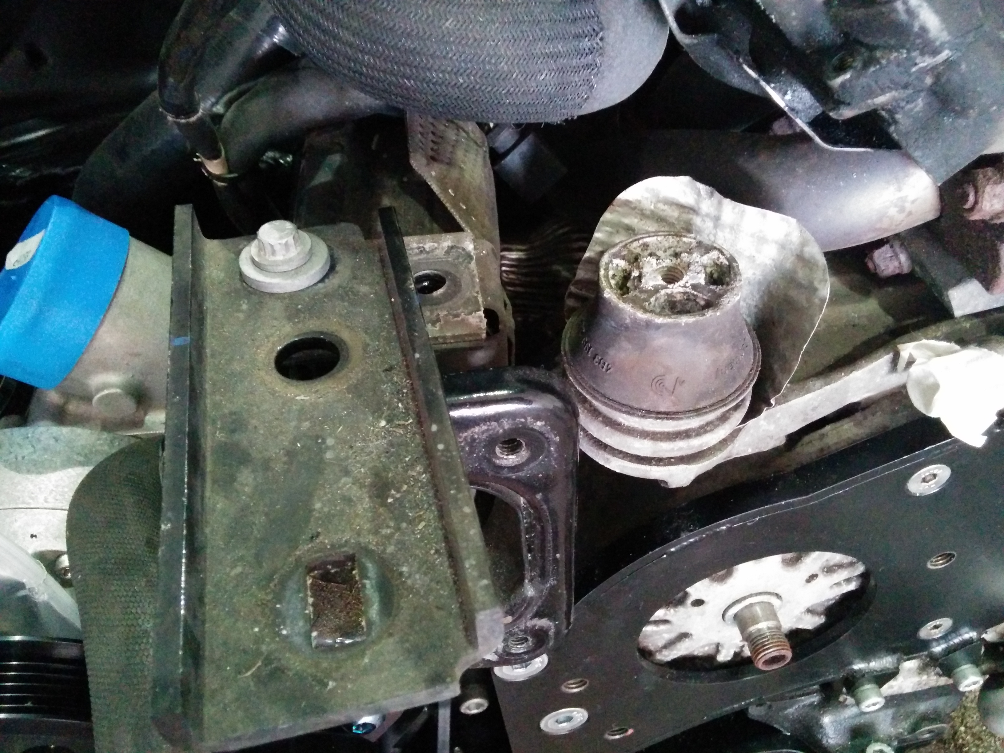

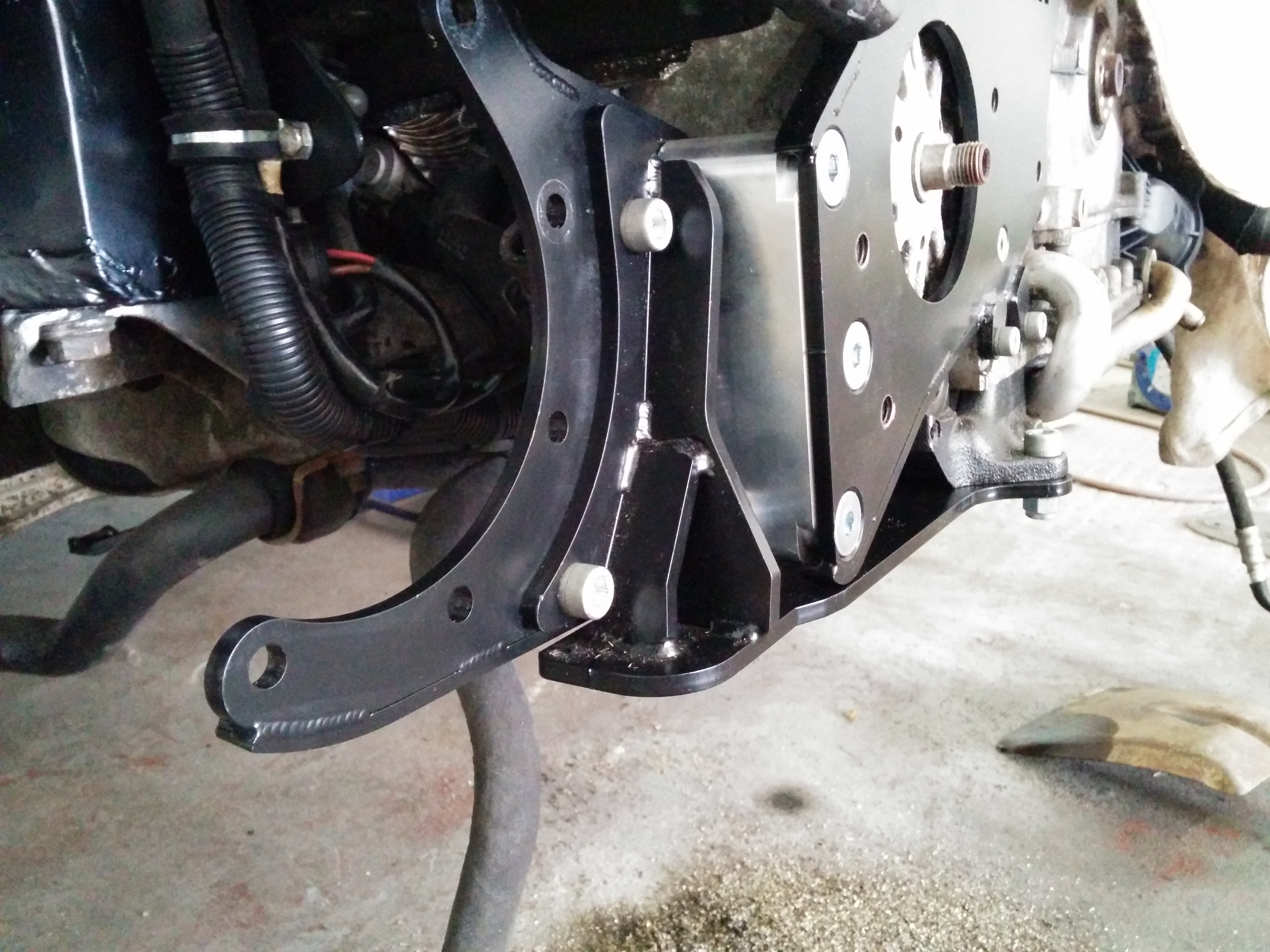

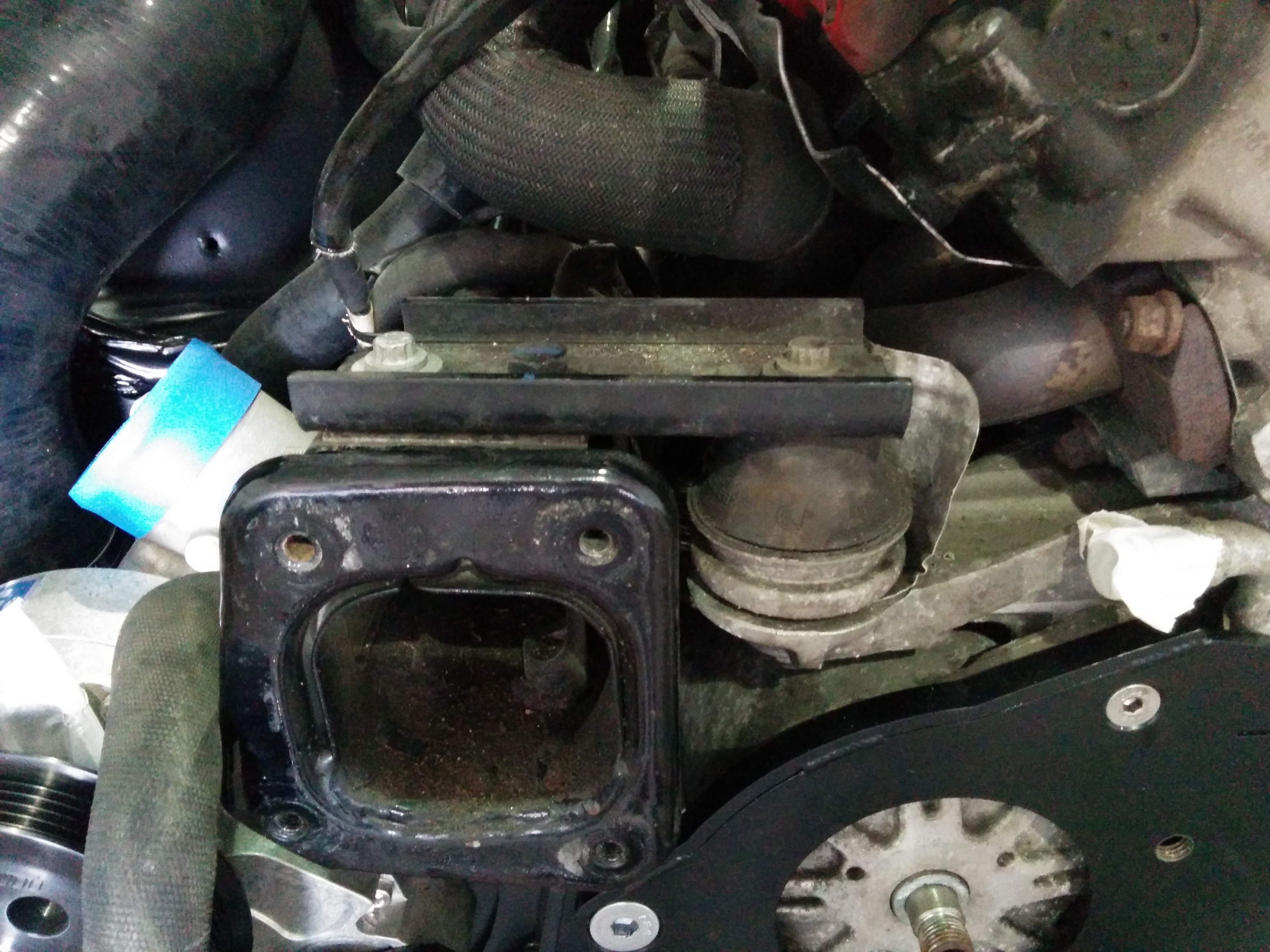

now the brackets for the supercharger can go on and be torqued up.
old torque mount, you can just make out the split. piece of cake to fit! as long as you have your front end stripped off that is. all done.
next up i fitted a new 034 motorsport torque mount, my original one is starting to split.old torque mount, you can just make out the split. piece of cake to fit! as long as you have your front end stripped off that is. all done.

man your plate work is brilliant, good idea...am loving the RHD build...this is going to be the ref point for us Saffa's and the Aussie's

This installation starting to look a lot more involved than I’d first imagined. Trimming the sub-frame / bodywork to make it fit ...and welding etc.. really ?
Awesome effort though, for doing it.
Re: JHM stage 1 supercharger kit
When have you ever bought a "bolt-on" part that simply bolted on ? Do agree that it is easy to be lulled into the "its a comprehensive kit" and underestimate the degree of mechanical skill expected of the installer.
So jhm say just cut the bodywork and flap it back? That's a bit poor.
However what you have done is awesome
I was quite surprised at this - cut and fold?
If you don't have sar's skills and equipment you kind of need to get that in or use your RS4 to 'practice' on. Yes, bolt-on means just that...

Funny, it's so minor. People cut holes in their FIREWALL to route reservoir lines for their coilovers. If you're iffy about using an angle grinder to cut an inch of superfluous metal off the car, you're not likely to get a catback exhaust never mind a a supercharger.
sakimano wrote:Funny, it's so minor. People cut holes in their FIREWALL to route reservoir lines for their coilovers. If you're iffy about using an angle grinder to cut an inch of superfluous metal off the car, you're not likely to get a catback exhaust never mind a a supercharger.
i dont mind cutting it maybe looks more of a cut than it actually is,
