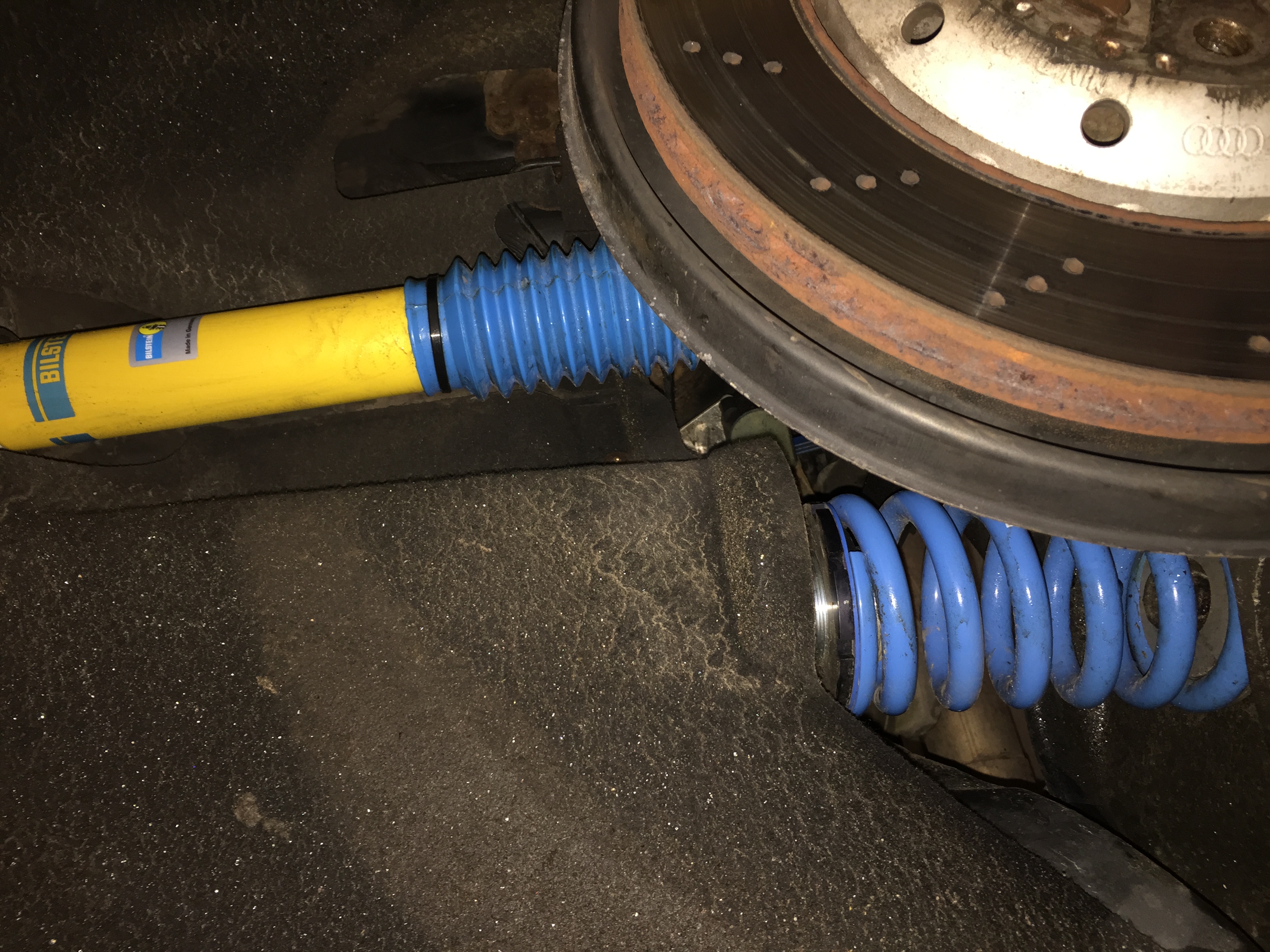

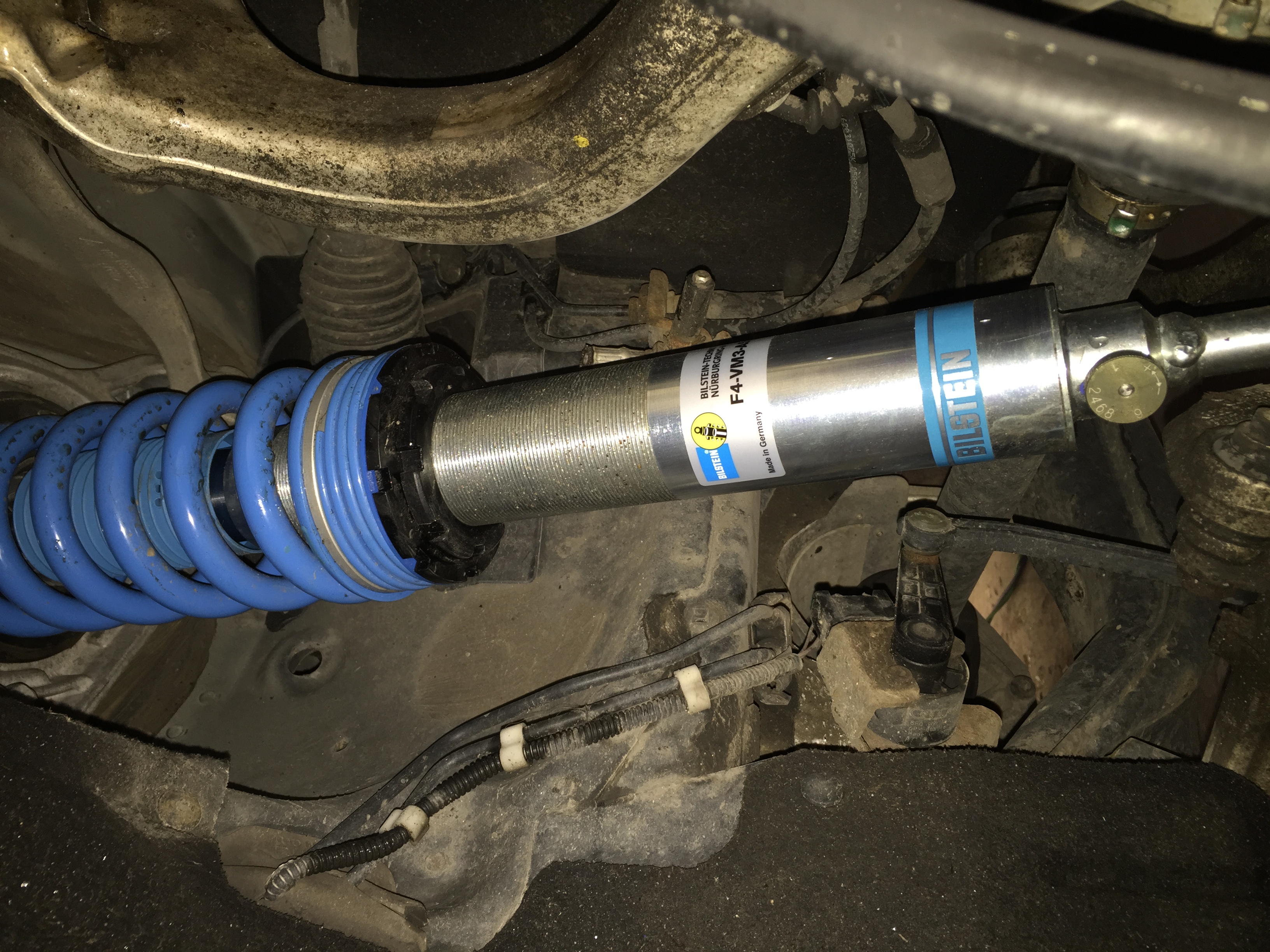

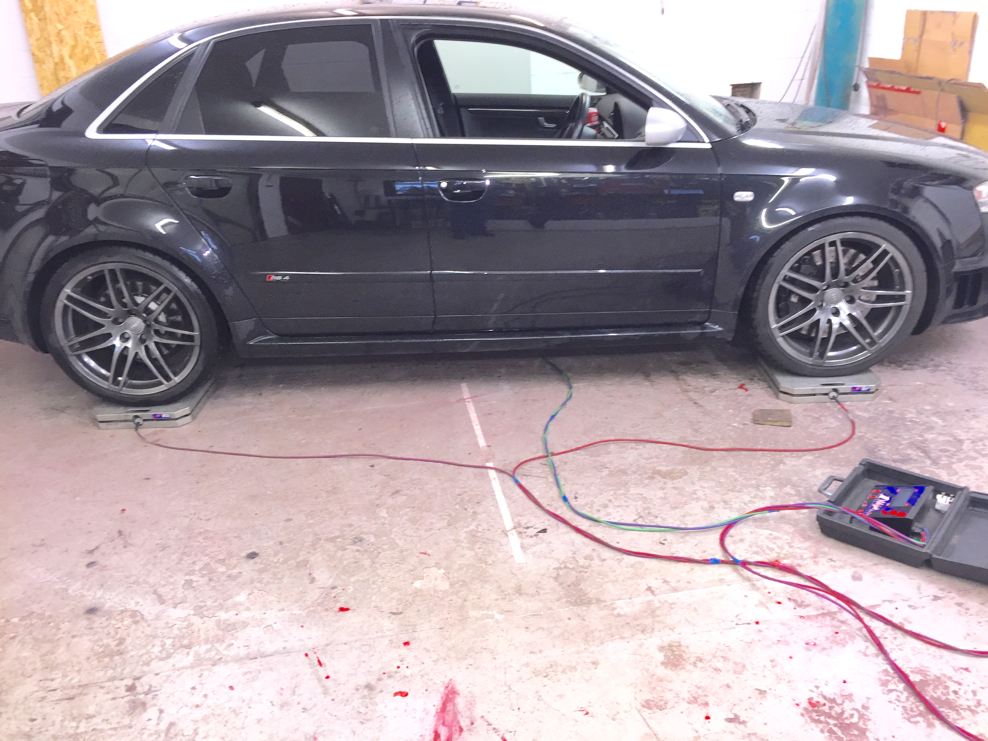

Another update, I now have the Bilsteins fitted and went to pic up the car from where they were fitted , i asked the Indy to just set them to roughly the height the originals were and set them to soft setting as i,m setting them up myself and corner weighting it with the scales we use for the rally car , so after about 50yds( on a country road) I could instantly feel the car was clearly stiffer but still compliant on even harsh bumps , but the handling difference is in a whole different league! I was beetling along on a road I know reasonably well and was slowing down to negotiate bends at speeds normally drive them at , and was shocked , was driving round them like they wern,t there almost No pitching or bouncy feel its just planted , in fact I got such good feedback through the suspension i was nailing it through the bends with no trouble at all and was a bit worried actually , thinking ...this isnt right lol , i,m well chuffed !! and the setting are all on 9 which is soft so still need to play a bit with them
i,ll post some pics of them on the car when we set it up , At the moment the rear is a touch lower than originally and the front is a bit lower than the rear so ill bring it up so they are level and will be altered to how i feel is best

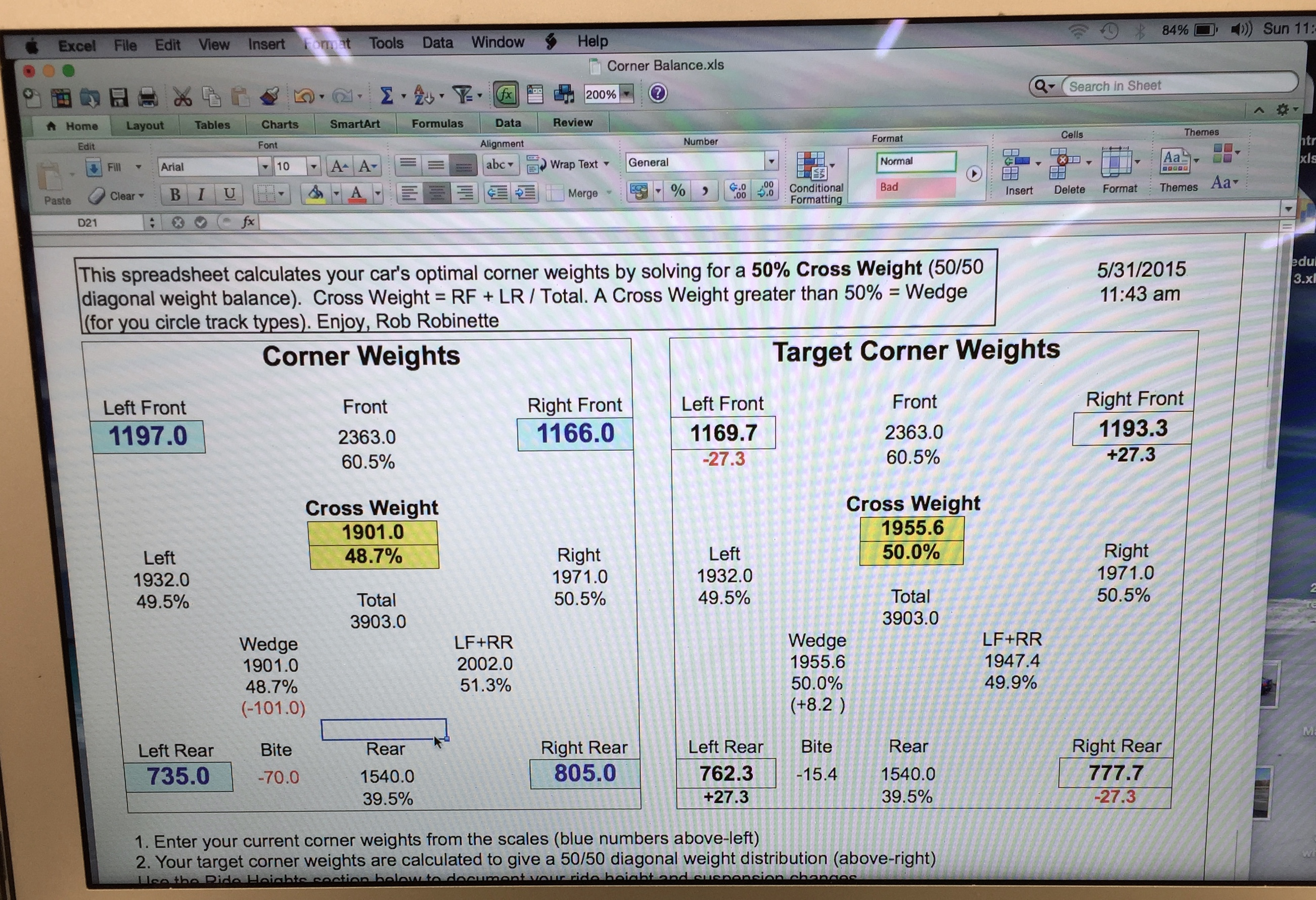

interestingly i thought the F/R weight distribution was better than i expected , approx 60/40 , so even with that big lump in front of the driveline ,Audi did a good job of lightening eveything as much a possible to get it that good
So after setting it up , i took it out the back roads and played around with the settings back and forth on the same twisty road section , i ended up with the fronts on setting 5 (soft is 9 hardest is 1) and the rears on 3 , on the softest setting i had a little roll when pushing hard in bends and a tad lightness if lifting off on entry to the bends (it did that with DRC too ), with changed settings up the car was pretty flat and planted in the bends and the rear was improved too , so thats where it is at now and TBH i dont notice it any harsher at these settings in the town , so i,ll get some miles on it to see if it settles any , then do final adjustments later

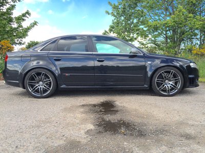

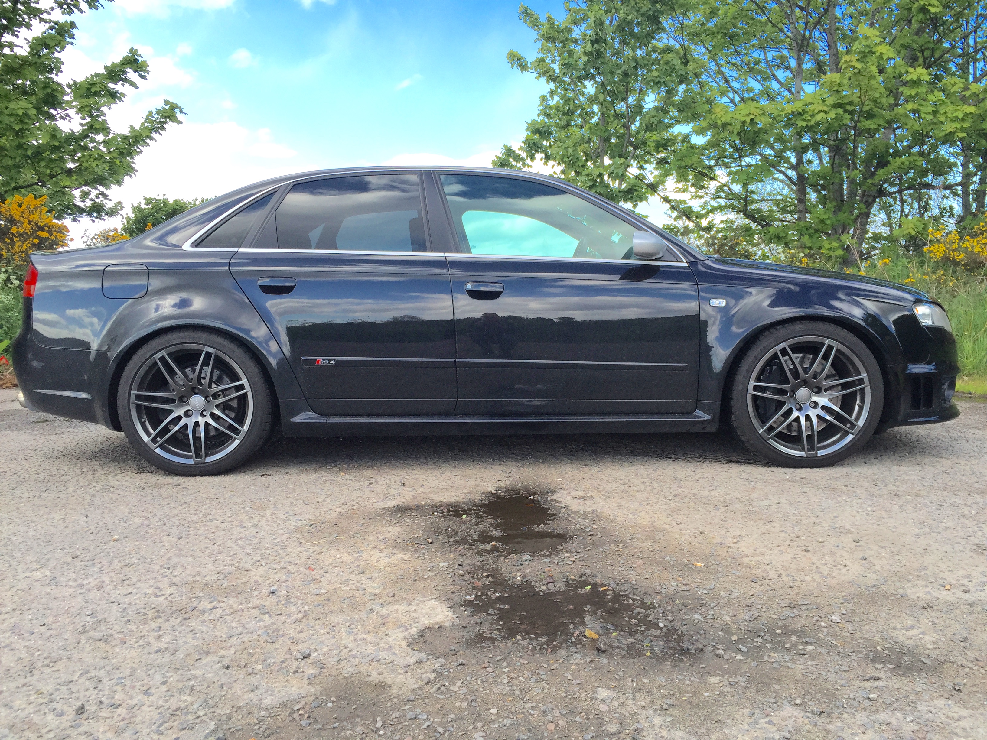

Interesting read! So in that final pic, the car is at 660-665mm wheel to arch all round?
2007 RS4 B7 Avant
- Posts: 533
- Joined: Tue May 03, 2011 10:55 am
- Location: Scotland somewhere
Re: Spend 2K to keep DRC or fit coilovers ?
yes it is that measurement in the final pic but only about 30 miles on it by then so i,ll check them again in few weeks to see how much its settled if any
Looks lower than 66cm! Good stance
