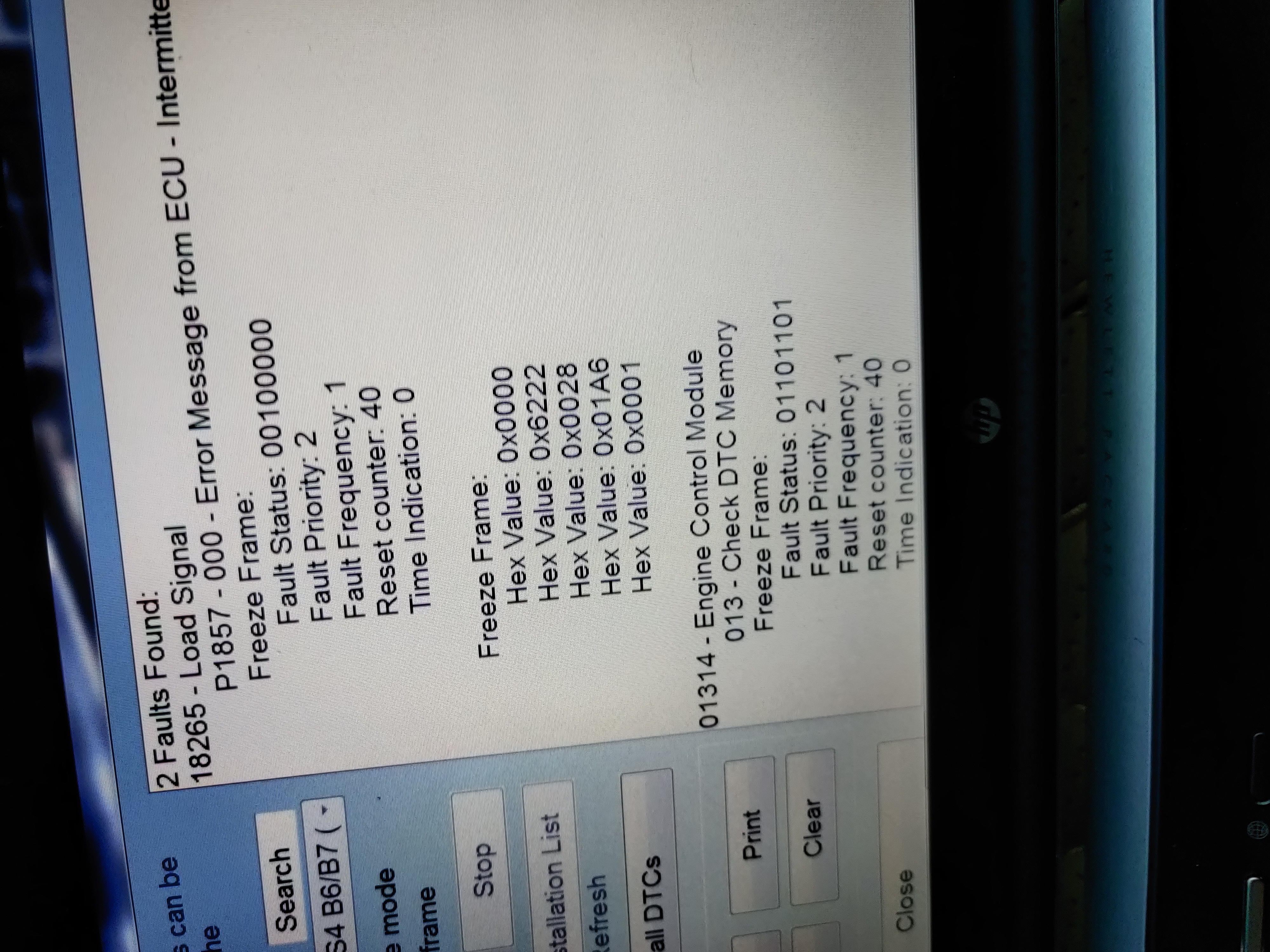

Hi all.
New to this forum...
Having some problems lately....
Esp light on, after fiew attempts of switching the car off it goes away untill next morning...

Well i wouldnt ask here if i could find an answer just googling it :lol: already replaced maf and checked the switch and it works as it should (not sticking or anything) ...

It just showing esp, recently changed couple bits but it still throwing the esp fault... noticed one more thing, it kinda looks like there is a patern on how the fault coming out... im afraid it might be ecu’s
