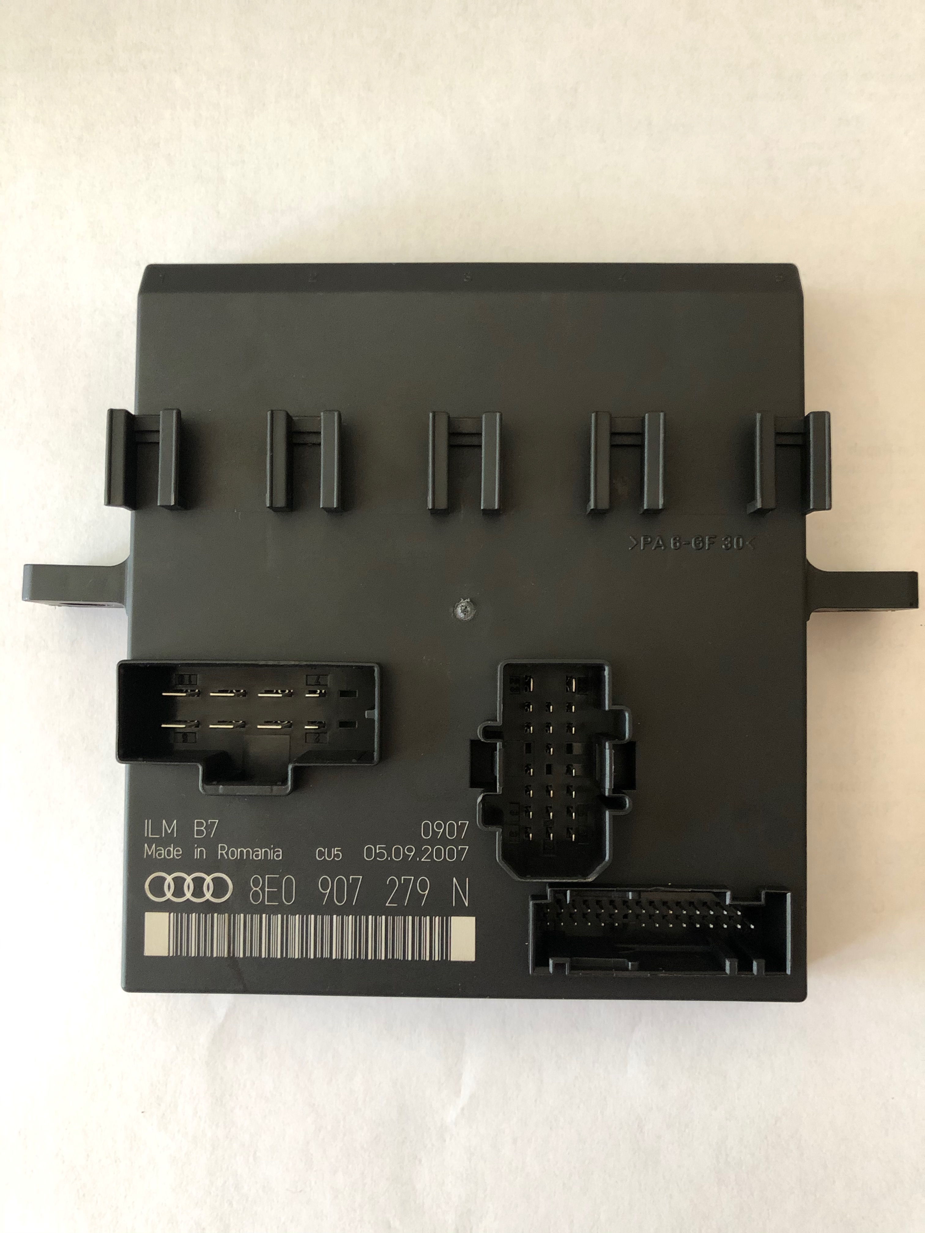

Body Control Module - 8E0907279N
In the repair manual, this is called the “Vehicle Electrical Control System Module”, but it’s more commonly Called the Body Control Module or BCM. This black box manages power to lots of stuff in the car, including all of the critical lighting. You can modify the one you have already, or you can get another one. The thing is almost $1k from Audi, but I got one on Ebay for $25, and it worked just fine. I wasn’t sure if was going to wreck my BCM in the process of figuring this out, so I wanted an extra. I believe the BCM is the same for the B7 A4/S4/RS4, but I haven’t confirmed that.
Here’s a picture:

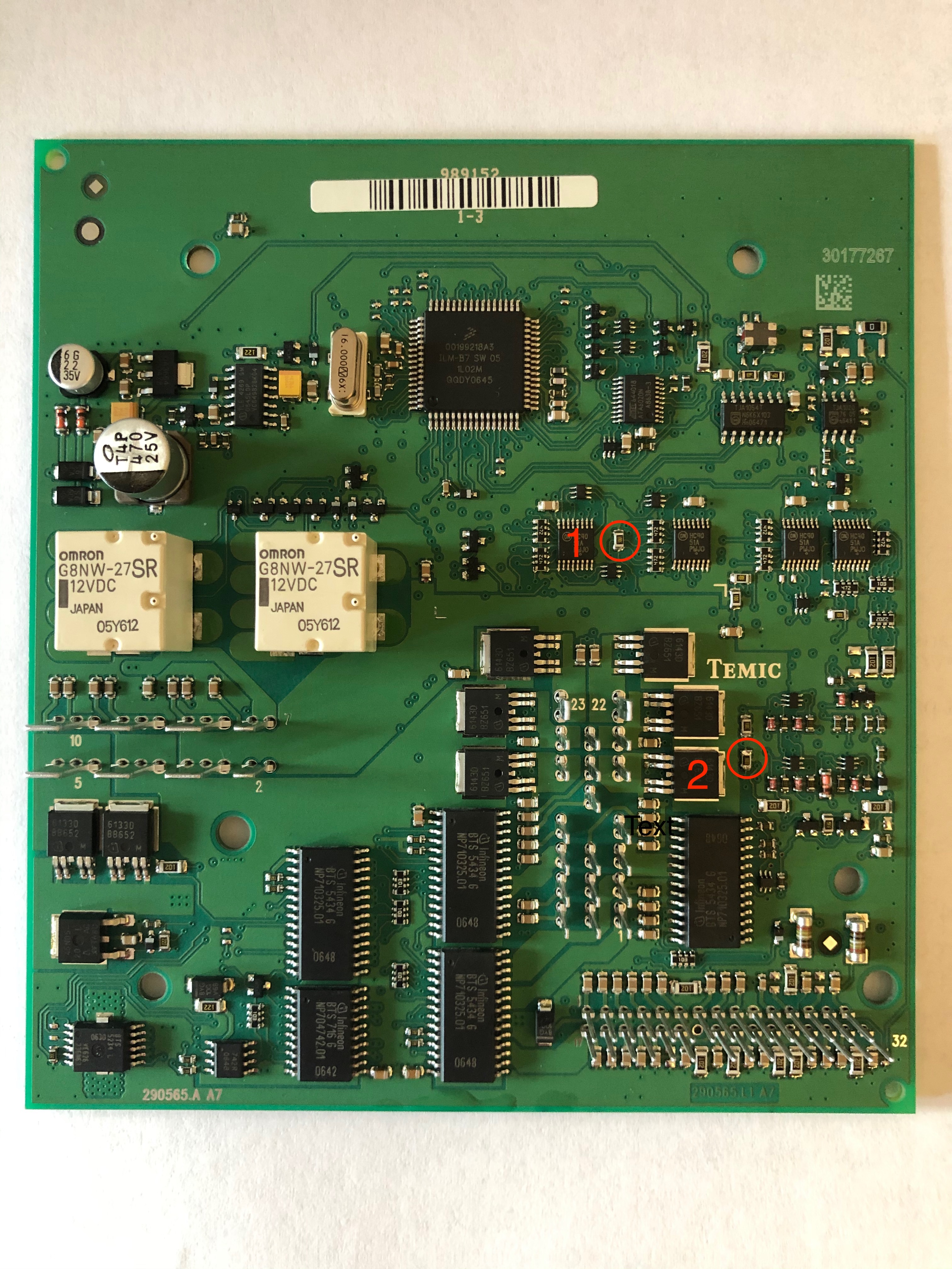

Here’s how it works: The DRLs are each driven by an Infineon BTS6143D smart switch. The switch sources a sense current - that’s somewhat proportional to the load current - into a 3kohm resistor. This generates a voltage that the BCM measures to see if the DRLs are drawing enough current to look like good bulbs. Increasing that sense resistor makes the load current look larger. I measured the current draw of my LED DRLs at 165mA. The actual bulb current is more like 1.9A, so replacing the 3kohm resistor with 30kohm makes the LED “bulb” look like an incandescent to the BCM.

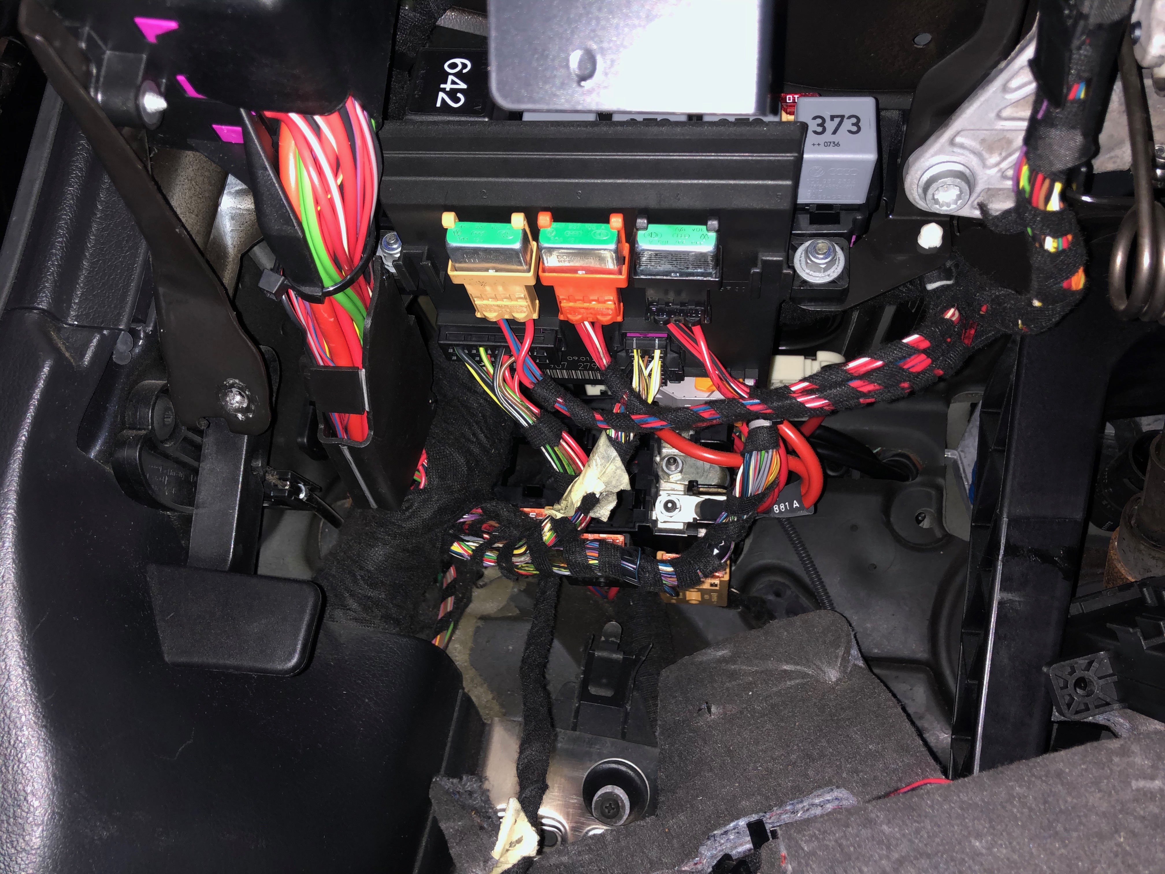

First, you have to get to the BCM. It’s to the lower left of the steering column, behind the “driver’s storage compartment”:

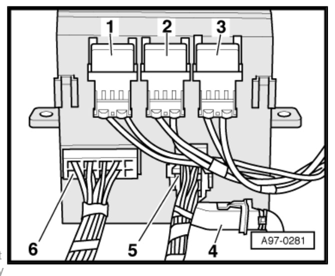

You have to remove the instrument panel cover (1), and screws (2) and (8) to get the compartment (9) off of the dash. You do NOT need to remove the supports (4) and (7). Now you’ll see the BCM down to the left of the steering column:
There are two nuts holding the BCM in place, and you’ll need to remove the fuse block to get to the one on the left. The connector are fairly straightforward to remove, and you can disconnect them without removing the BCM if you want to test a second one before fully removing the first.
(6) has one latch that you squeeze while pulling, (5) has two latches, and (4) requires that you depress a locking tab and pull up the orange lever to pop the connector out. The fuse blocks attached to the BCM (1, 2, 3) are a bigger pain. They slide off in the “upwards” direction in the picture, but you have to push down a latch beneath them from the “downward” side to release them. You’ll see the latches if you look in there, and there’s enough slack in the fuse block wiring to turn the BCM around and get to them.
Once the BCM is out, remove the four screws in the back and take it apart to get to the circuit board inside:
The two resistors you’re replacing are circled in the picture (you'll have to zoom in). (1) is for the left DRL, and (2) is for the right DRL. You’ll need a fairly small soldering iron and some small solder. Surface mount soldering is outside of the scope of this post, so I’ll just say: replace those two resistors with 30.1kohm resistors. I picked that value because it was a simply 10x the original, but it isn’t super critical. If you have something a little bigger around, it should be fine. I spent a good bit of time deciphering the Audi wiring diagram and probing around the board on the bench and while it was powered in the car in order to determine that these resistors were definitely what I was looking for.

I ended up replacing two resistors: I replaced (1) with 10kohm, and (2) with 30.1kohm. Note that (1) is the lower resistor of the two shown near my red oval, and (2) is the middle resistor in the group of three near its oval.
Since these two sense resistors are shared with other loads, besides the parking lights, I sort of guessed at what would be reasonable values. So far, this modification has worked - both parking lights turn on and stay on, and I don't get any error codes. I used these LEDs: https://www.amazon.com/gp/product/B07DTD4Q3R/.
These resistors are physically smaller than the ones used for the DRL sense lines - they're 0605, rather than 0805. 0605 is sort of a weird size, so I just used 0603s - which fit no problem. Here are some examples:

Based on the wiring diagrams, I believe that resistor (1) is shared with the license plate bulbs, so it's possible that changing it as I suggest here will also allow you to swap out your license plate bulbs for LEDs. I haven't tried, but at worst it may just require a higher value resistor. Resistor (2) is shared with the high-mount brake lights, which are already LEDs.
As with the mod for the DRLs, this works in my '08 North American RS4, but I don't know if it will work in Europe, since there's a variation in the wiring diagram that definitely doesn't represent my RS4 (I verified my connections with a multimeter and lots of wire). However, if the European cars are represented by the other variant in the diagram, then it's possible that only changing resistor (1) will allow both parking lights to work with LEDs.
Fog Light Modification Update
Based on the wiring diagram and some probing around the BCM circuit board, I believe I've identified the two resistors that should be replaced to allow for LED fog lights:
They're both currently 3kohm, so I'm guessing that replacing them with 30.1kohm (as was done with the DRLs) will do the trick. I don't plan on making this modification myself, at the moment, so please add to this thread if you learn that this modification works.
Here’s a picture:

I've been running with this modification and LED DRLs since I made the original post, and haven't ever seen any errors on the dash. So nothing about driving or using the car has been any different. If I run a VCDS scan, I get the fault "01794 - Control Module - Incorrect Chassis (VIN) Number " - which makes sense because I replaced my body control module with one from Ebay. If I were to go back and modify the original and use it, the fault would go away. But I'll probably never do that since it has no effect on my use of the car, and if I sell the car someday, I want to be able to provide the original control module. I haven't looked into writing a new VIN to the control module, so that might be possible.
