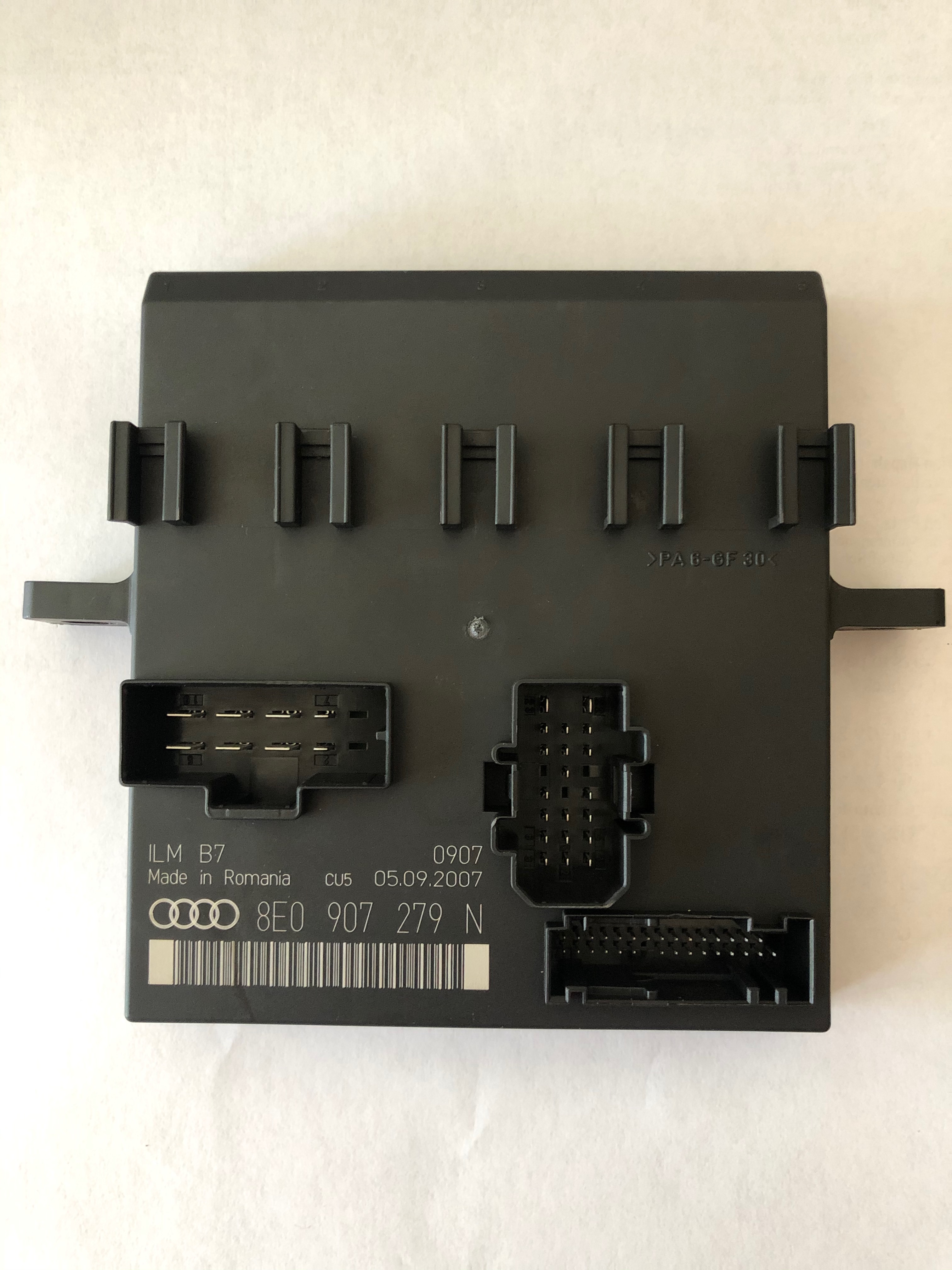

I got my ’08 RS4 five months ago, and I installed LED daytime running lights along with big power resistors to fool the diagnostics into thinking that regular bulbs were still present. Now….fast forward a few months, and I’ve obtained European headlights to replace the originals, which are full of moisture. I couldn’t bring myself to splice into the wires in my nice new headlights, so I decided to look for a way to fix the problem at the source - and succeeded. Since I do a lot more reading than posting in forums like this, I figured it was high time I shared. I think I’ve included everything here that you need to know to repeat what I’ve done. It worked on my RS4, but I’m assuming that it’ll also work on the B7 A4 or S4, provided that they all use the same BCM - which I think they do.
First, some relevant parts:
Body Control Module - 8E0907279N
In the repair manual, this is called the “Vehicle Electrical Control System Module”, but it’s more commonly Called the Body Control Module or BCM. This black box manages power to lots of stuff in the car, including all of the critical lighting. You can modify the one you have already, or you can get another one. The thing is almost $1k from Audi, but I got one on Ebay for $25, and it worked just fine. I wasn’t sure if was going to wreck my BCM in the process of figuring this out, so I wanted an extra. I believe the BCM is the same for the B7 A4/S4/RS4, but I haven’t confirmed that.
Here’s a picture:

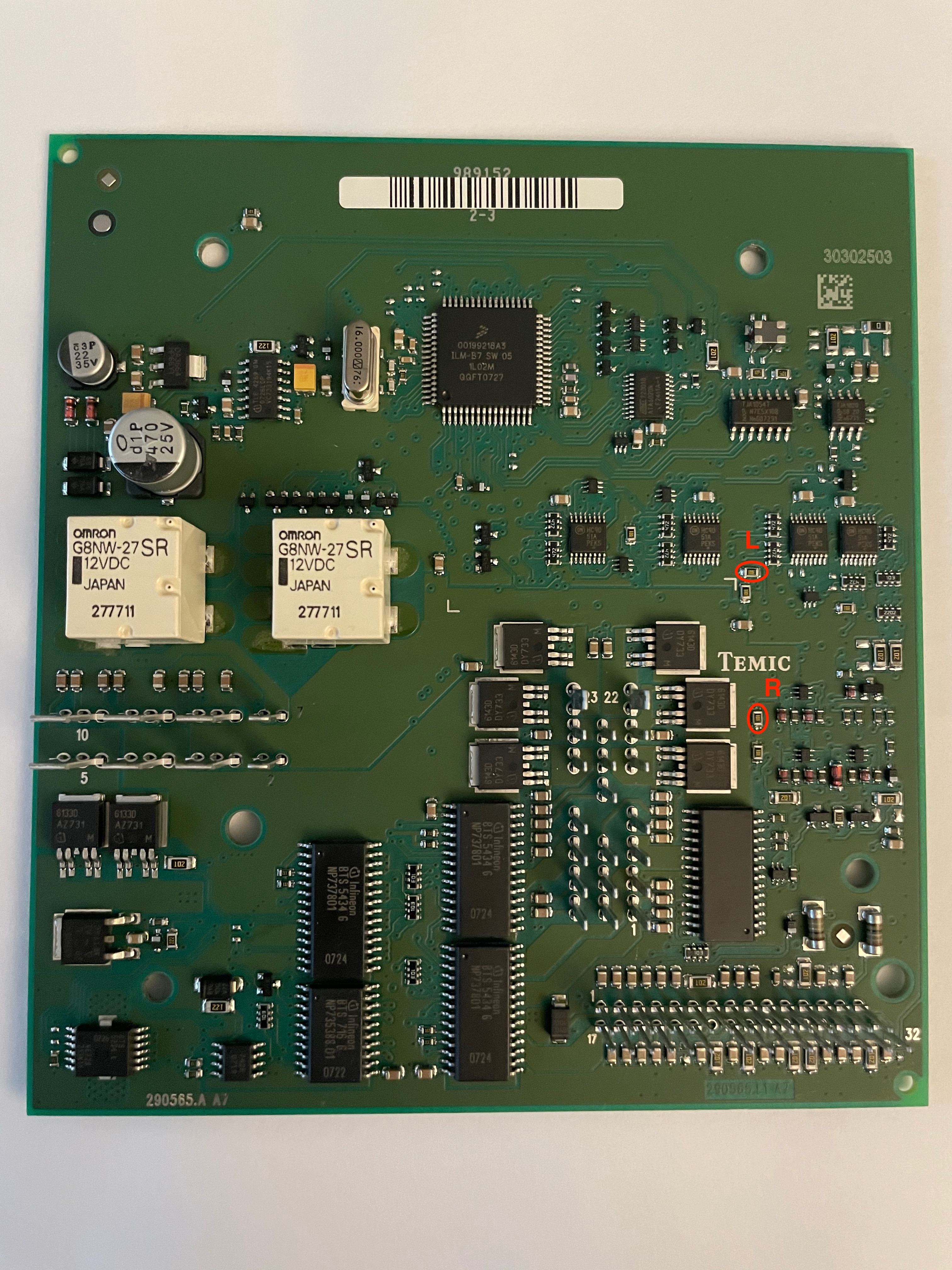

Here’s how it works: The DRLs are each driven by an Infineon BTS6143D smart switch. The switch sources a sense current - that’s somewhat proportional to the load current - into a 3kohm resistor. This generates a voltage that the BCM measures to see if the DRLs are drawing enough current to look like good bulbs. Increasing that sense resistor makes the load current look larger. I measured the current draw of my LED DRLs at 165mA. The actual bulb current is more like 1.9A, so replacing the 3kohm resistor with 30kohm makes the LED “bulb” look like an incandescent to the BCM.

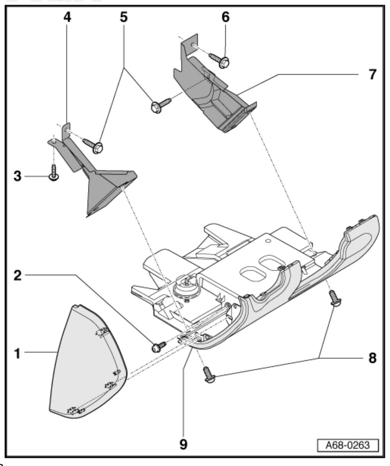

First, you have to get to the BCM. It’s to the lower left of the steering column, behind the “driver’s storage compartment”:
You have to remove the instrument panel cover (1), and screws (2) and (8) to get the compartment (9) off of the dash. You do NOT need to remove the supports (4) and (7). Now you’ll see the BCM down to the left of the steering column:
There are two nuts holding the BCM in place, and you’ll need to remove the fuse block to get to the one on the left. The connector are fairly straightforward to remove, and you can disconnect them without removing the BCM if you want to test a second one before fully removing the first.

Once the BCM is out, remove the four screws in the back and take it apart to get to the circuit board inside:
The two resistors you’re replacing are circled in the picture (you'll have to zoom in). (1) is for the left DRL, and (2) is for the right DRL. You’ll need a fairly small soldering iron and some small solder. Surface mount soldering is outside of the scope of this post, so I’ll just say: replace those two resistors with 30.1kohm resistors. I picked that value because it was a simply 10x the original, but it isn’t super critical. If you have something a little bigger around, it should be fine. I spent a good bit of time deciphering the Audi wiring diagram and probing around the board on the bench and while it was powered in the car in order to determine that these resistors were definitely what I was looking for.
Put the BCM back together, reinstall it, and LED DRLs should work without any error messages.

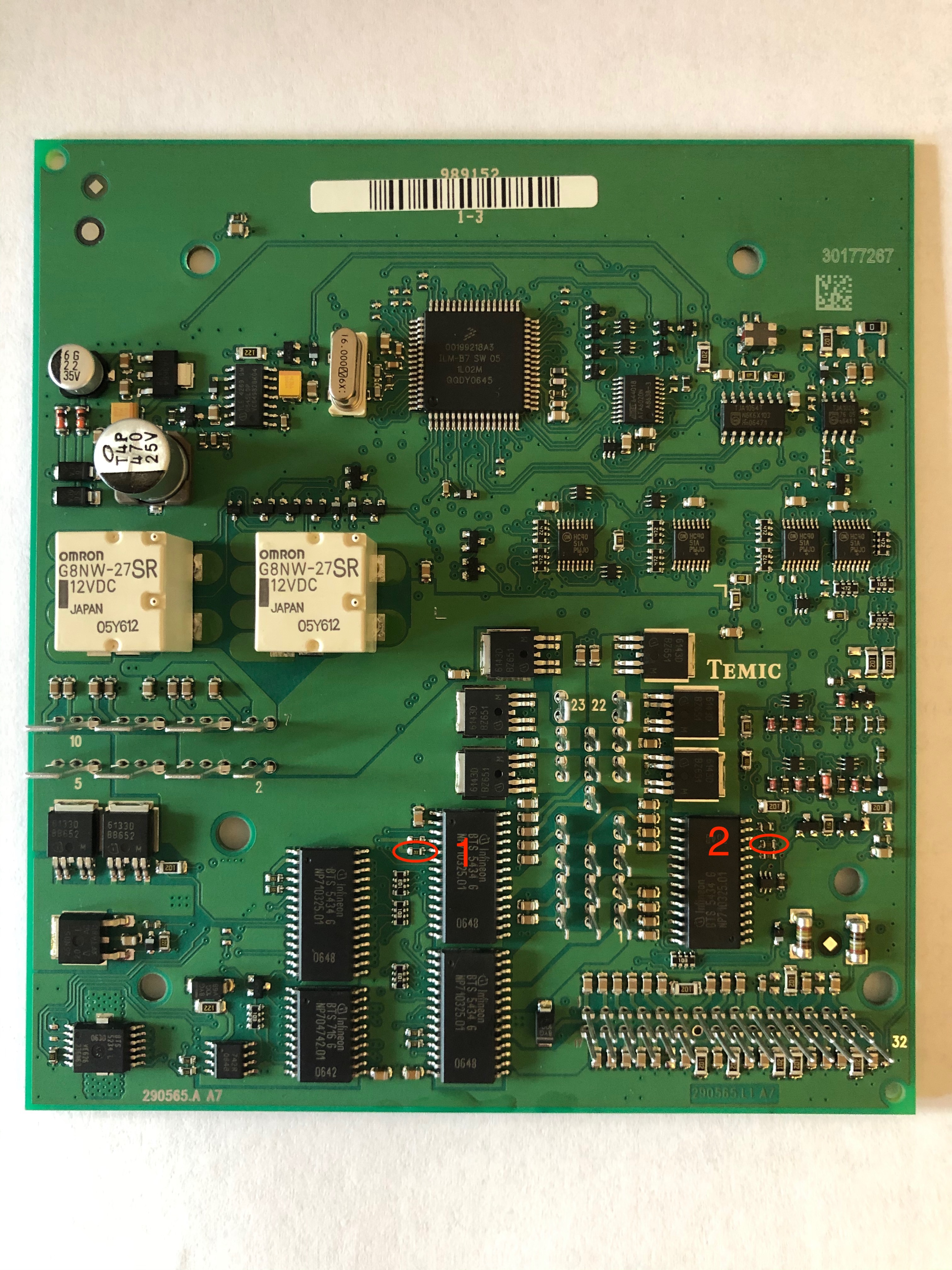

My original post included part of the modification necessary to make LED parking lights work, but now that I got them in there and tested it out, I found that there was another step.
I ended up replacing two resistors: I replaced (1) with 10kohm, and (2) with 30.1kohm. Note that (1) is the lower resistor of the two shown near my red oval, and (2) is the middle resistor in the group of three near its oval.
Since these two sense resistors are shared with other loads, besides the parking lights, I sort of guessed at what would be reasonable values. So far, this modification has worked - both parking lights turn on and stay on, and I don't get any error codes. I used these LEDs: https://www.amazon.com/gp/product/B07DTD4Q3R/.
These resistors are physically smaller than the ones used for the DRL sense lines - they're 0605, rather than 0805. 0605 is sort of a weird size, so I just used 0603s - which fit no problem. Here are some examples:

Based on the wiring diagrams, I believe that resistor (1) is shared with the license plate bulbs, so it's possible that changing it as I suggest here will also allow you to swap out your license plate bulbs for LEDs. I haven't tried, but at worst it may just require a higher value resistor. Resistor (2) is shared with the high-mount brake lights, which are already LEDs.
As with the mod for the DRLs, this works in my '08 North American RS4, but I don't know if it will work in Europe, since there's a variation in the wiring diagram that definitely doesn't represent my RS4 (I verified my connections with a multimeter and lots of wire). However, if the European cars are represented by the other variant in the diagram, then it's possible that only changing resistor (1) will allow both parking lights to work with LEDs.
