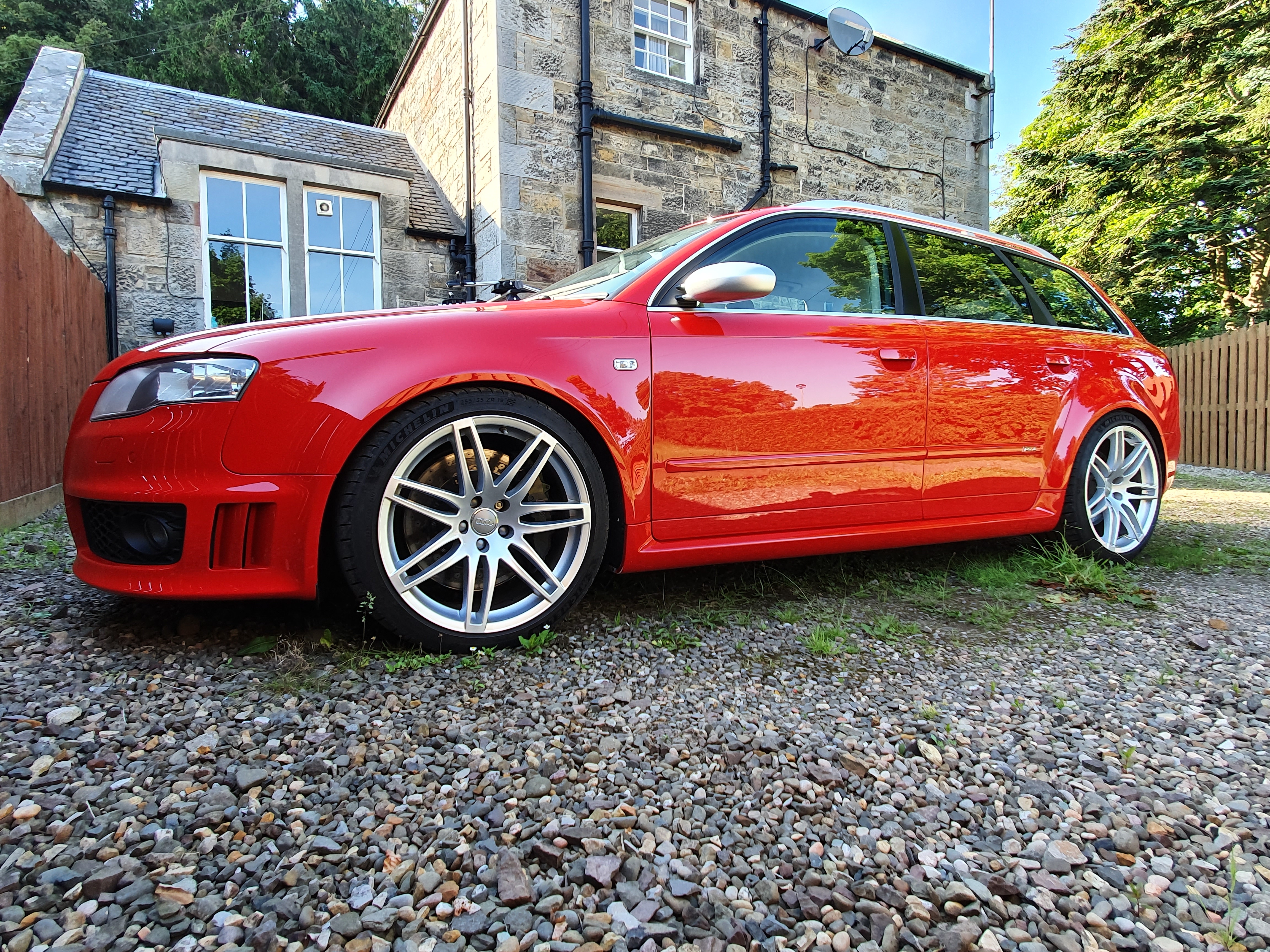

The car was lowered on H&R Monotube coilovers around this time last year, however the garage lowered the car around 50mm all round. Id since put spacers on, and it looks great but practically isn't all that viable for me (often taking my folks out and about which means i end up with a full load most times its out, abit of scraping here and there and just looks a little too "street"). As my wife is the one who drives this most of the time, she wants it putting back as close to standard ride height as possible, although after scouting the internet i cant seem to get a confident answer in terms of what the height should be set at. Current specs (centre of wheel to arch) 12.5 inches front and back.

I am on KW V3's but set to SS+ height.
667mm front, 650mm rear (floor to centre of arch).

The H&R coil over kit cant get to standard height regardless of what it is , The kit like all coil overs does LOW and even lower . NOT standard height , the body and shock shaft are shortened to allow for excessive drops ( RS4 50 mm is excessive ) thats why they dont get to standard height .
The other problem is if you wind the adjsuters to the top ( as high as they go ) the car ( shocks ) will top out over bigger bumps
Hope that helps
The best set up fpor the RS 4 to guarantee comfort is the KONI shocks and 20 mm H&R sport springs or standard springs . Peach to drive once that is done
