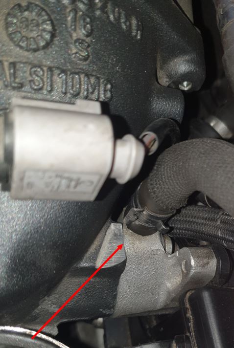

A question for the DIY'ers out there:
For those of you that have removed the flaps in the inlet manifold, did you then also remove the Partition plate (079 103 411 P)?

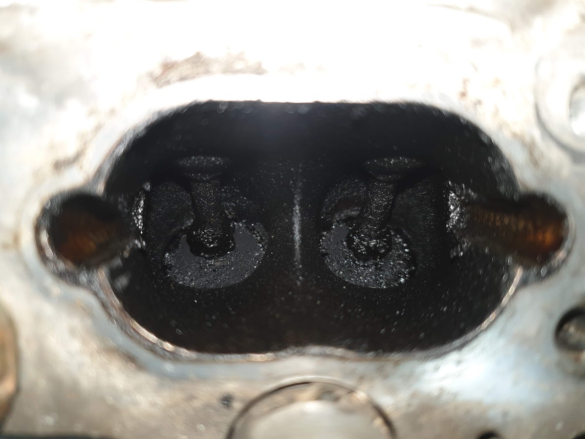

I purchased my RS4 with 122,000 km on it here in Germany, and it had already had a carbon clean @ 100,000 km. I have since put 25,000 km on it, unfortunately with mostly cold starts/short runs/city driving. But, recently, the car has become difficult to drive in traffic/off the lights, and easy to make the engine stall. I had some implausible signal flap position codes, and some rough running.
I was surprised and a bit shocked at how bad it had become in 25k kilometers!
I used Brake cleaner and oven cleaner (wanted to try LIQUI MOLY Ventil Sauber, but delivery time was 2 weeks), flat head screwdriver, chopsticks, hard bristle toothbrush, rotary brush on the end of a drill, vacuum, a lot of heavy duty paper towel and 8 bar compressed air.
The oven cleaner was surprisingly good actually, and was better than the brake cleaner because after leaving it on for a few hours, it turned the carbon into a sort of slimy, gunky fluid, which was easy to remove with paper towel. I am really interested to know what fluid professional companies use when they do a chemical clean.

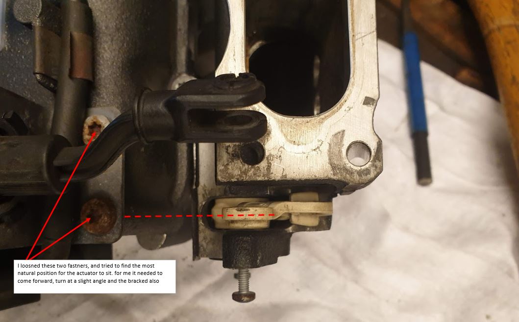

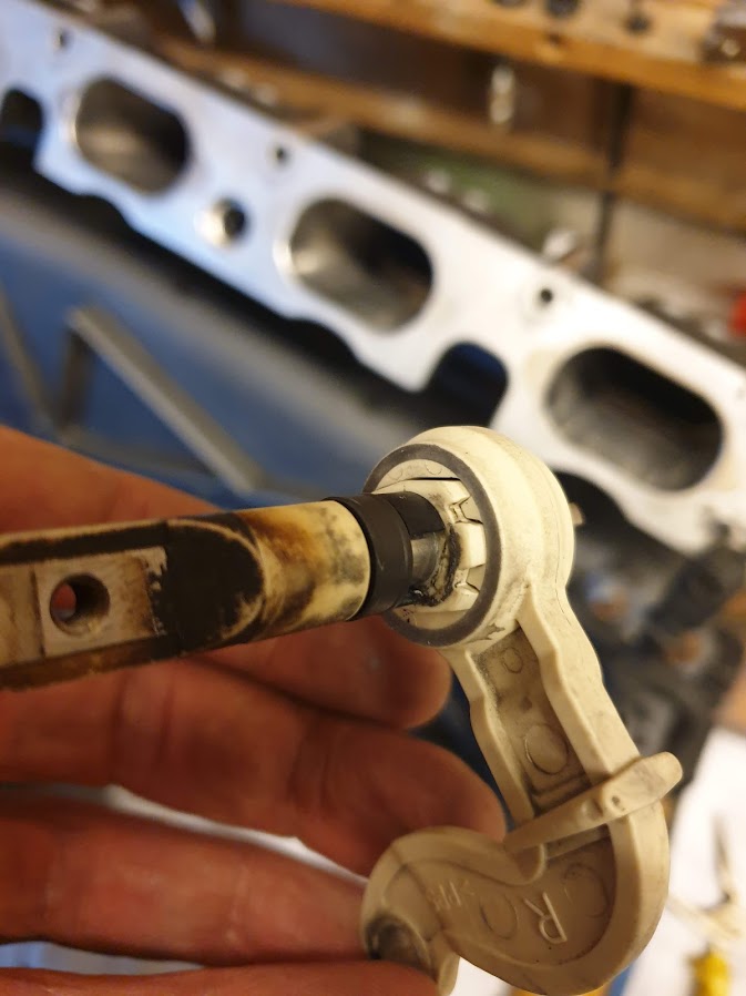

The potential reason for the "P2015 -008 Implausible Signal - Intermittent (Manifold Flap Bank 1)" fault code could be that was a lot of wear and free play between the plastic arm and the plastic gear on the tumble shaft.
https://youtu.be/XCnIKsblM1E
https://youtu.be/Ot5BaZGHfAQ
Only one of the arms was worn, the other was absolutely perfect, which is unusual, because they do the same amount of work. So, for me, it was worn because it was misaligned when it was built from the factory or when it was apart during the last carbon clean (i have no way of knowing). When you move it by hand or with a vacuum hand pump, you could see that it was also pulling to one side and not really following the stroke of the pneumatic actuator. I released the 2 fasteners, bent the bracket slightly, and re-tightened again.
I used Würth PLASTIC ADHESIVE REPLAST EASY UNIVERSAL part glue to bond the arm to the gear and shaft. The surface needs to be rough. If I want to remove this again, I will just need to use a heatgun to de-bond it.

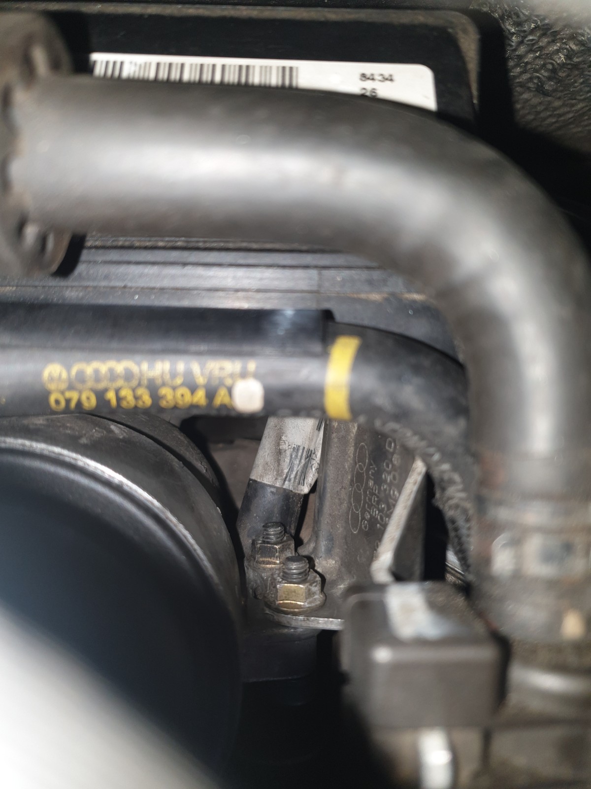

2. I already changed the screws for the PCV valve bracket. I put hex key bolts in from the front, and nuts at the back, so you just need to hold it from behind and work from the front.

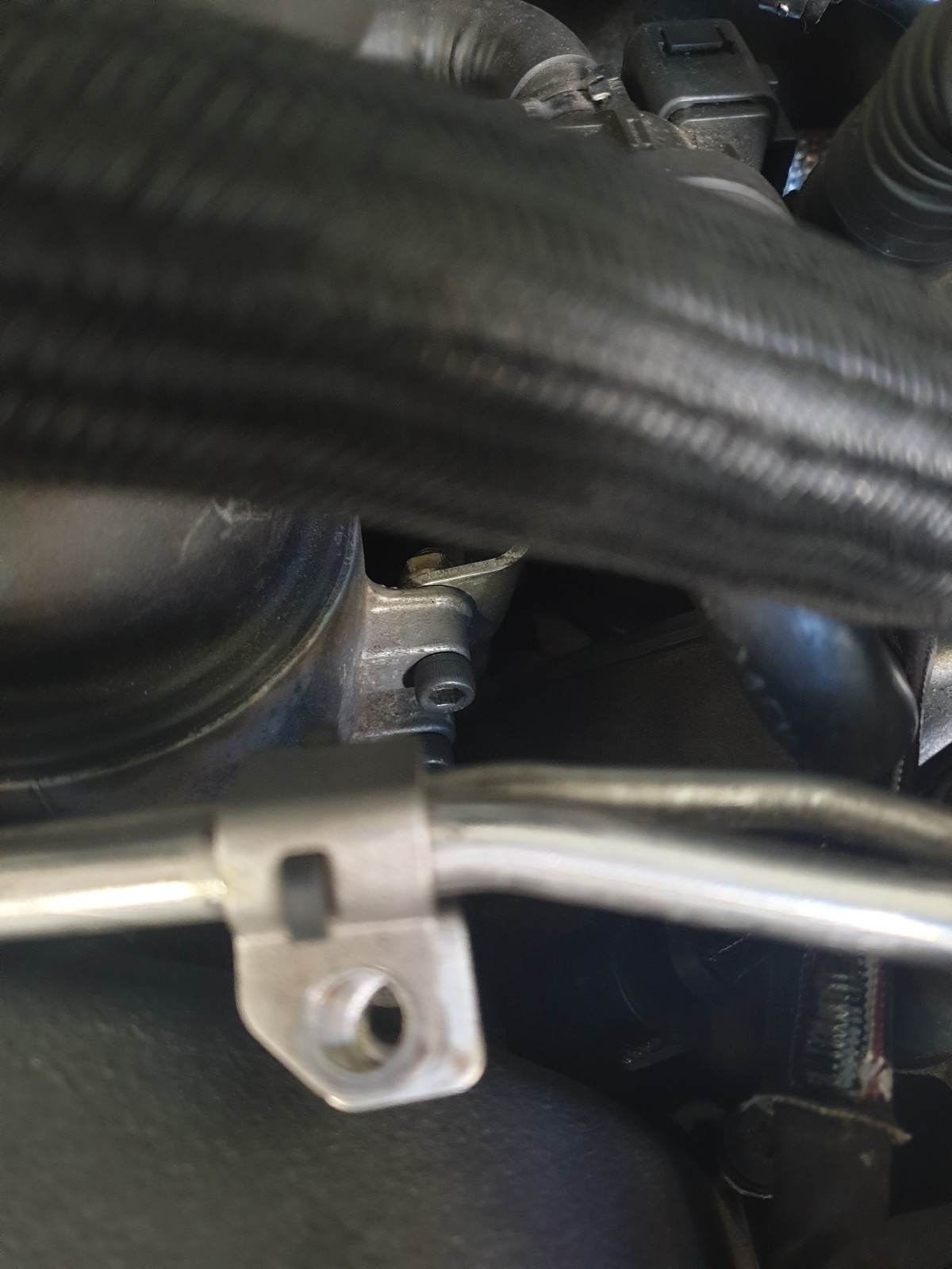

3. I fitted a jubilee clip on the water pipe that attaches beneath the fitting between the PCV outlet and the inlet manifold. It is much easier to remove this pipe now with a long extension than with the standard hose clip. (picture attached below of the fitting from the top, you cannot see the jubilee clip fitted on the bottom, but you get the idea which part i am talking about)
