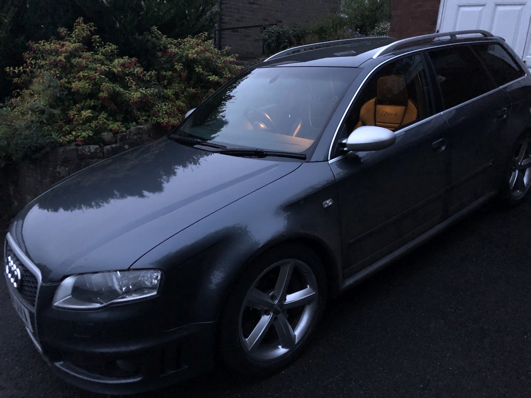

I use a set of the 7.5Jx18" OEM winters (8E0601025AH) with 225/45 Michelin Pilot Alpin 5. Wasn't convinced they wouldn't look a bit odd before i got them (second hand from Germany w/o tyres but wih TPMS sensors fitted & operational). Quite like the look of them now (crap picture attached!)
