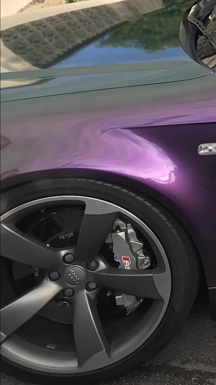

Mine is really low
But it only bottoms out on the flexy exhaust pipes, they only bottom out occasionally fast over speed bumps etc
2006 2-tone merlin purple , decat delete, res delete, x-pipe and rear back box delete......rs5 alloys.. silver brake callipers

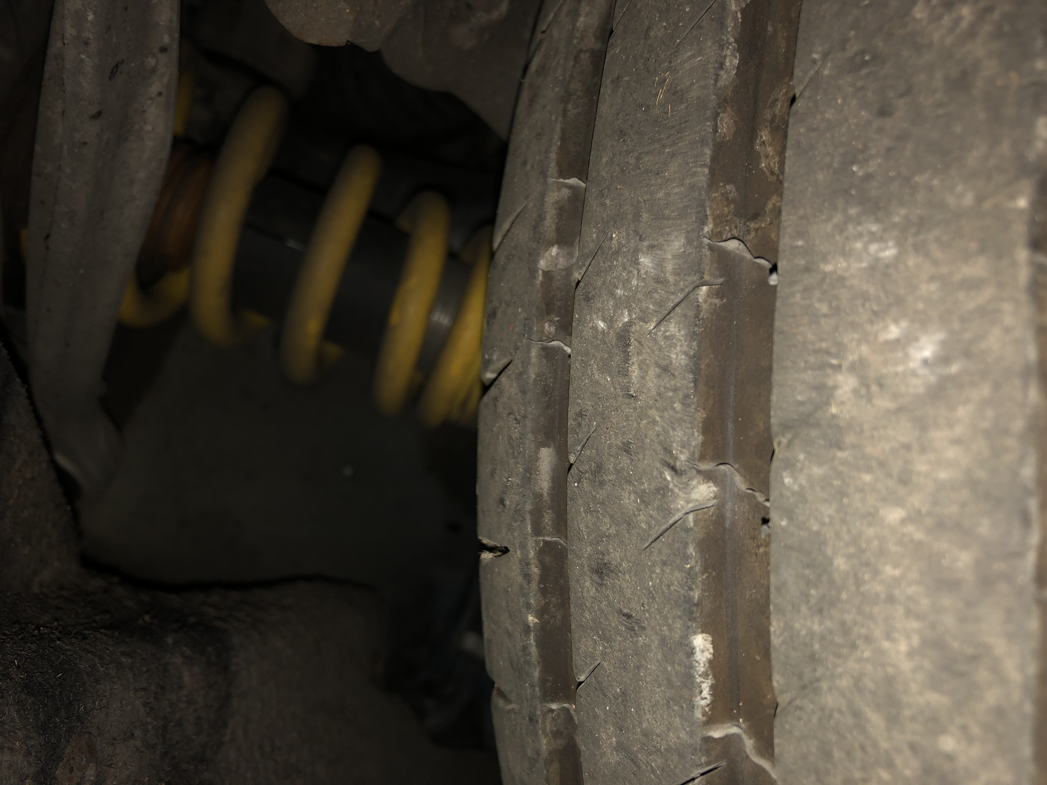

The after market suspension was fitted by a previous owner. I dont know what make it is or even if it's a good make or a cheap one here's a pic of it maybe somone could identify it for me.

Post by coffey555 » Fri Jul 26, 2019 7:52 pm
You have KW V1 or V3 coilovers installed, same manufacturer as the ones fitted to my car. They are one of the better coilover kits on the market.
Both V1 and V3 setups have the same range of height adjustment.
I would take it do a good local indie and ask them to raise the ride height followed by a full geometry alignment. At full height it will be 15mm lower front and 10mm lower rear than standard SS setup. That should see you clearing most things on the road.
My flexi pipes would just catch on a speed bump near my house but since I raised up the rear it no longer does it, front height was untouched.
