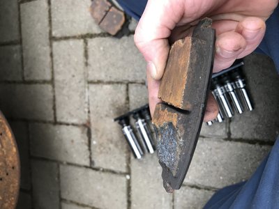

Post by Lukes3 » Wed May 01, 2019 9:25 pm
Anyone ever had this happen?
Only done 2000 mile ish.

Wow that's pretty scary stuff. I reckon Ferodo themselves might be interested to see this, be worth contacting them. You wouldn't have been sold fake Ferodo pads perhaps (have heard this is quite common).

As said above, I would contact Ferodo and see what they say. How did you come across it was missing half?

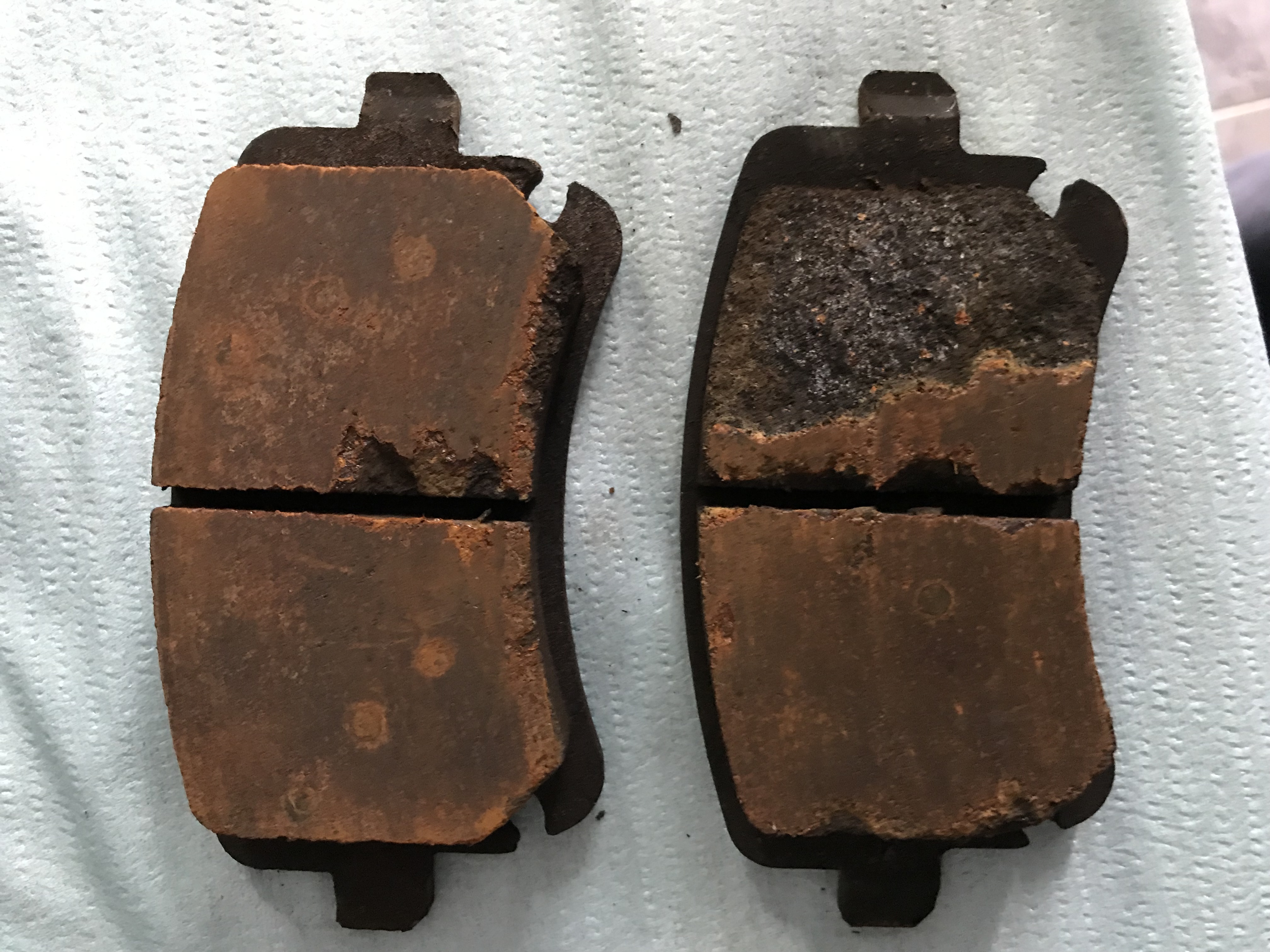

Ok judging by the rust deposit, I can guess the car has been standing for a while? And you most likely overheated them before.
Ds2500 have a tendency to crumble. Similar thing happened to my second set. Basically I was swapping them over for track day use only. After one of the days, took them of, and put them in the box in the garage (until next track day in a month time) when it came to put them back on, they were crumbling like a cookie around the edges and got all puffed up. My theory is, “good”heat cycle and trapped moisture makes them go bad unless they are constantly used. I threw them away and went for ds3000 (still to soft but better)
They need proper bed in period. According to ferodo, you can’t overheat them in the first 100 miles or so. But my theory, trapped moisture corrodes them from inside making the super soft. This is not my pic, buy mine were similar. Image
By the way, this is my first set of ds2500. They were used daily and that’s after 3rd track day. Image

I have sent them a message dont know how long it will take for a reply thou. They were brought from a ferodo dealer so would like to say real.

I am replacing the front brakes an doing a few things on the car so its been parked up. But just before parking the car up there was a squeal coming from the rear driver side. Had a quick look an saw a groove had a look and found that
Honestly, if you want amazing stoping power, try carbotec xp10 or 12
The car has got rust spots now because it has been sitting for 3 months but before that i did use it.
Its been to the ring an back and a few meets here like i said 2000 mile ish. An considering these are rear pads i didnt think they should take much of a beating?

You be surprised how much the rears have to work on b7 when you drive in anger :)
