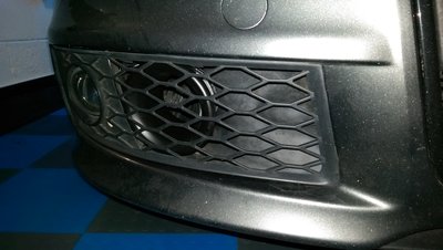

As Mike says - fit a large CAF from behind the fog light grill (assuming you have aux radiator delete?)
My RS came with the Revolution intake and a small diameter CAF fitted so I upgraded to a larger one. I'll post some pics later but its pretty straight forward.

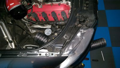

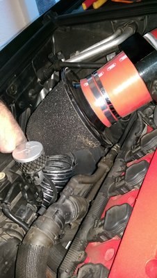

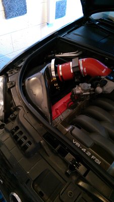

Heres a few random pics of my upgrade install -
45mm diameter feed removed ready for 102mm. My opinion is any larger would be struggle to fit
Inlet trumpet fitted
Engine bay bling

Re: Revolution air intake
Post by Covkiller » Tue Nov 27, 2018 10:40 pm
Looks like a smart job. And I bet it sounds proper Nascar ?

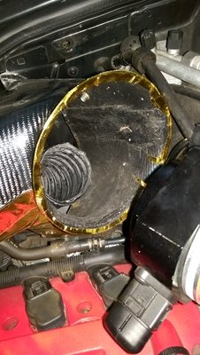

Post by Stew » Wed Nov 28, 2018 7:12 pm
Thanks guys for the reply’s yes have a 102 mm one was thinking off trying to make a heat shield to stop the heat from the manifold think I remember someone done it was wondering was it successfull ?

Post by jonytek » Thu Nov 29, 2018 5:24 pm
Is this what you're referring to? viewtopic.php?t=91761
