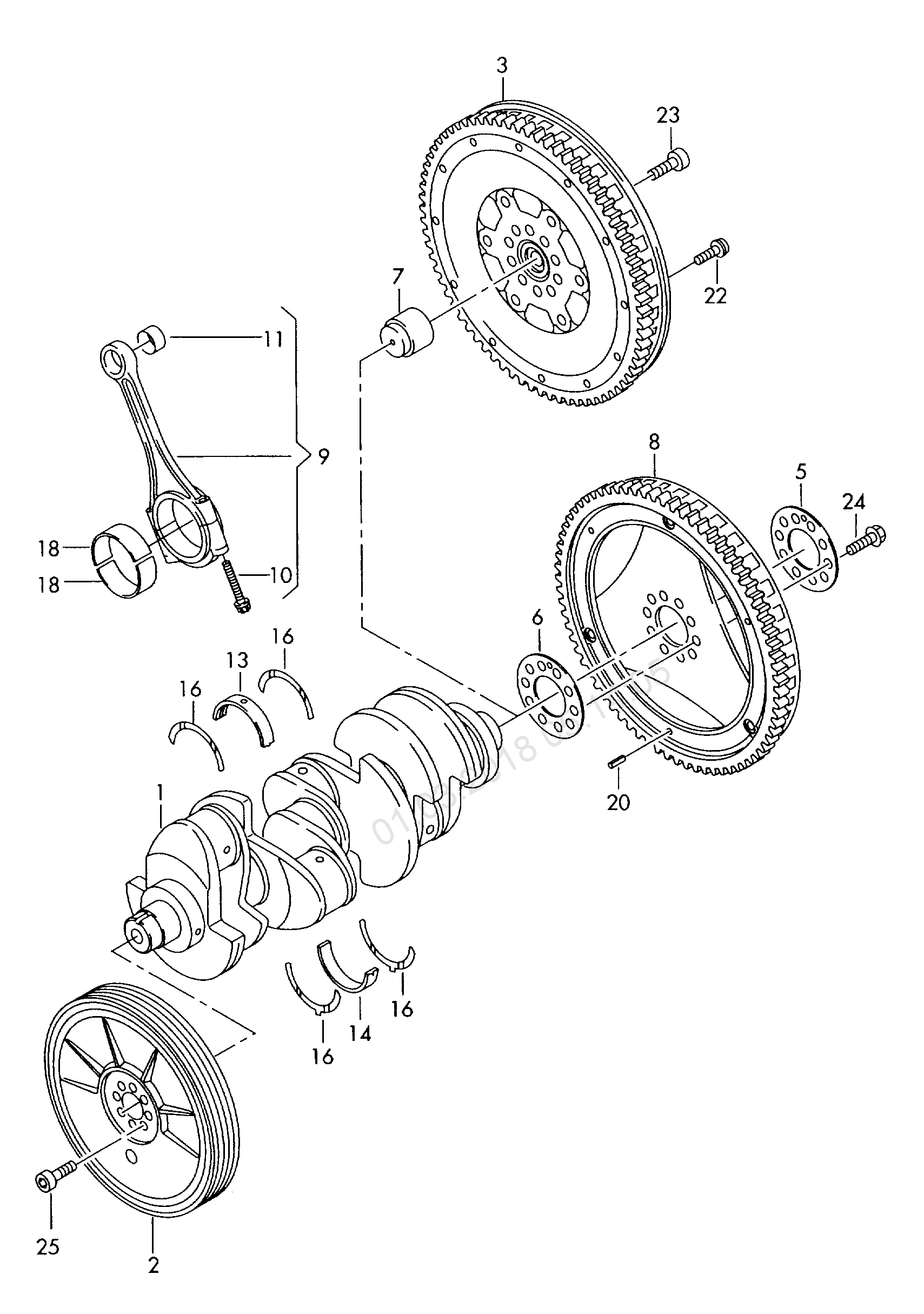

I'm already to rebuild the engine. But I do not idea how can choose the bearing shell.
No.13 bearing shell
079 105 561 G (red)
079 105 561 H (yellow)
079 105 561 J (blue)
No.14 bearing shell
079 105 591 G (red)
079 105 591 H (yellow)
079 105 591 J (blue)
No.18 connecting rod bearing shell
079105701G ROT(red)
079105701G GLB(yellow)
079105701G BLA(blue)
Then about No.16 1 set of thrust washers, I check the website have 2 parts
THRUST BEARING - AUDI (078-198-421)
WASHER KIT - AUDI (078-198-421-A)
What different ??! The website, have not detailed can understand. How many quantities do I need to order?
Please, Help me!!
Thank you
How can choose the bearing shell No. (color)?

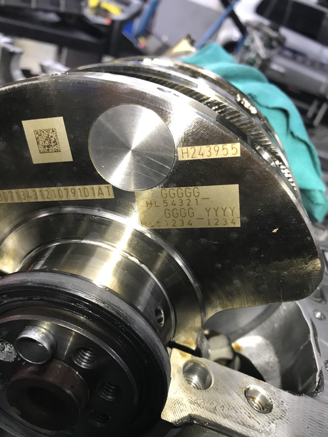

This is my crankshaft, on to the rods were marked GGGG-YYYY. Then my technician checks Elsawin, in fact, this is work not easy for me.
But I do not understand, can not found each color the dimension by Elsawin?

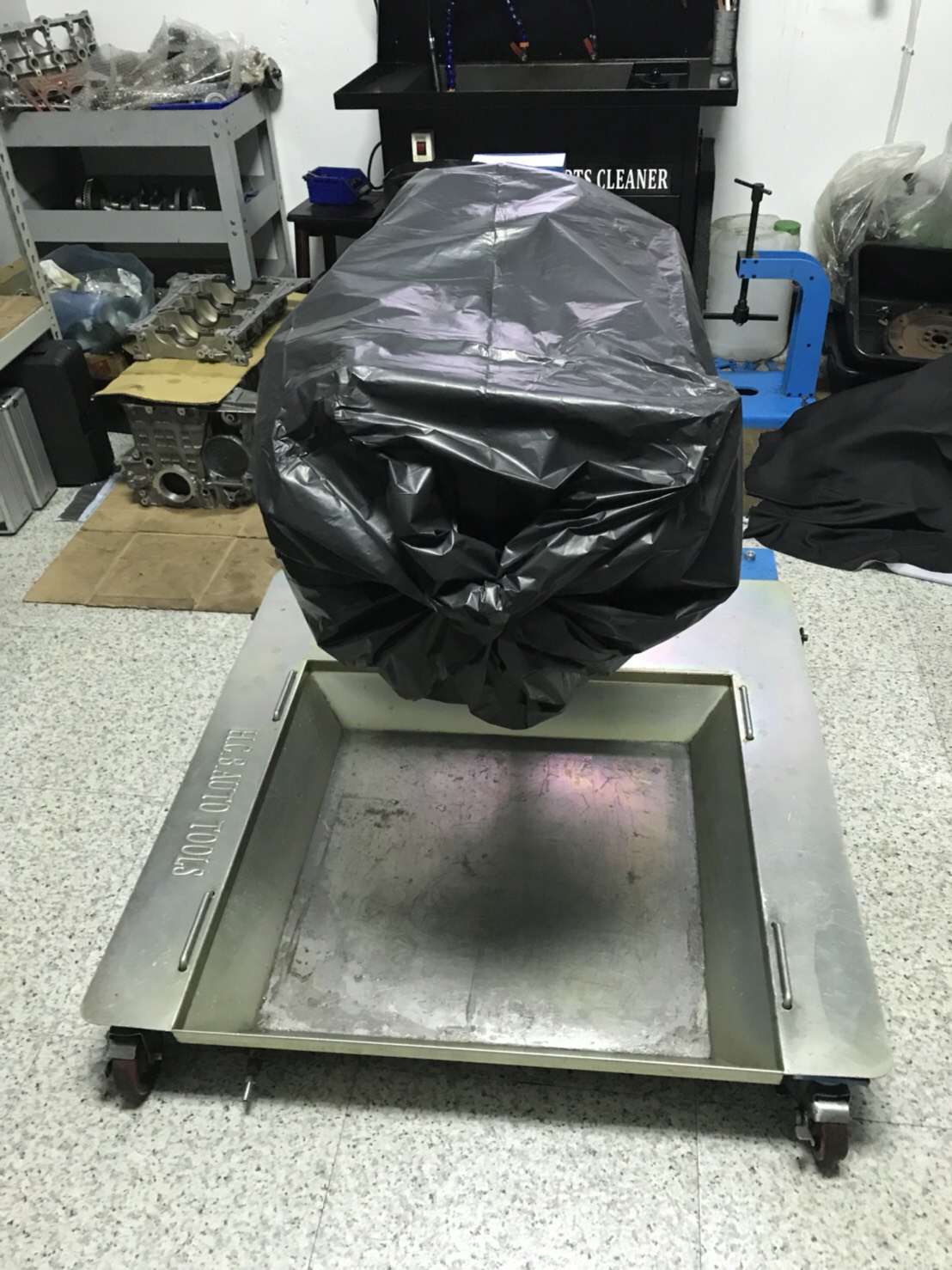

First preparation the parts
Is Big Guy
BBQ ing
Cleaning, bale then waiting for the second time parts arrival.

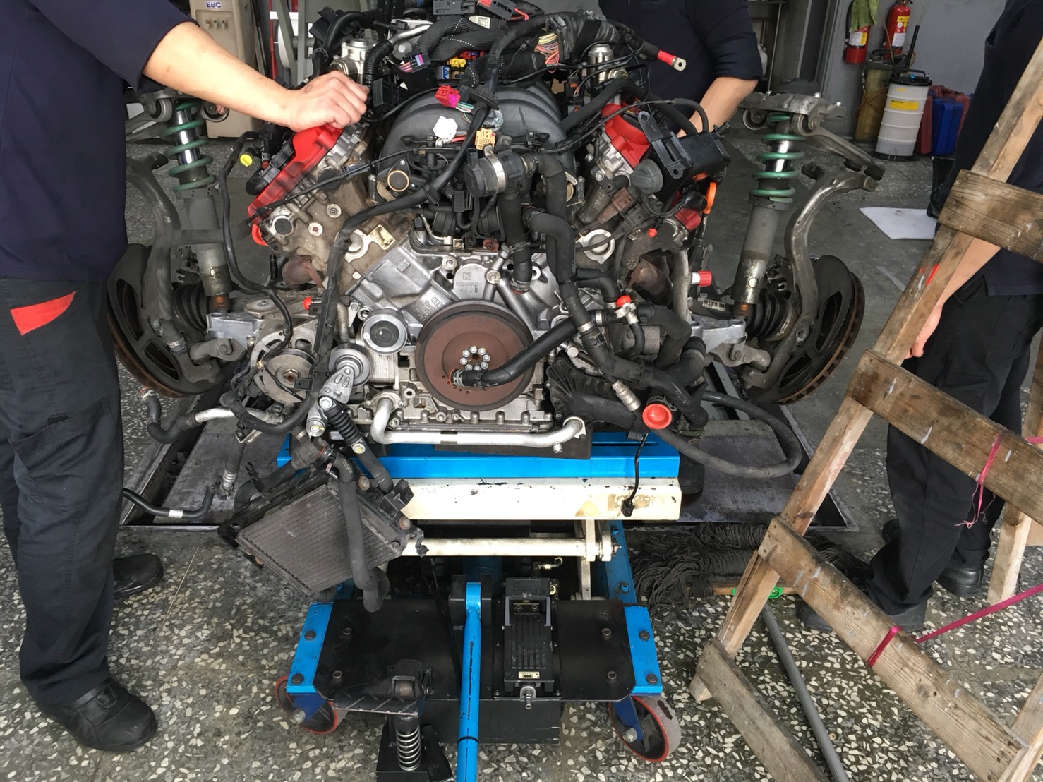

I don't mind, I rebuild on 89,550km. My problem is very slight as some oil leaking, in the beginning, so just want change the O-ring and pipe. But the oil leaking between oil sump-upper and lower, so I need to remove the engine from the car. Then more the plans beginning, this is can't stop so I changing the must change parts, like the timing chain, tensioner, guide rail, bearing...does not finish. Even though my engine everything is ok, I still needed to be bought around 330 quantity as 88 parts(include first order), this is loss more cash, I cry. I waiting for the second shipping.irn_bru_ce wrote: ↑Wed Mar 07, 2018 8:50 pmDo you mind if I ask what mileage was on the engine before it needed the rebuild?

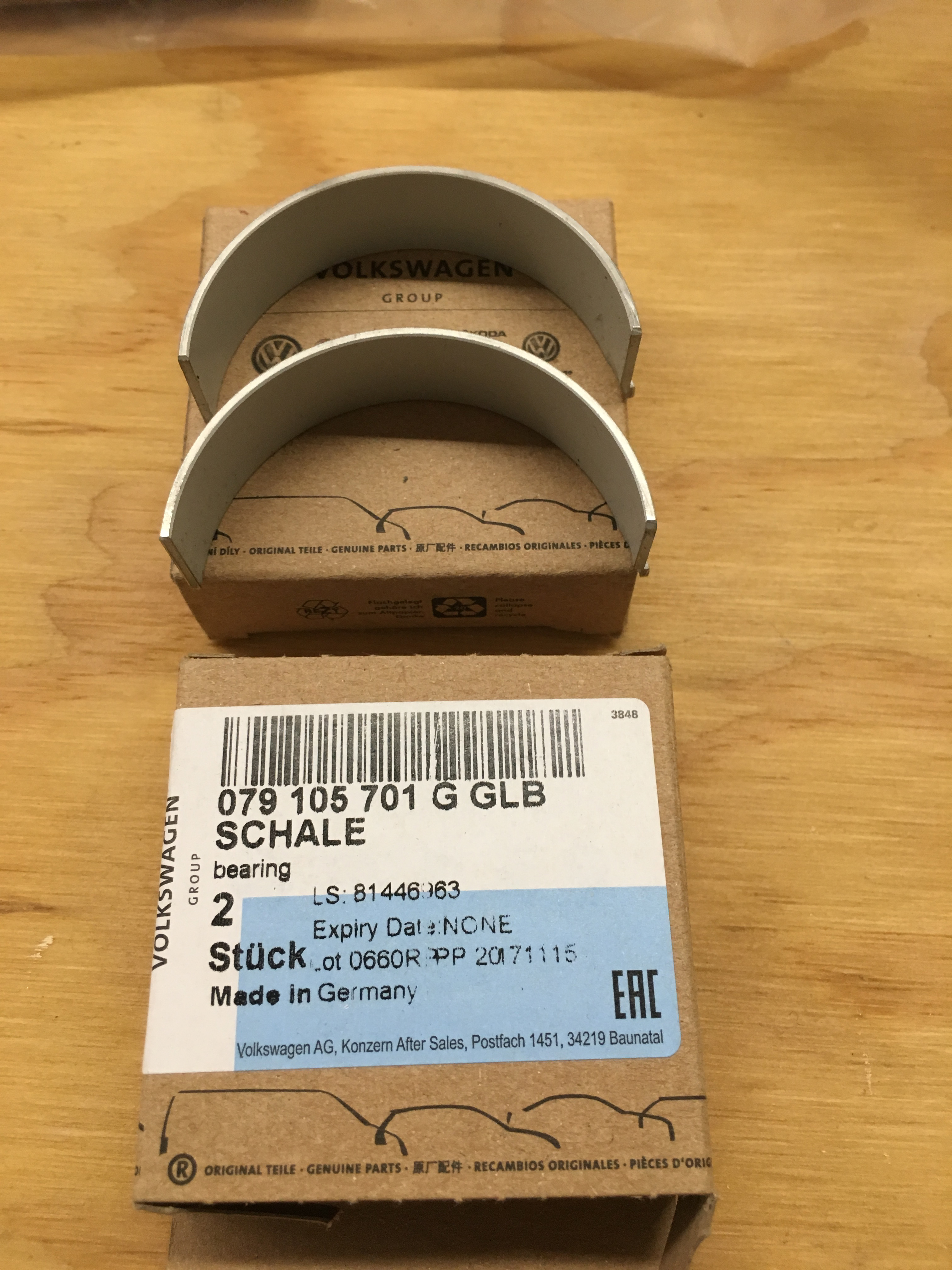

About rod bearing, my supplier told me the 079105701GBLA Blue bearings are no longer available. I keep asking my supplier about this problem. Then Audi told him - the rod bearings as "model specific" and yellow as the only option for rod bearings, I shortened explained, keeping the emphasis and keyword.
Rod bearings have different force, so corresponds is on uppers and lowers as two specs, I think this is a simple physical process. Before, corresponds is yellow/blue the rod bearings by AUDI technological manual. Why the Audi change it now?
Now, I can't buy the Blue bearings from my supplier. So I try to find the purchasing agent, ordered new Blue bearings from Germany. Maybe I can get it in next week.

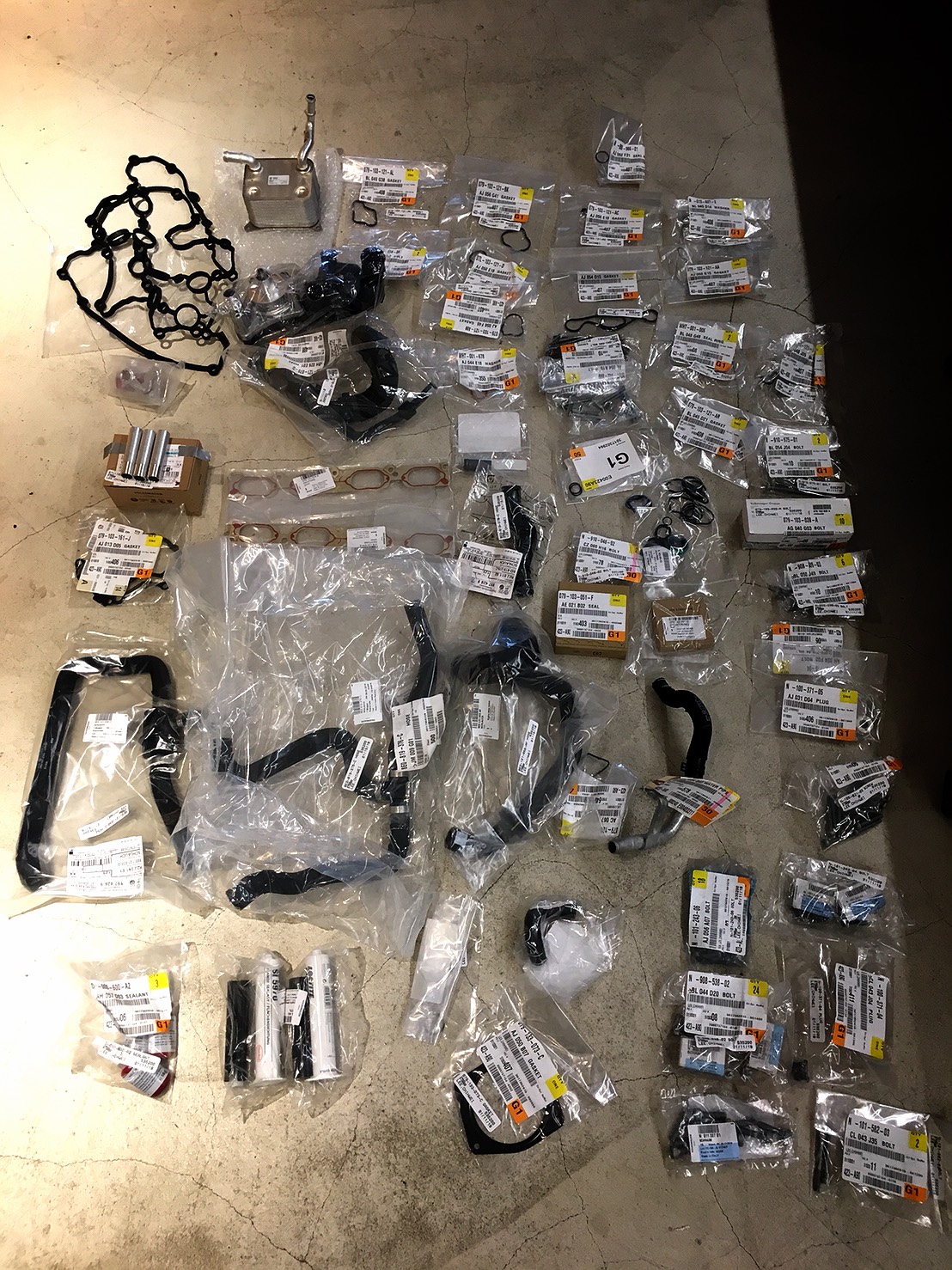

I got the new parts two weeks ago.

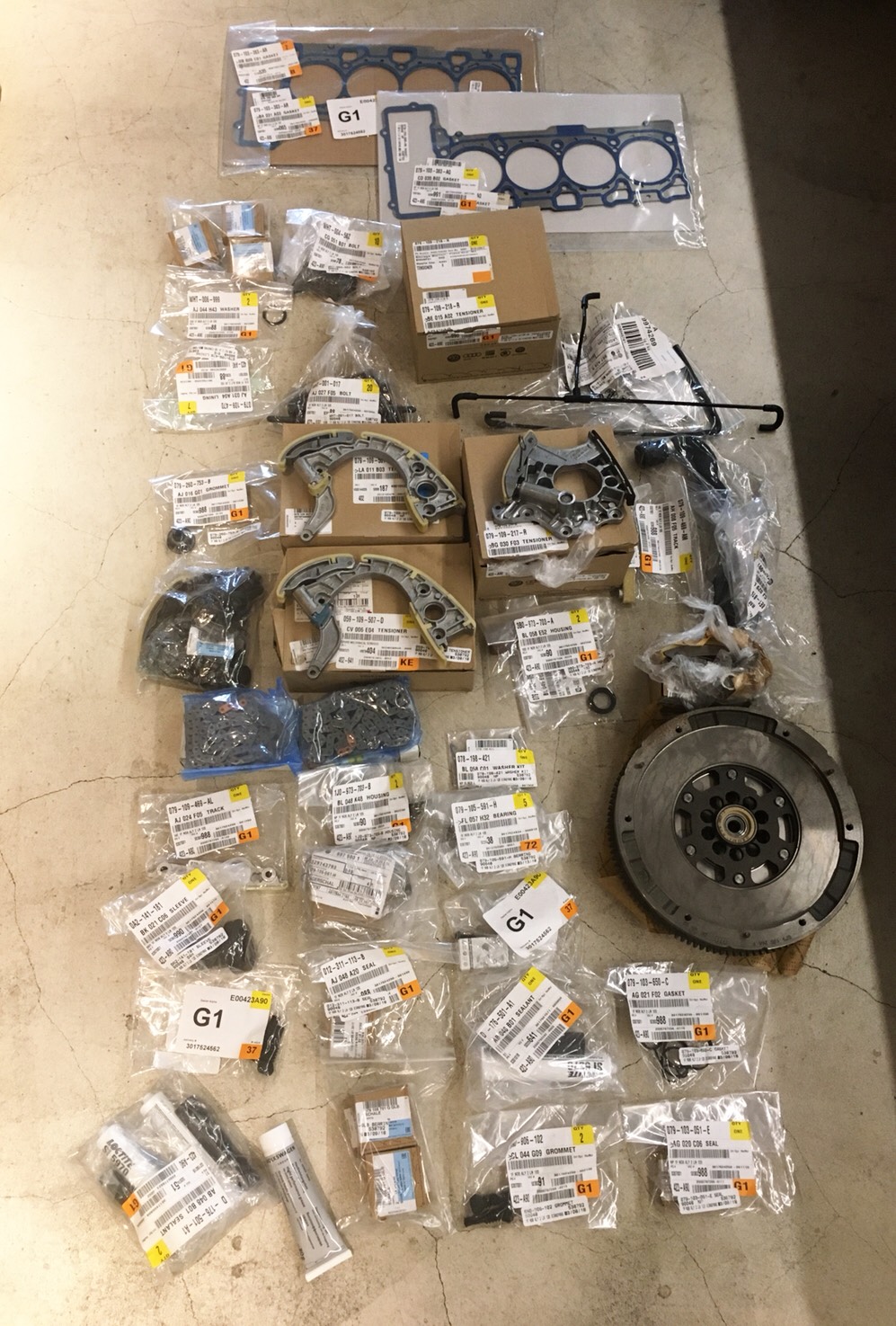

The second parts. If you see it, I bought double the chain tensioner, is not correct, only need one. Because of this part has two number can use, only a little different is the white plastic length.
The Blue rod bearing, the part has been replaced by 079105701GGLB

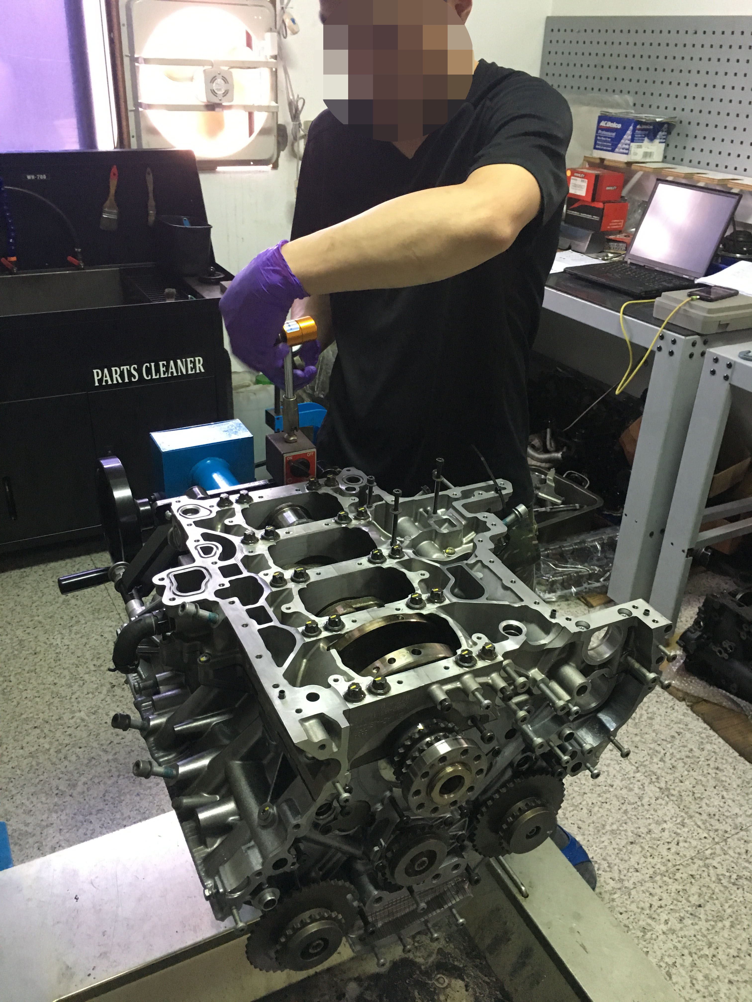

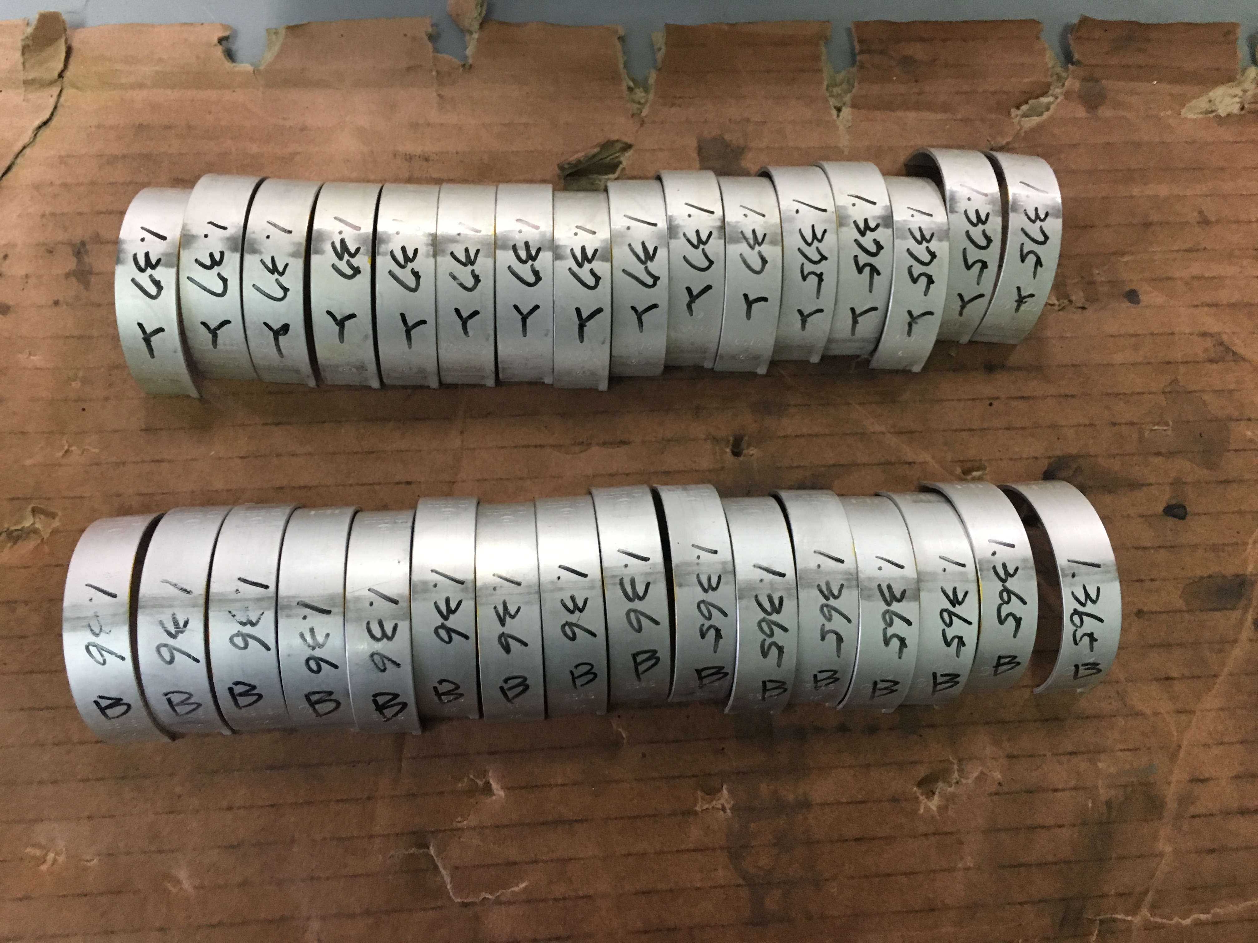

Then measuring every the rod bearing

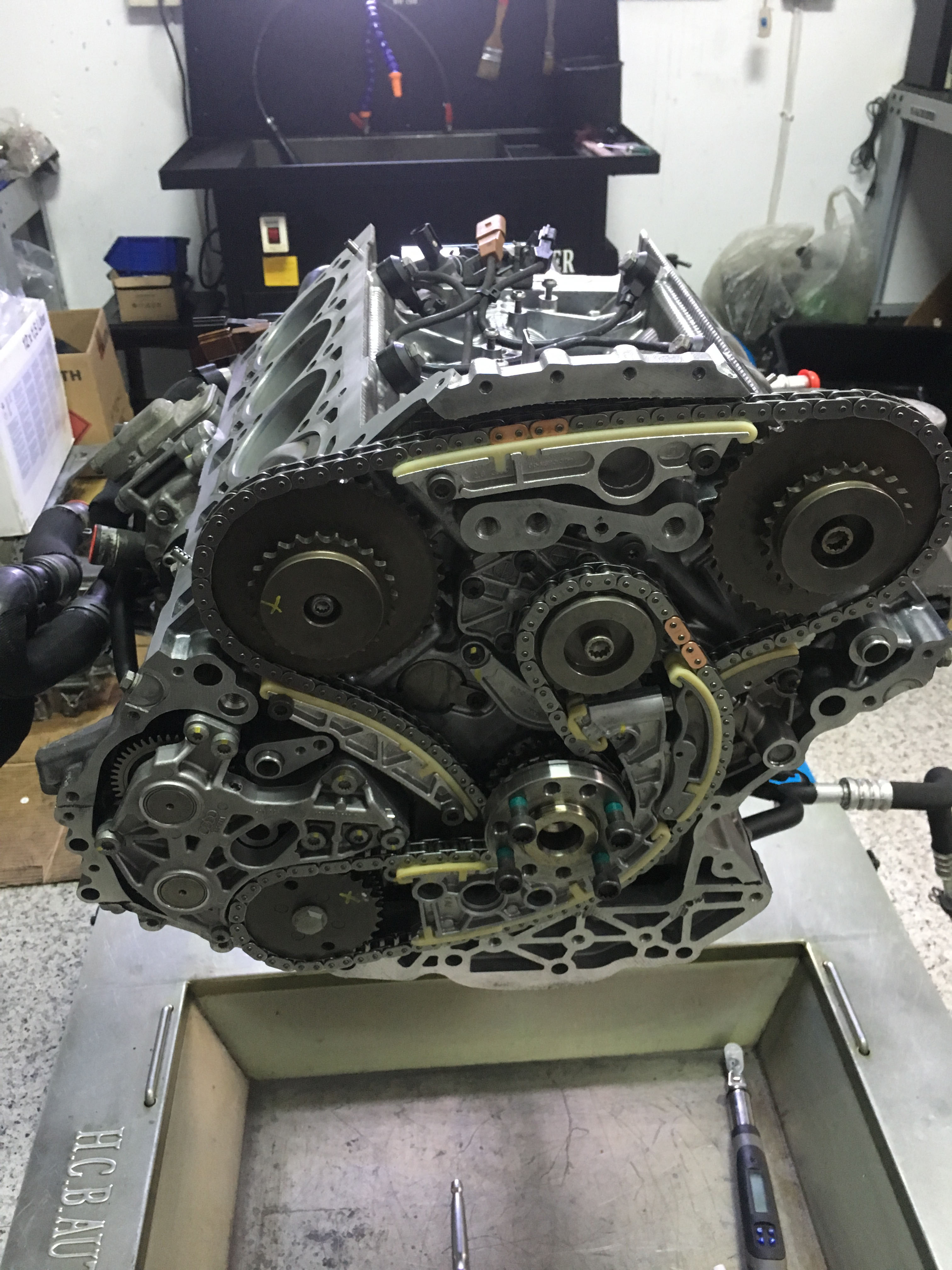

Rebuilding
70% - 80% finished, maybe

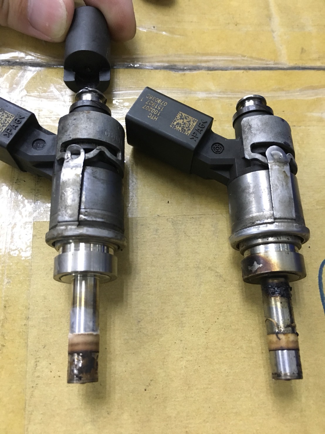

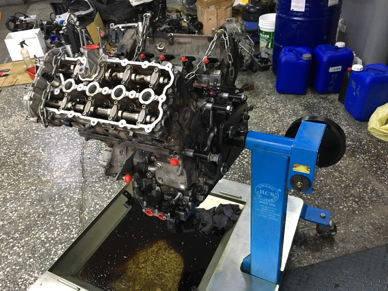

Then I don't know the injection valve is very hard to remove, damage to on the head. This is expensive
, I need order parts again for 8 injection valve with repair Kit. If you will remove or cleansing it, must be careful.
