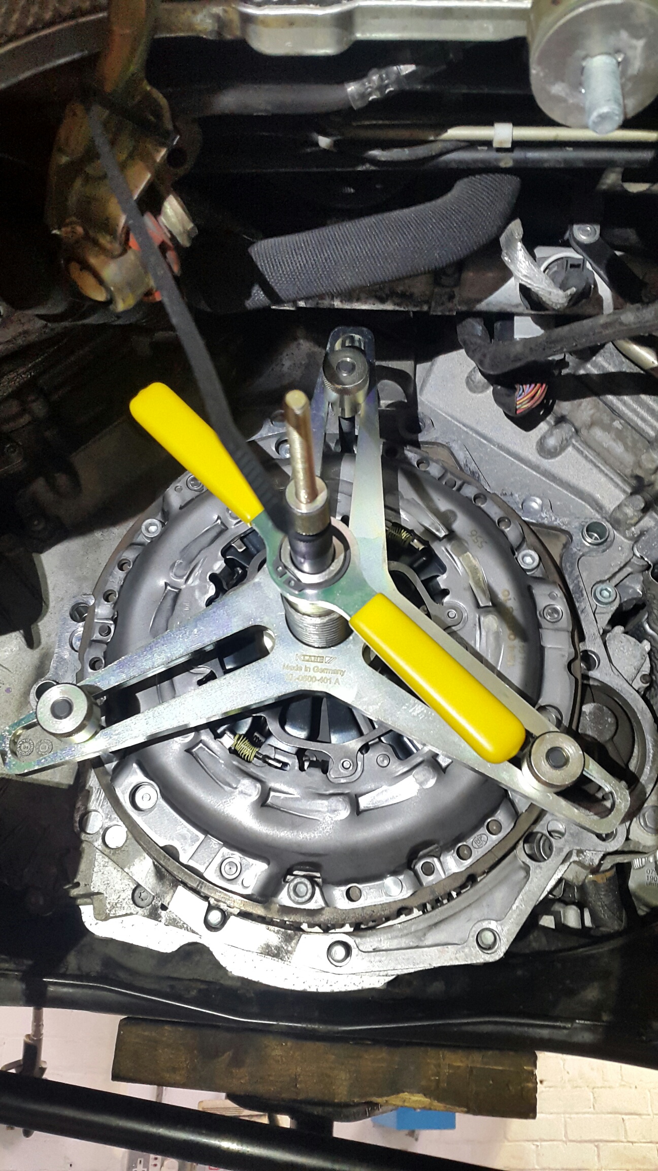

Probability wise it could be the master cylinder - the clutch bite point was the same midway point after you had the new clutch & fly fitted, obviously once built up it needed bleeding, this involves 'over stroking' the master cylinder from it's normal point of travel i.e. pumping all the way to the end of it's stroke (to the floor) which can cause seal integrity issues - unless of course you fully pressure bled it and didn't over stroke it to the floor?
Other points to consider / check;
Slave cylinder (I know it's new) is leaking, peel the dust cover back and check, there should be no fluid, this I think is unlikely as you would have to loose a bit of fluid to suffer the lower biting point and you don't mention any fluid loss. The master cylinder can suffer air ingress giving a spongy pedal feel and consequently there is not enough 'solid fluid' movement to fully disengage the clutch, it should be noted a master cylinder can also leak fluid past the seal but back into the resevoir so you wouldn't notice any level drop.
Clutch - you say OEM, they are of a SAC variety (Self Adjusting Clutch) and should be fully compressed with a special tool, so once bolted to the flywheel the clutch disc will turn freely then the tool released to allow the clutch cover to clamp the plate - now a lot of peeps will be shouting they didn't do this and haven't had any problems, that is quite true but text book way is to fully compress the cover when fitting, but as said it can be fitted without doing this and not suffer any adverse consequences. See picture of the tool.
Bellhousing components - the clutch release lever and it's fulcrum (plastic pivot) are an updated part from O.E. fitment and as such should ideally be replaced when the box is out, also the guide tube (or retainer) that the thrust or release bearing slides on. All these parts are only 60 Great British Pounds or thereabouts.
Also as mentioned fitting issues including clutch cover bolts or bell housing bolts left loose!
Hth and you get it sorted bud
Rob
