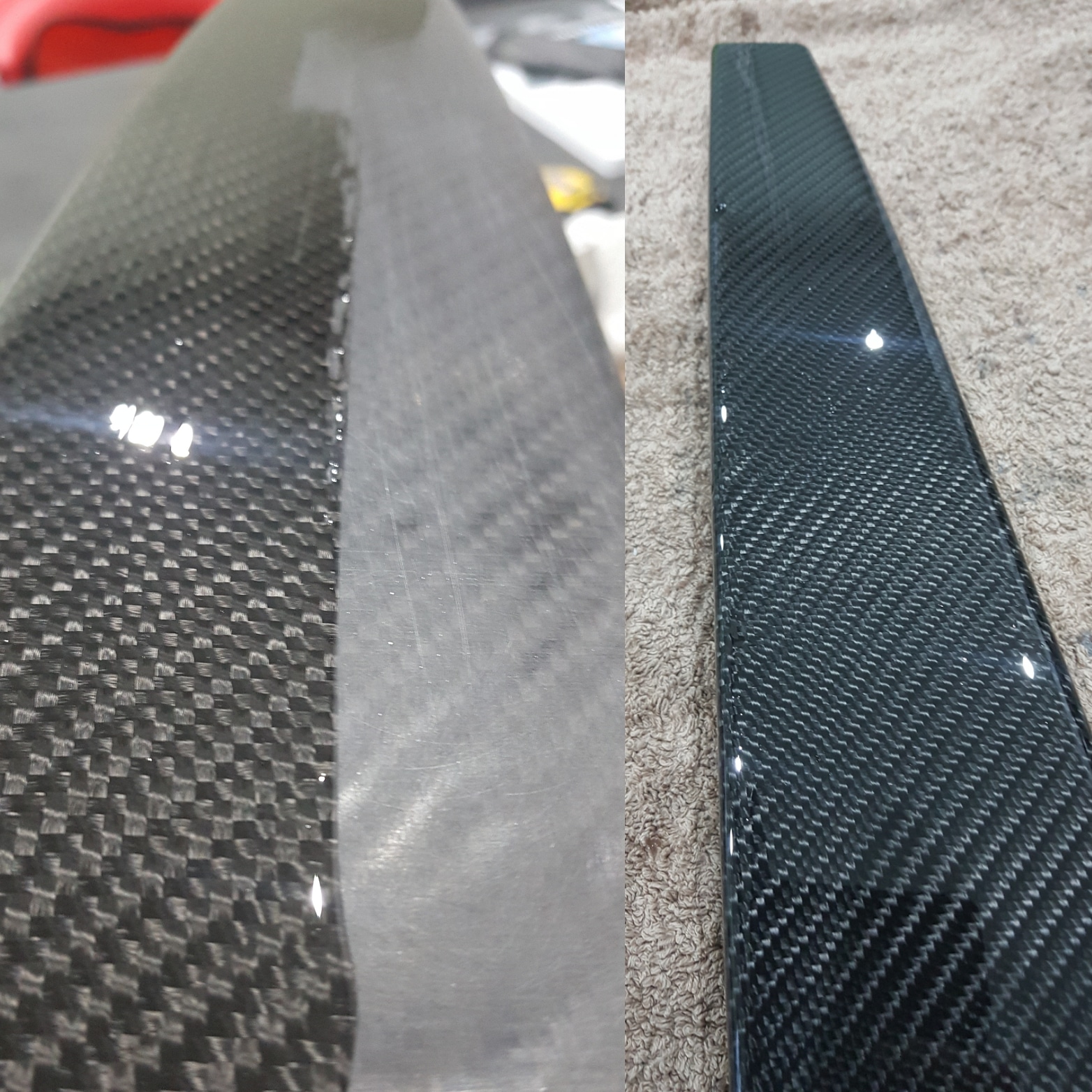

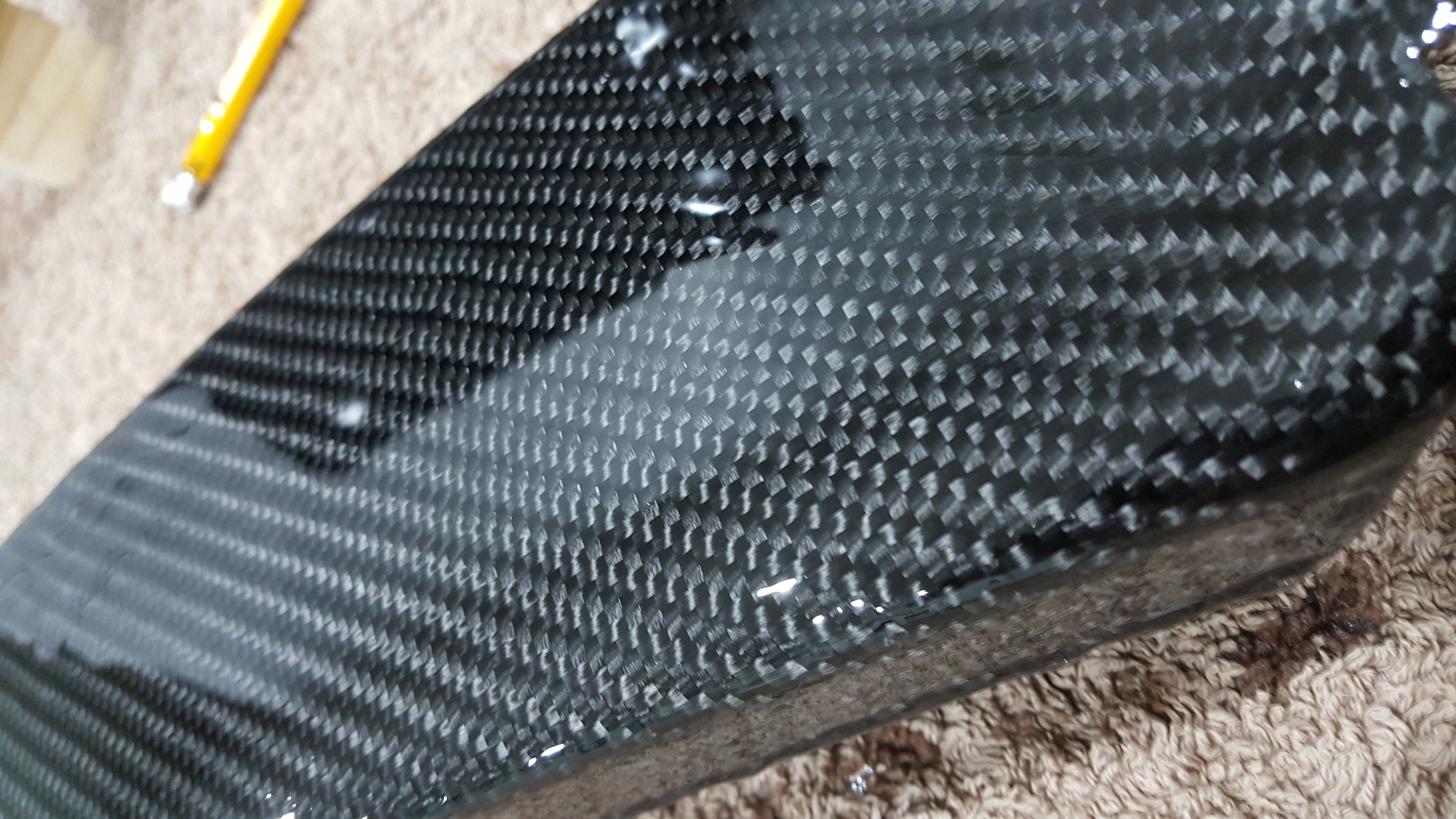

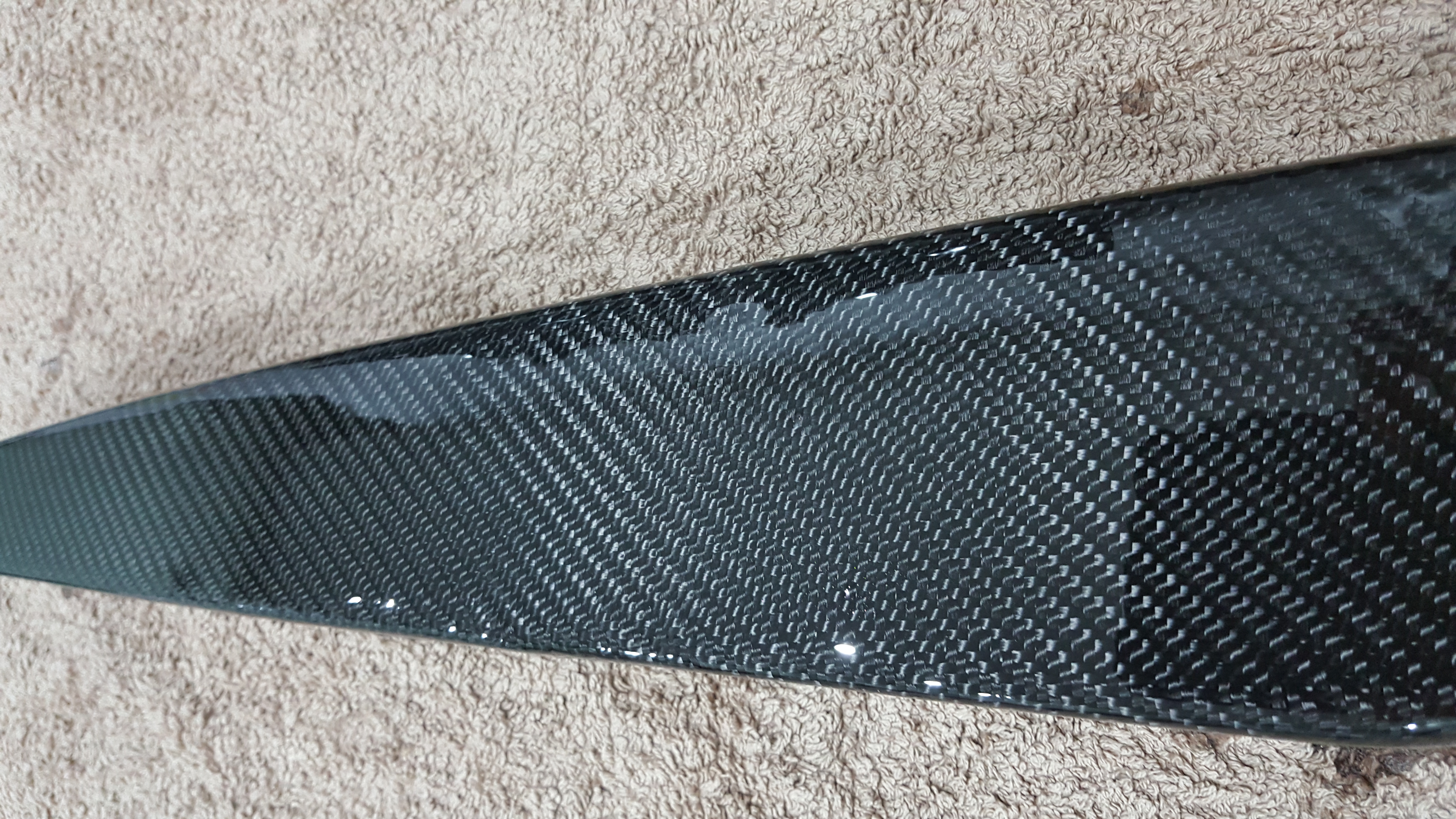

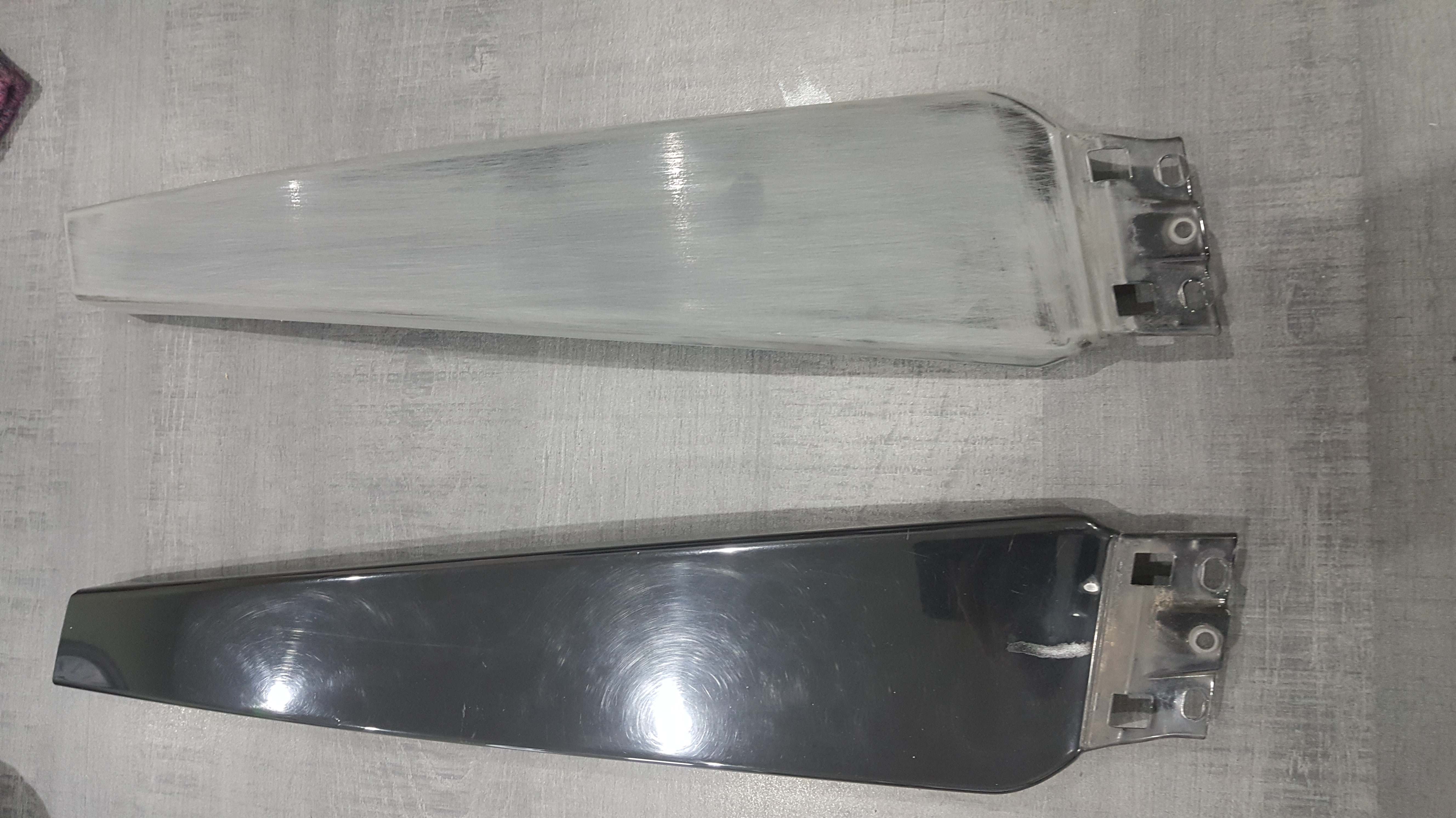

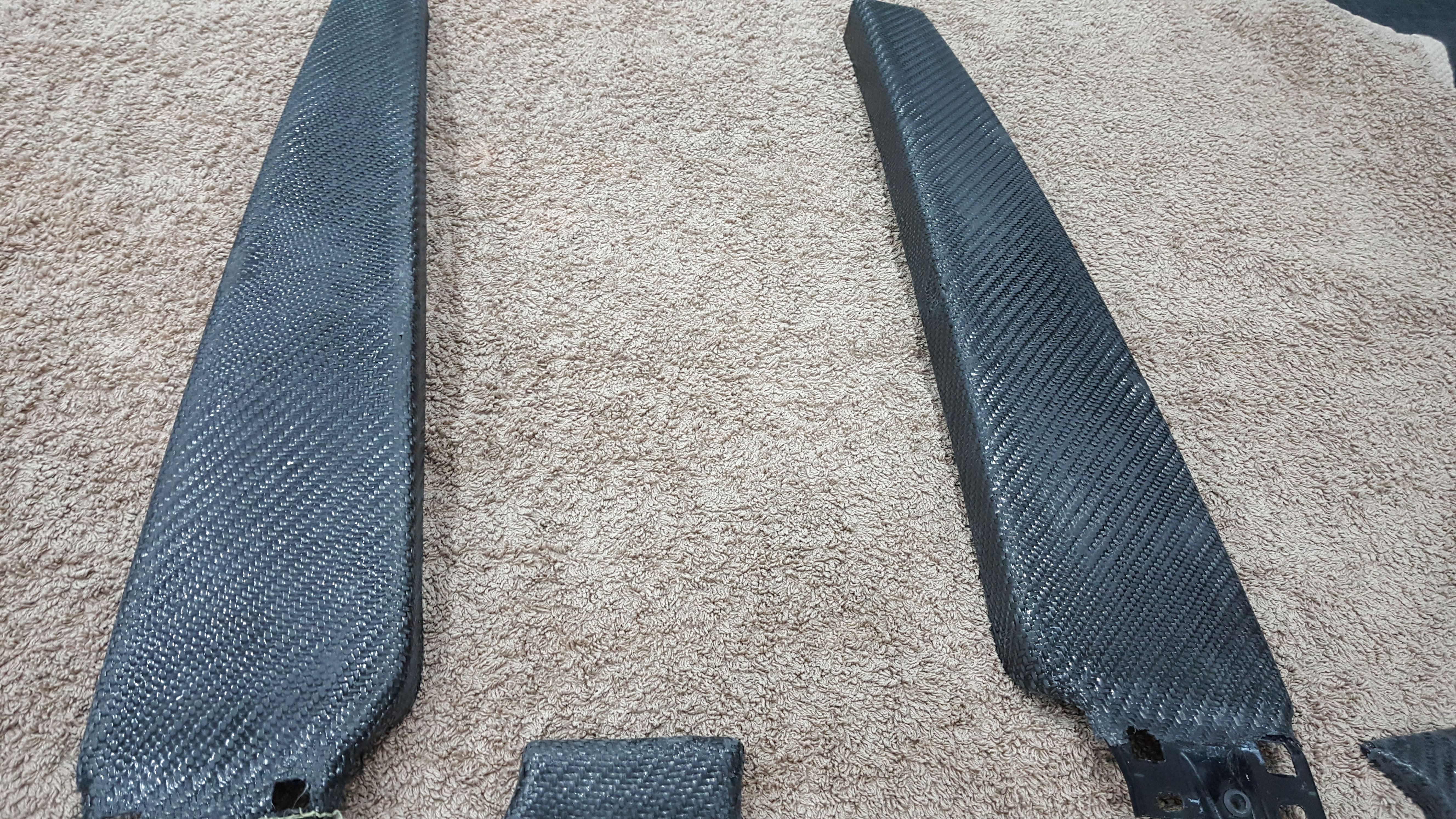

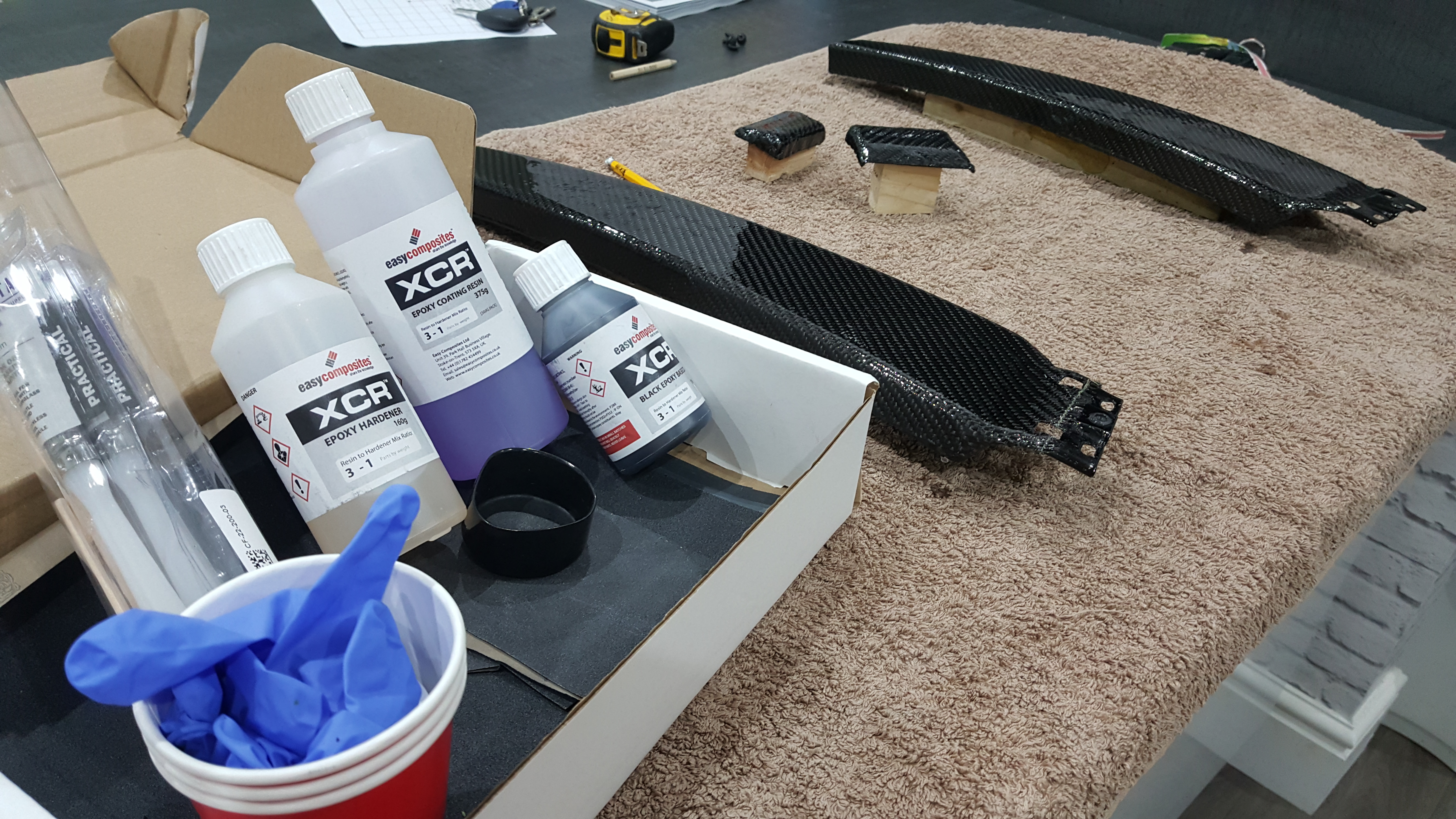

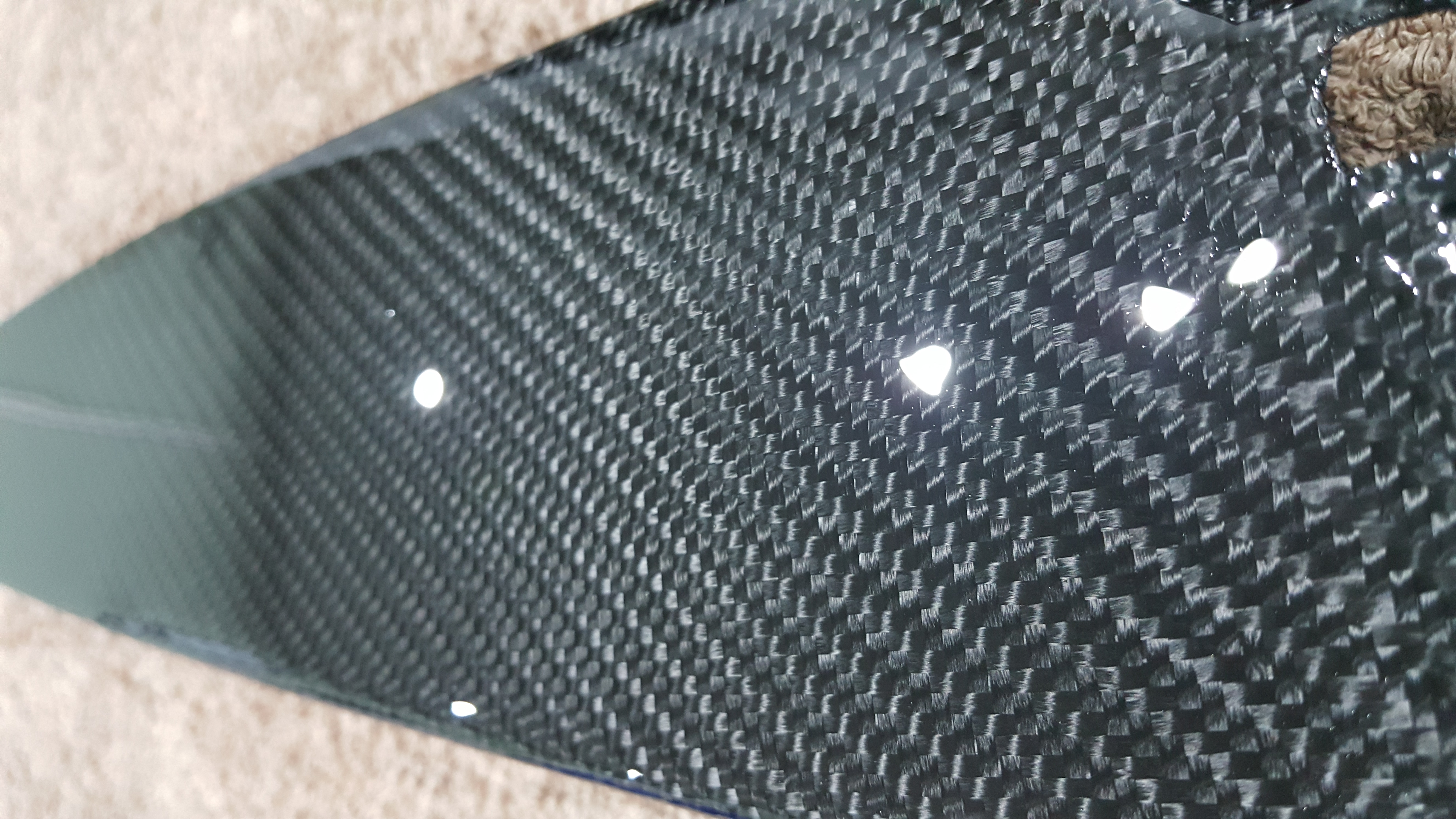

Have been wanting to.domthe pillars for a while now so bougt some soare to mess with and biught the kit from easy composities. Have to say so far it is going well have 1 more coat of resin to apply. Then a sand and polish.. so far inhabe managed to do this.

Juat applied the last of the 3 coats. Need to lwav it over night now. Then sand and another thin coat. Sand and polish should be done for sunday..
Might do the ones on the car while i have a spare pair now

Those have come out really well. More info on the kit plse .

Did the final coat tonight you can see the sanded side and epoxy going on. One more fine sand and polish and done. From the shine without more work i am very happy. I will prob do the spare set i have and sell them.
I will also do the rear smaller triangle trim near the rear windows as i have stuff left over to do..
