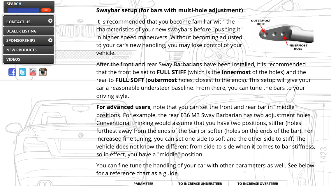

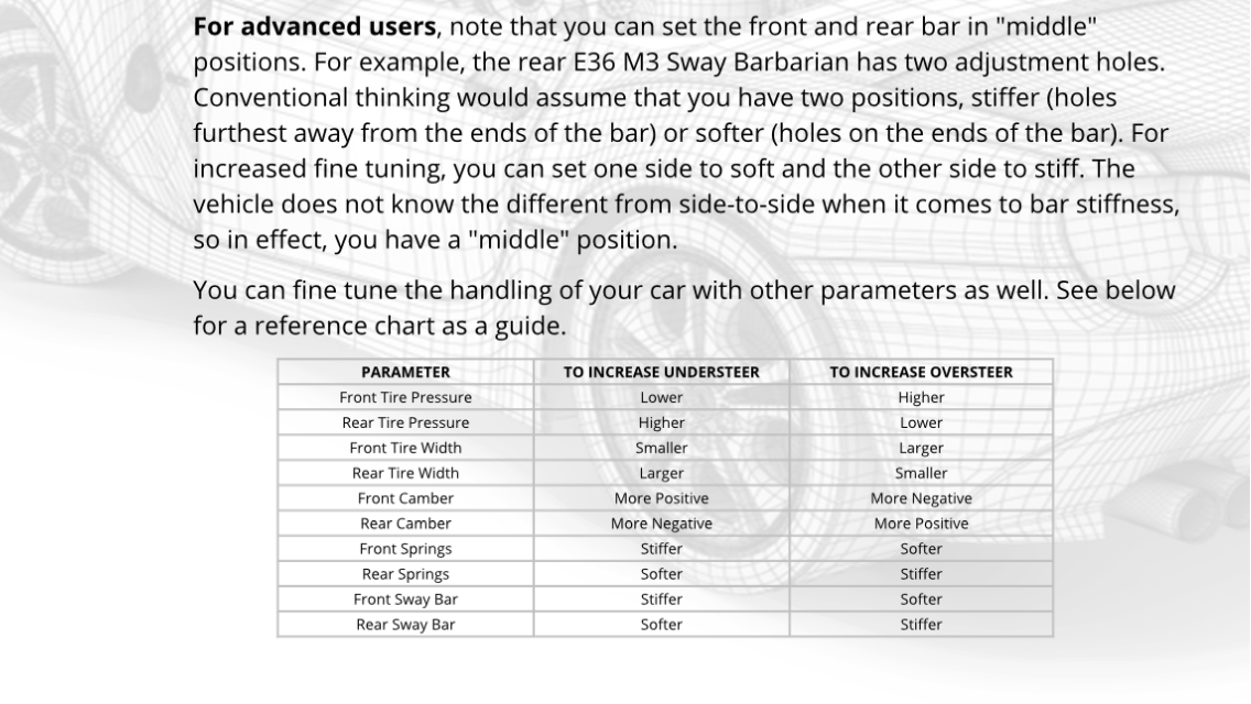

marc1
Posts: 3289
Re: antiroll bai, just rears or both ?
Post by marc1 » Sun Feb 04, 2018 8:24 pm
They are the thicker ones.
I put SS+ springs and rear ARB on my last Avant. It was great. You could just get the adjustable KW springs, which will no doubt be a little stiffer and allow you to drop it where you want it to be.
Re stiffness, just have a look under the car. Outter holes means softer.
KW’s are great, but then so is DRC.
Is that a good thing being the thicker ones?
I’m not really a fan of adjustable springs and coilovers I just want to stick them on and forget about them! Iv read the ss+ springs do make a difference to ride quality and they do sit lower slightly?
Since buying this car it’s just been eating away at me and the final step is charging it Iv been so close even though it’s dead money but it’s jut something that has to be done I think.
Thanks for the diagram mate I will try and get under and have a look in the next few days.
