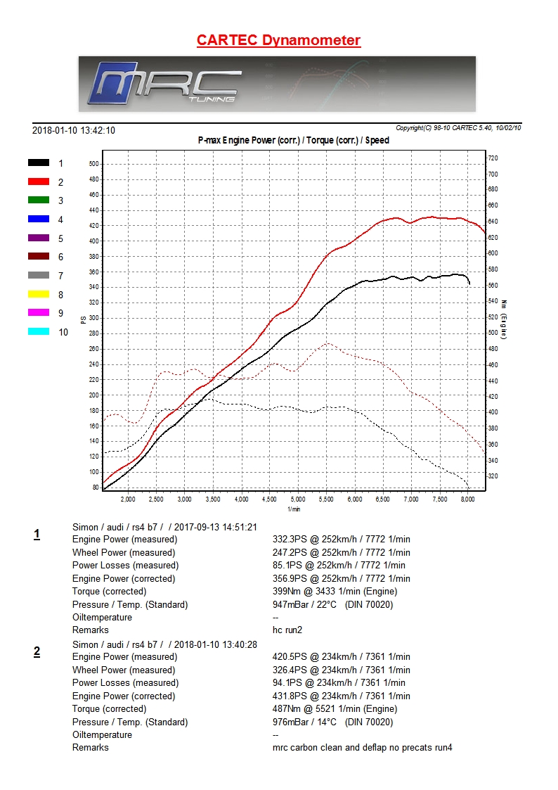

An update - picking my car up from MRC tomorrow.
Looking forward to seeing the results of a carbon clean, manifold de-flap, pre-cut gut and a stage 2 map.

Post by SimonS4MTM » Wed Jan 10, 2018 9:30 pm
Already have the figures

Do you have any figures before the works.?

Post by SimonS4MTM » Wed Jan 10, 2018 9:34 pm
Yes, that is run 1 in the attached graph

It's a bit blurred (old age)but looks to me like a 100 BHP increase,-correct?
You'll defo notice that and as Mike says it's awesome in sport mode.Happy days.

Wow wow wow. That is an immense change. The engine is absolutely bonkers.
No regrets!

Did it have VAC leak?
The pre MRC work run, looks quite low for one of these.

Nothing wrong with it pre MRC work other than carbon build up

I'd say almost certainly it must have had vac leak for those starting numbers. I don't think MRC even report it as it just gets fixed as they put the engine back together. Carbon build up alone won't make it that low.

Agree with Mike and Sam, probably fixed a vac leak..
As Mike says the difference with the MRC map is you can really feel the difference in sport mode.. Took me a while to get used to it. But was well worth it.. Enjoy...

It had a health check back in September and no fault found, but produced 360bhp.
